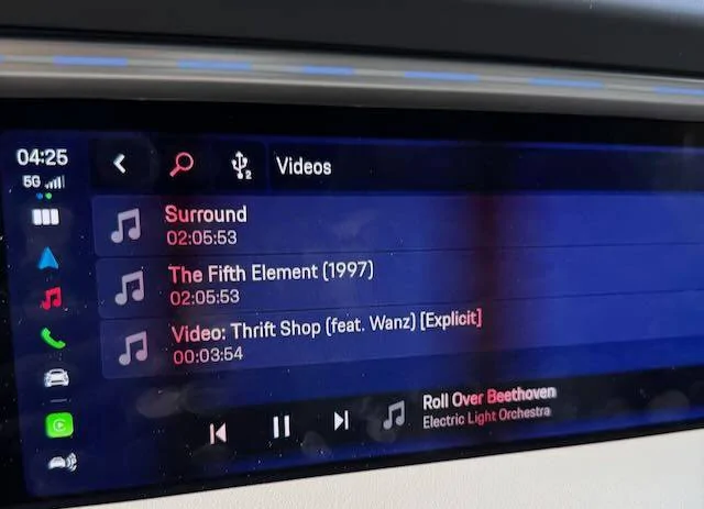

After some digging, my videos have QuickTime metadata tags for the names of the audio tracks in the video file - 'Track 2 Name' and 'Track 3 Name' in my case - and these are 'Stereo' and 'Surround' as output by Handbrake, the tool I use to convert originals to the smaller size.
Changing these is...not as easy as it should be. None of the tools I have can change these in-place. But the creator of one of these tools has a support post about this case, and there is a solution.
You can re-build the MP4 file by copying all the streams - Video and Audio - embedded in them, and then you can set the values of these tags in the new MP4
The tool to do this is called 'ffmpeg' and it's a command line tool, so a pain to setup and use.
However, the results are promising, as can be seen here. But it seems that my initial attempt has caused the actual video title to be used instead of my replacement names for the audio parts. Still more useful though!
Electric Macan EV PCM unable to read mp4 video metadata IMG_6779
One thing though. This video plays great on the central screen. Even at stop lights when stopped. The 'can't play this now' message when moving indicates that you must be in Park to view the video. My data point suggests not. The audio does continue when the video is hidden, which for the movies you've watched a million times turns out to be Ok!
