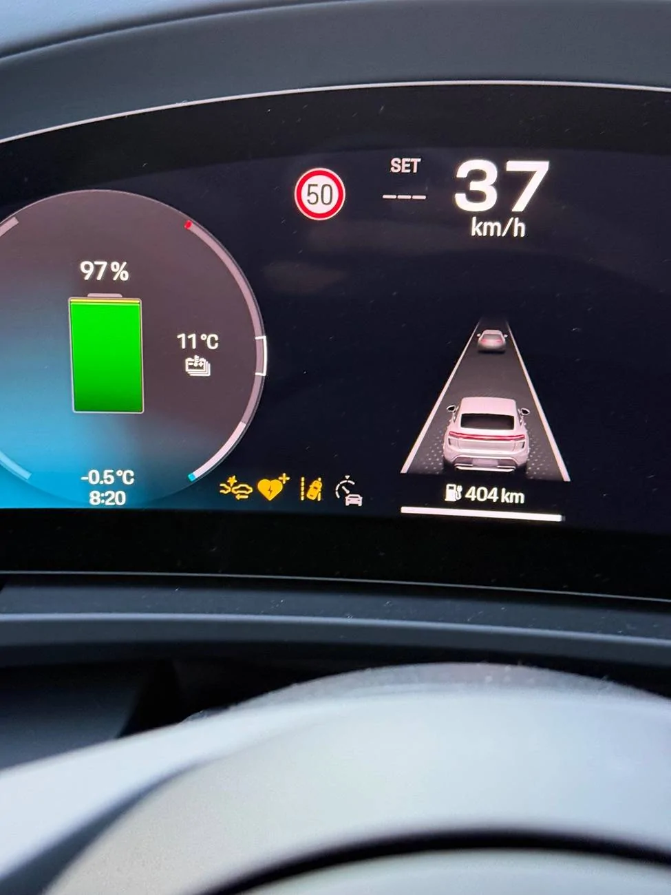

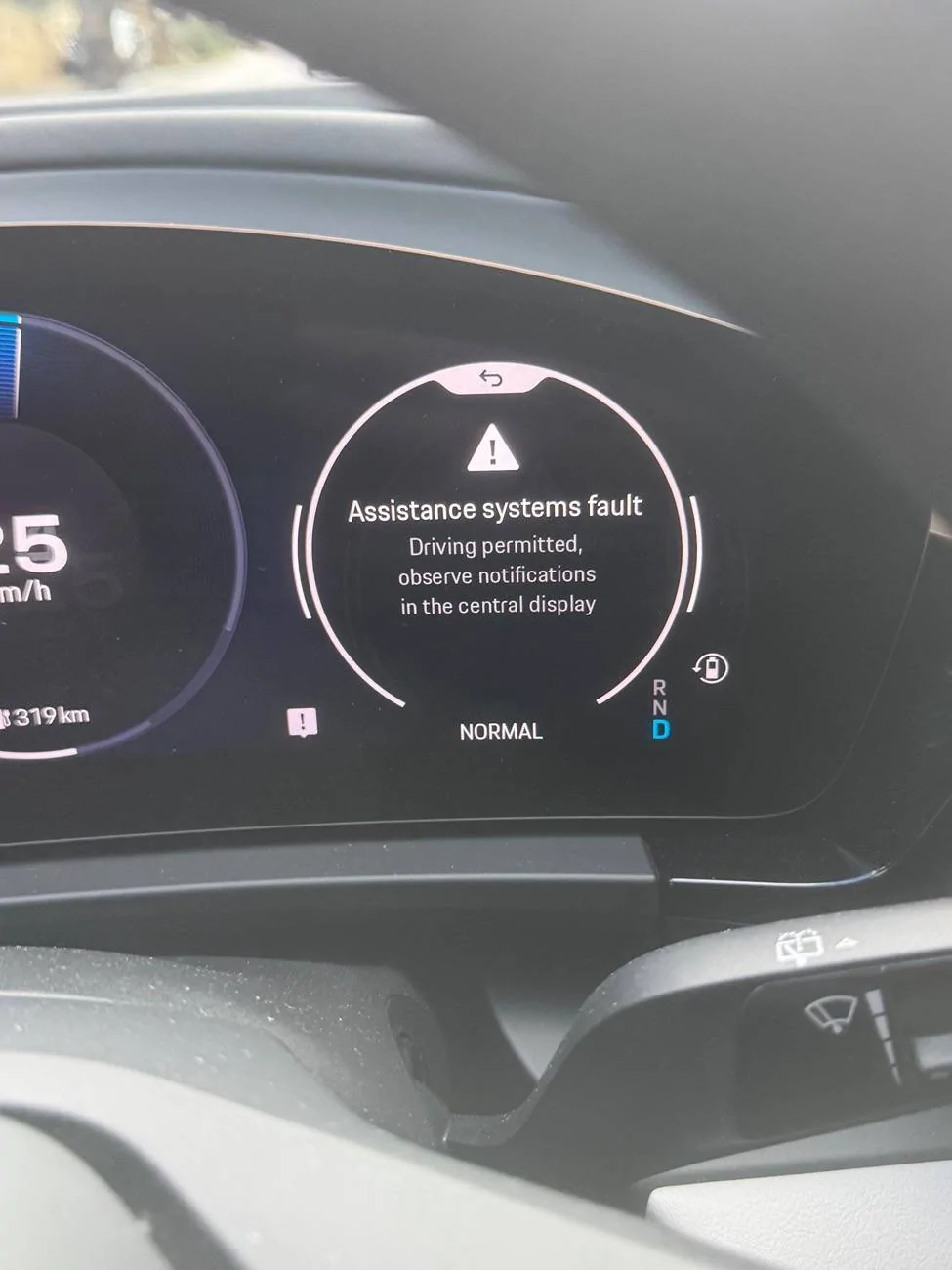

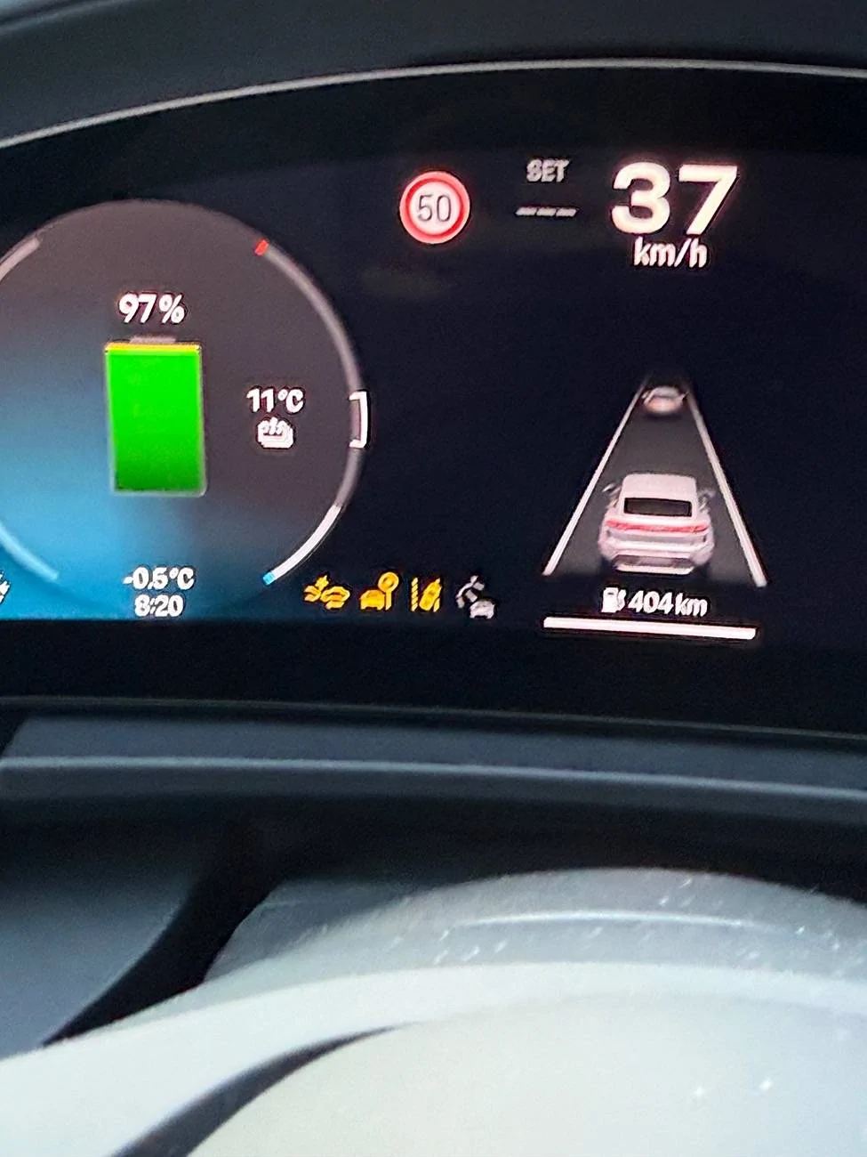

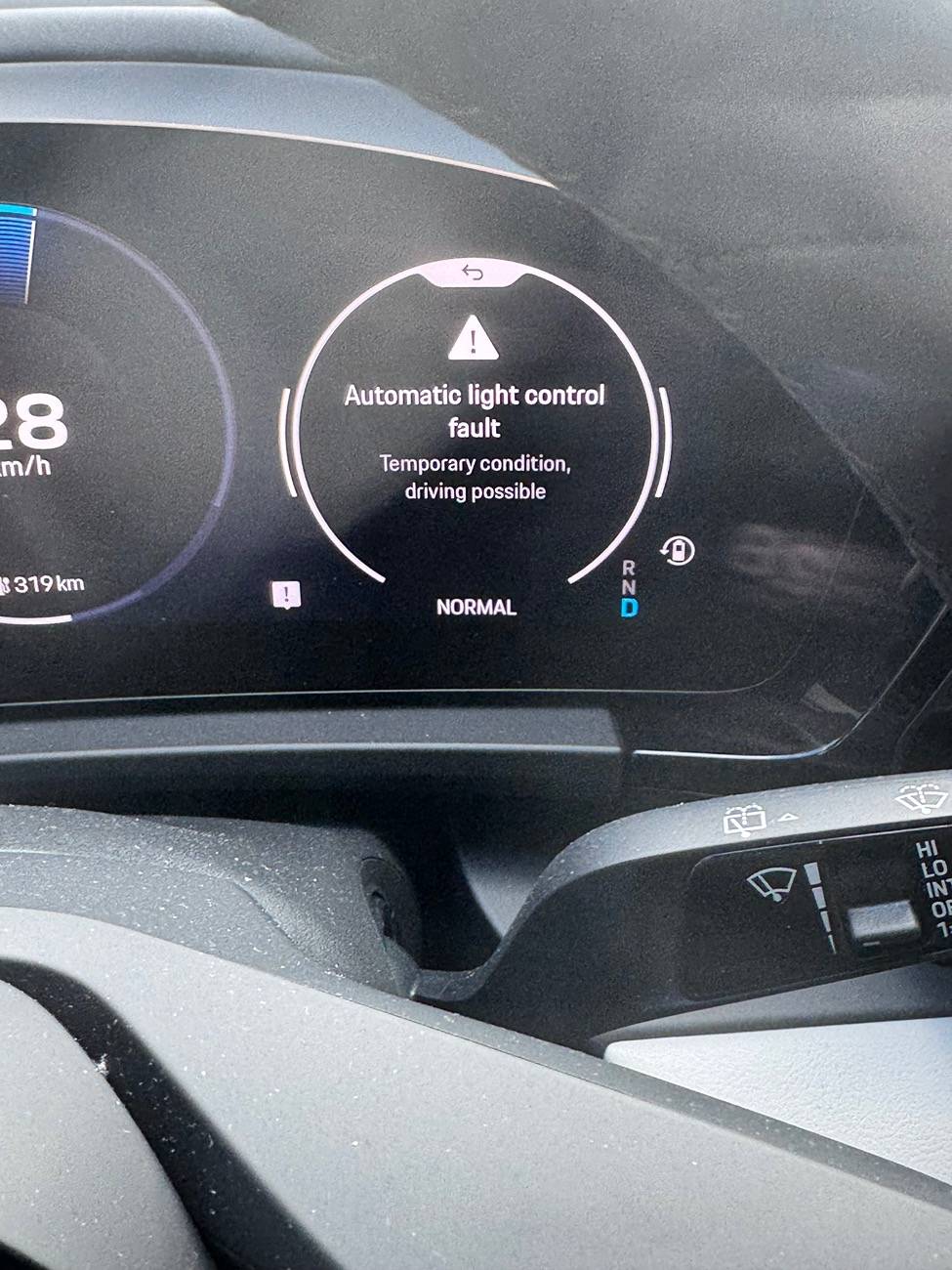

I have received my MACAN 4 in January and enjoying it. However I had a few issues with the PCM giving warning signs at different days. ( they disappear after stopping and locking the car for a while ) I was wondering if Porsche has an updated version to be released .
Attached are some the warnings signs :
Any one has encountered those ?

More software bugginess. Did it clear and not reoccur? Had a few weird ones early, but all have cleared and not repeated. If it persist, would get it into service to have them take a look.

These errors can also appear when there is a lot of moisture and / or dust on the windscreen camera and / or parking sensors and / or radar dome.
All look to be related to the headlights which are controlled by the windscreen camera.

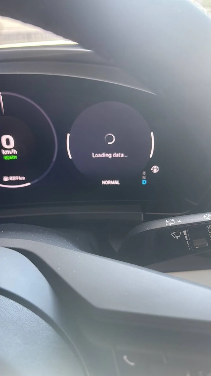

I have similar issues with PCM giving randomly some warnings like losing the speed limit signs or infotainment sticking (no radio/music, navi not working etc) and do not come back after reset (pressing down the central knob). It is only coming back to normal after switching off the car for a while.
I noticed that when connecting the car play, the system crashes after a while.
