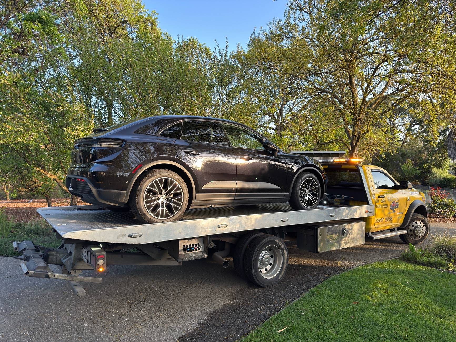

Thank goodness my service department is a good one. Car will go back but it’s not alone as they have several other customers…….y’all can guess the rest.
