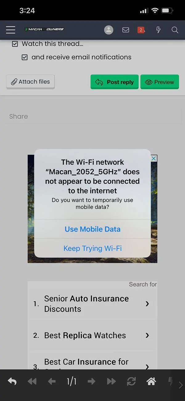

just took a screenshot of what comes up on my iphone:
Electric Macan EV PCM using datapass & not my phone 4/5G network IMG_2153

I would like for this to be true but don’t think it is true for me. I use youtube on my phone for the kids and there seems to be noway to not use the datapass i’ve found.
The wi-fi must be activated on the phone to use CarPlay wireless, but you don't have to be directly connected to the Macan wi-fi to be able to use it. Try to disconnect the wi-fi to the Macan network, and everything will be fine. Actually, you can also use the hotspot function of the iPhone and ask the PCM to use the data of your phone instead the one in the eSIM in the car.

just tried it out, thanks for the tip. was able to connect to carplay but not use car hotspot for data!
It is not necessary to disable “Internet access connected devices”. Simply do not connect the iPhone to the Macan wireless network (I suggest you to "forget" these networks on the iPhone). This way you can still use the Macan hotspot if you wish.
Thank you!!! This totally worked!
