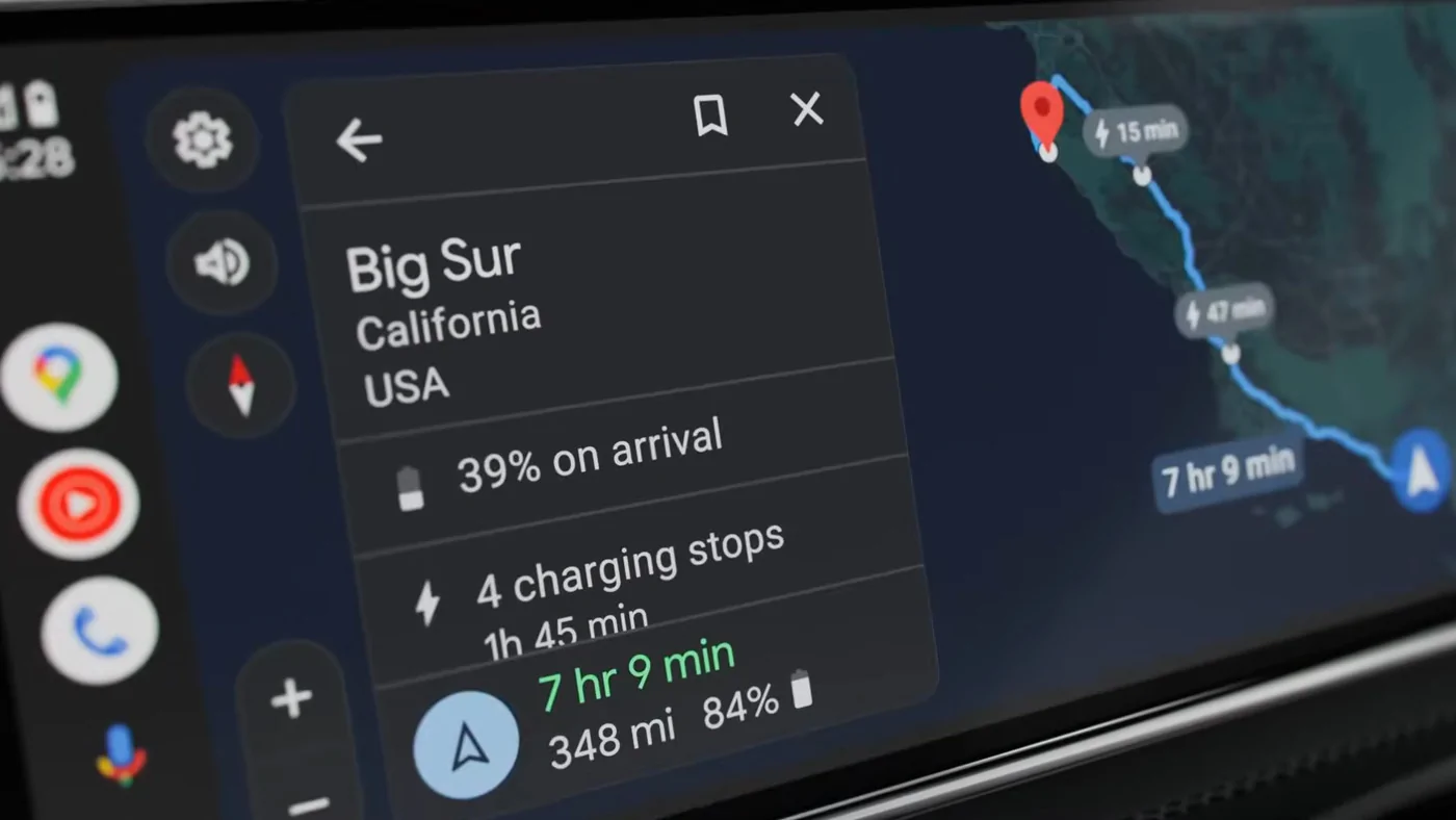

Be nice if there were a better way to do this. I don't even like using the built-in nav (prefer Android Auto), let alone having to pick some random destination beyond my next station just to trick it into preconditioning. Only reason I use it occasionally on road trips is to see what the car thinks the SOC% will be at on arrival. AA has that capability too but only if it the car has newer software. The Macan apparently doesn't have it yet. It's been out for 2 years now but some manufacturers still haven't updated their software. Our Mach-E had it. It was nice. Disappointing that a new EV model like this didn't already come with it.
