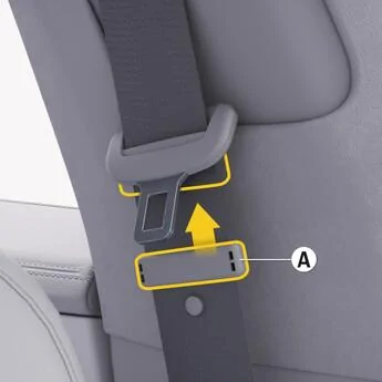

It is addressed in the manual
Securing seat belt for passenger seat
  1. If the passenger seat is unoccupied, the belt tongue can be placed near the belt outlet on the B-pillar trim panel to avoid contact noise with the plastic slider A (Fig. 2).

Easier to do what jh6284 points out above. Per the manual the belt already comes with a slider to stop the noise.
That’s kind of hilarious they have that in the manual.. should not even be an issue, but at least it’s an easy fix. I ordered a few more of those clips for the remaining seatbelts just in case.
