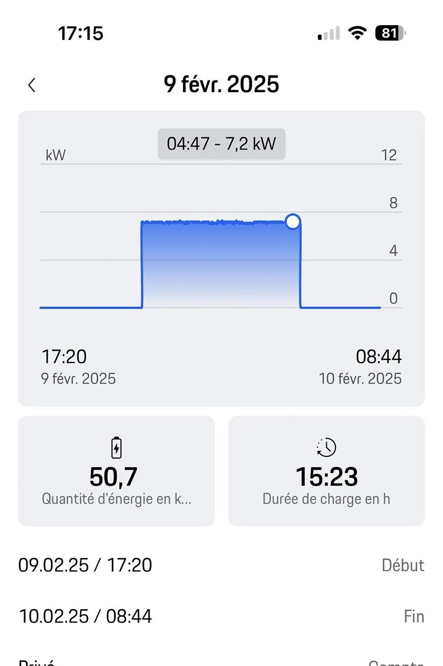

On this screen, departure time is set to 6 am.
At 4:47 the charge is almost finished, with a constant amperage.
17.20 and 8.44 are the connection and disconnection times

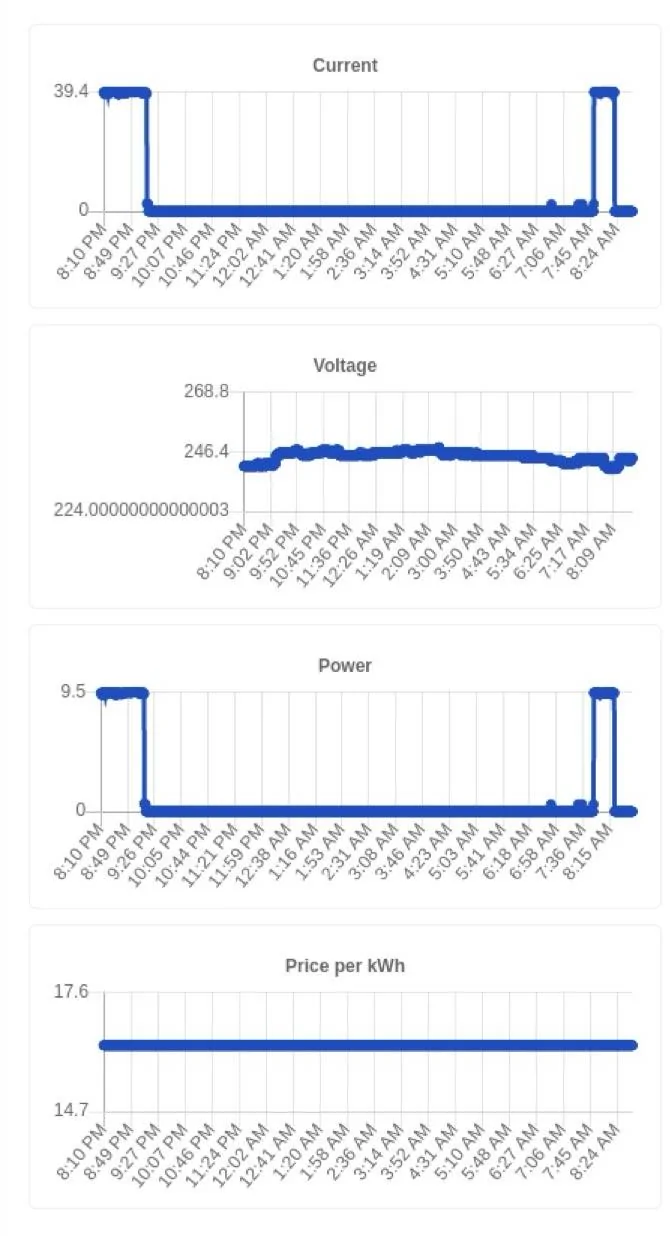

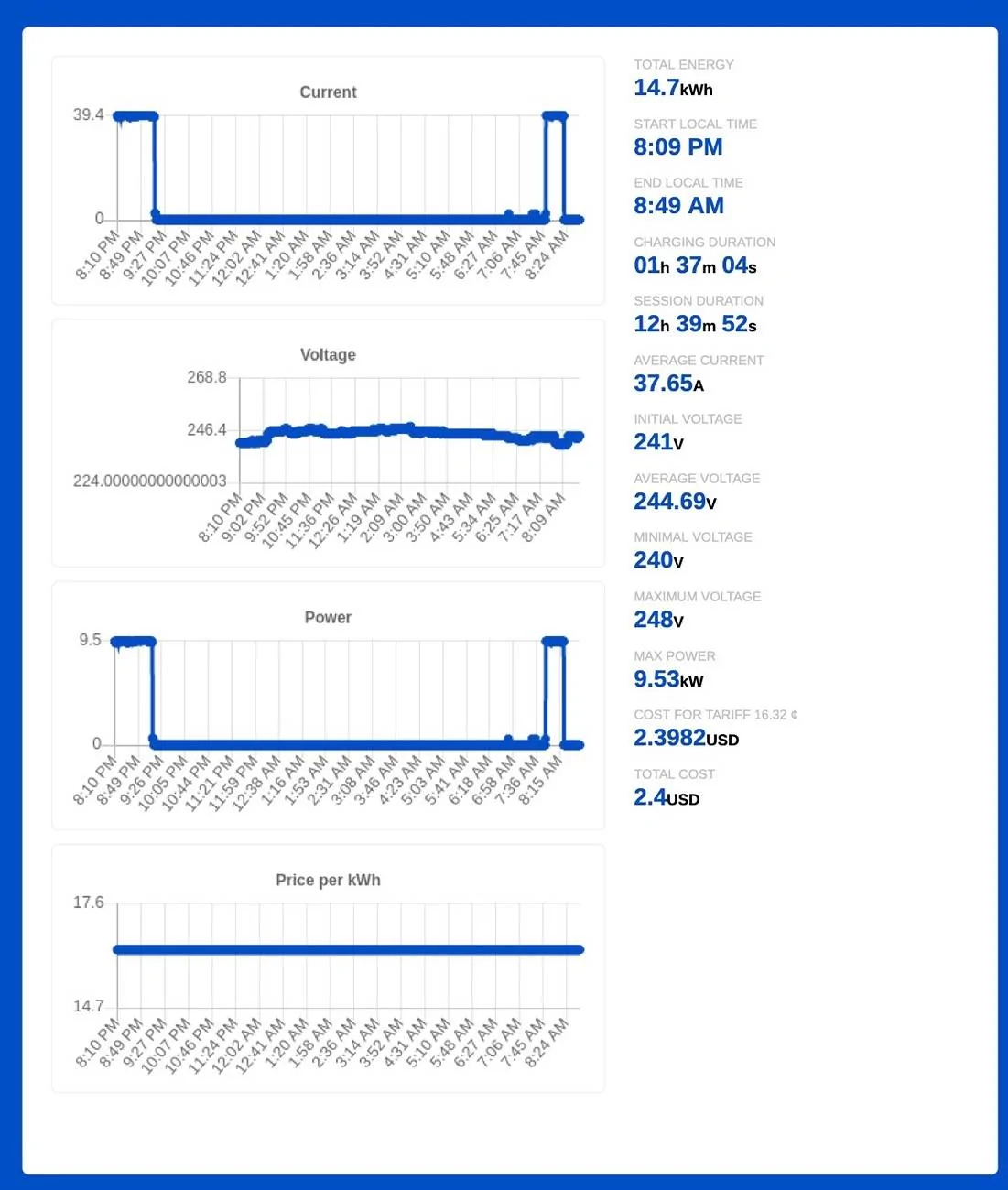

It's hard for me to comment on your situation because I think many variables may be involved. This is what my charging session looked like from the point of view of the EVSE.
Electric Macan EV Scheduled Departure Times ... What does it really do? 1739497335866-gn
Electric Macan EV Scheduled Departure Times ... What does it really do? 1739497198107-5x
