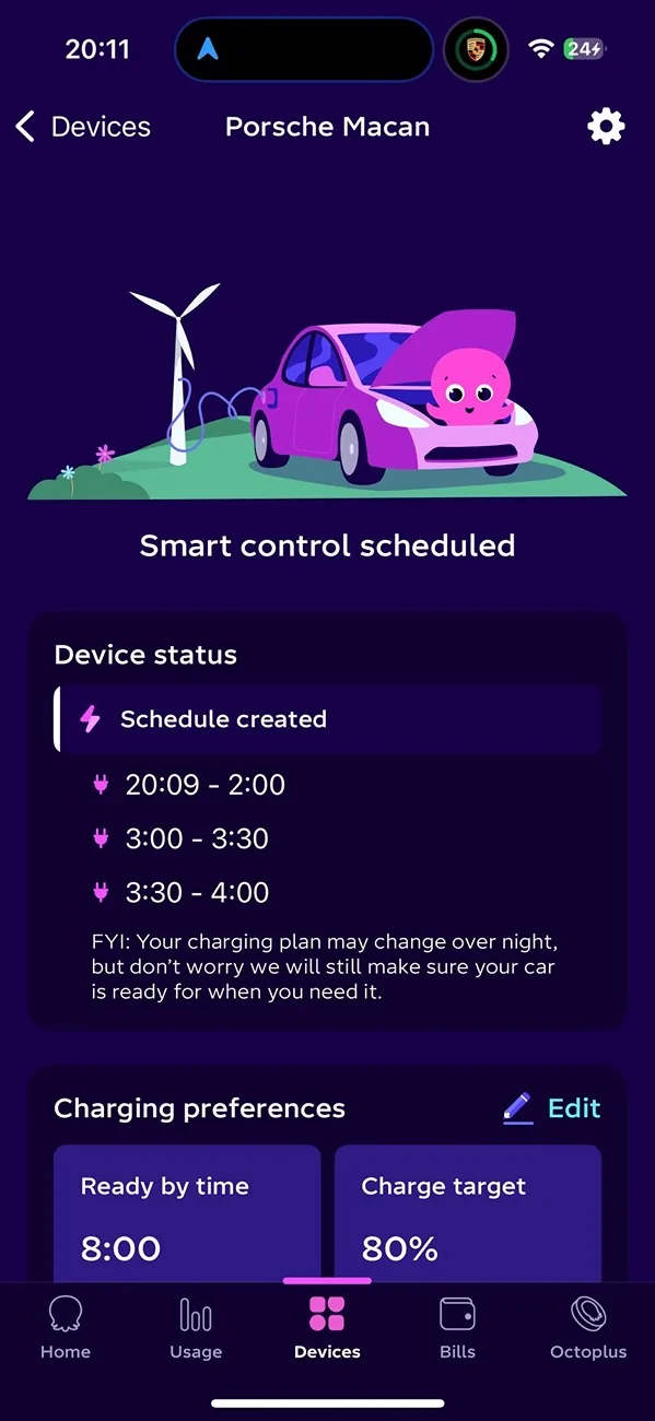

I plug the car in with no departures or schedules set on either the Macan or the Andersen, so IO Go can take full control. It creates a charging plan without any issues (screenshot attached).
The car charges normally until the first pause in the IO Go schedule. As soon as there’s a break, the Macan seems to set its own departure time automatically, even though I haven’t asked it to. Then, when IO Go tries to restart charging for the next slot, the Macan won’t accept it—almost like it’s now following its own new schedule instead.

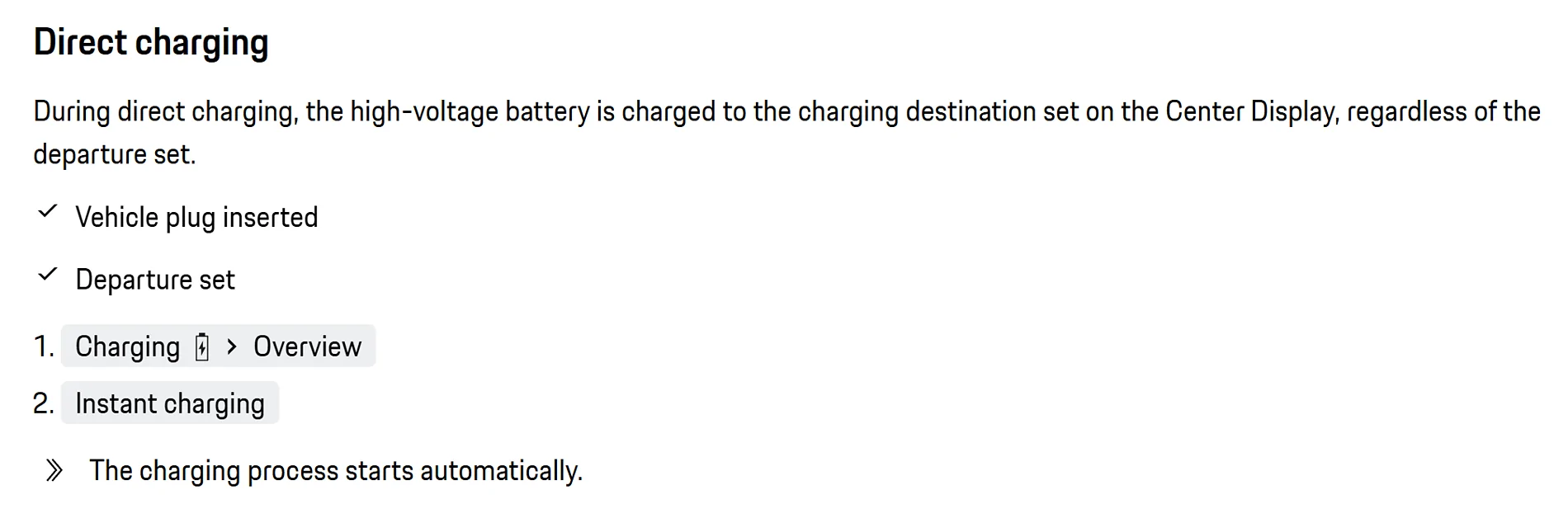

Have you tried Direct Charging?
Direct charging won’t really help with Intelligent Octopus Go, because IOG only works if the car stays completely passive. If I switch the Macan to immediate/direct charging, it just pulls power at the full day rate, which defeats the whole purpose of IOG.
With IOG, the smart schedule gives me energy at roughly 30–40% of the normal cost. So if I bypass it and charge directly, the cost of a full charge jumps massively.
That’s why I’m trying to stop the Macan from creating its own departure after the first pause — I need the car to stay hands-off so IOG can actually deliver the cheaper energy.
