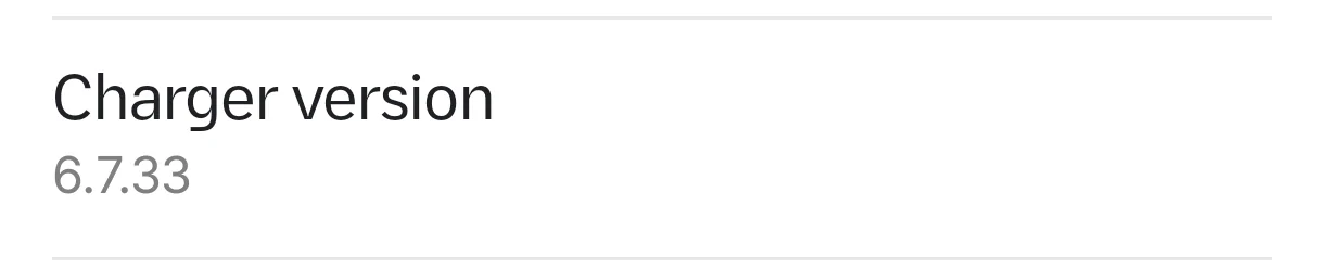

They botched a software update a few months back (aimed at improving car comm stability). Kept denying it and tried to convince me my cars were the issue, then that my charger is old and I need to buy a new one (at a discount)...finally admitted their fault and subsequently fixed it with the attached version.
Restore, or factory reset (temporary fix) is slow and tricky. Make sure to reboot the station afterwards just in case and make sure it is *not* auto updating afterwards. Stay that way until the can push out the version attached to you for update. Reboot after the update.
