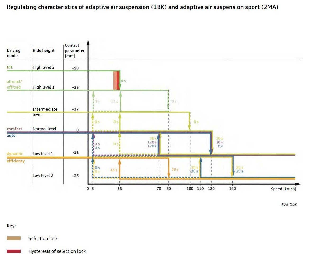

Generally when my car lowers at speed, it won’t raise again until I slow significantly, and usually that’s when I come to a stop. The thresholds for when it lowers seem to be different from when it raises (just like the spoiler diagram). All of my cars with air suspension have done this (iX, etron, EX90), you come off the freeway or stop at a light on a highway and you feel it lift.
370
417
Someone shared this on an etron forum. It’s a bit complicated but you can see how the etron will lower after a certain amount of time at a specific speed threshold, and then raise again at a lower threshold, but only if it remains below the threshold for a specific amount of time.
so for example in comfort drive mode it will lower if it is above 120kph for 30s, but it won’t raise unless it drops below 70kph for more than 120s, or below 5kph it immediately raises. That probably accounts for the delay we see in raising when coming off the freeway or at a stop light.
in short, yes the car does some automatic raising and lowering, and it is complicated so don’t worry too much about it :)
https://www.e-tronforum.com/attachm...mat=pjgp&height=1920&optimize=high&width=1920
This is awesome! I love data.
But it doesn't explain how when My car is off for several hours (12-24+), in my perfectly flat garage parked in normal mode with the suspension set to the lowest possible setting that *sometimes* (not often) when I get in it adjusts it's height randomly - sometimes it ends up back at "low" before I back out and others I'm in a hurry and it's still moving.
