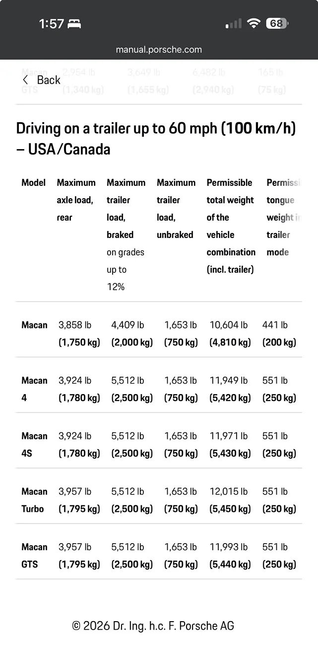

FYI The Towing Capacity for all 2026 AWD variants was increased to about 5500lbs. Excerpt from the manual:
I thought I had read that this was true for earlier model years as well, but I’m not able to find that reference so don’t quote me.
I was not aware that there are any physical changes on the 2026 vehicles hence my belief that the capacity change was just a certification.

I also specd the hitch option for a Kuat rack and two mountain bikes but had assumed it would not be an issue. Thanks for the information.
437
455
The previous trailer hitch limits in the USA for 2024 and 2025 models are 2000kg and 200kg tongue weight. 4400lbs and 440lbs.
I’d love to know from Porsche if it’s possible to upgrade a 2025 to the 2026 specs. I’ll ask next time I’m in the dealer

I believe Porsche had indicated they were going to provide the towing upgrade for 2025 models to the 2026 model capacity. I was curious what revisions are made to increase the capacity.
If anyone has more info on the retrofit for the increased weight please post details.
