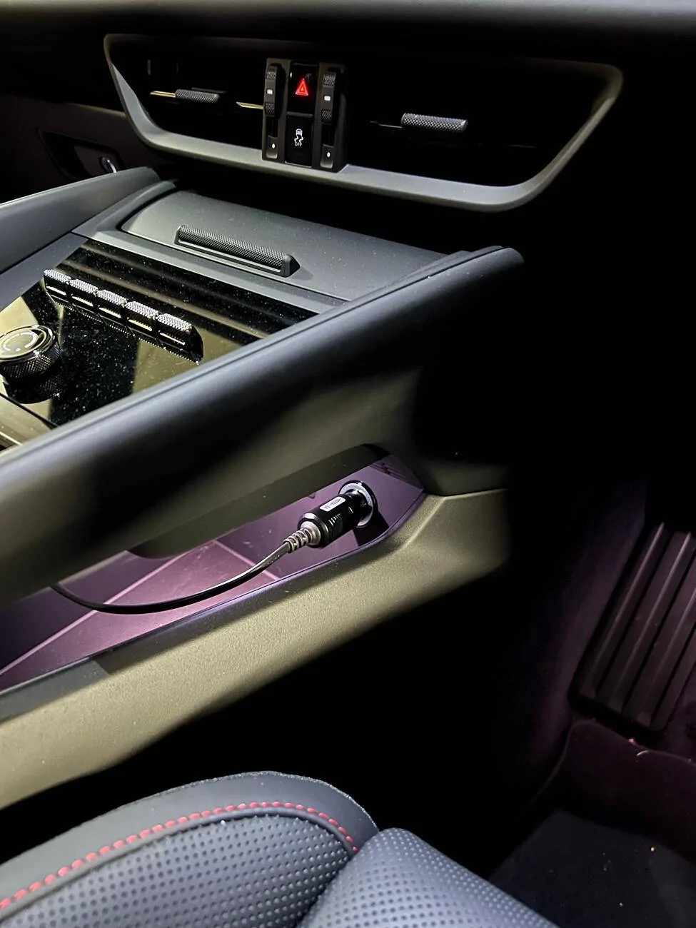

It's always been possible since launch on the Taycan - just need to ensure you have the correct type of trickle (LiPo) charger.
Yes I have now used a Porsche Trickle Charger (set on Li-Ion) and plugged into the cigarette lighter socket at the very front of the centre console storage bin of my Macan. The charger lights lit up as usual so I assume it is supporting the 12V battery. Does anyone know how I could actually confirm that the 12V battery is being charged?

The trickle charger itself has lights that should tell you if it’s charging and what state it’s in. Need to be sure it’s set to LiOn charging

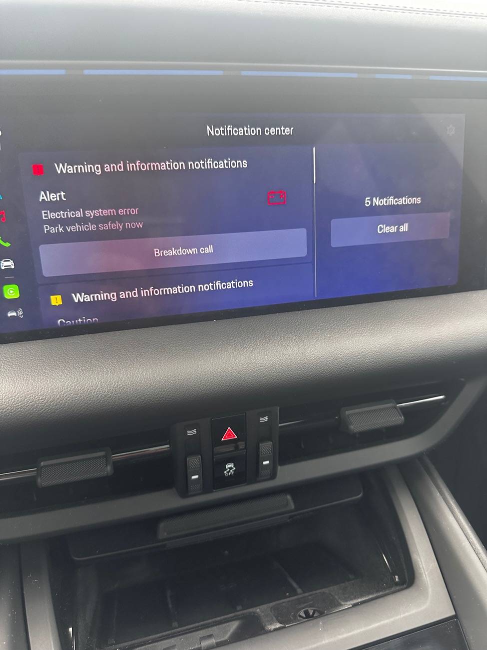

That is what ended happening… needed a screwdriver to unlatch the frunk. I drove for 30 minutes to do some errands and the car was DOA again! Roadside came to my location quickly went through the process again. Halfway home got this message. Limped home…. Turned the car on and off and the message went away. Love these software / engineering gremlins!
