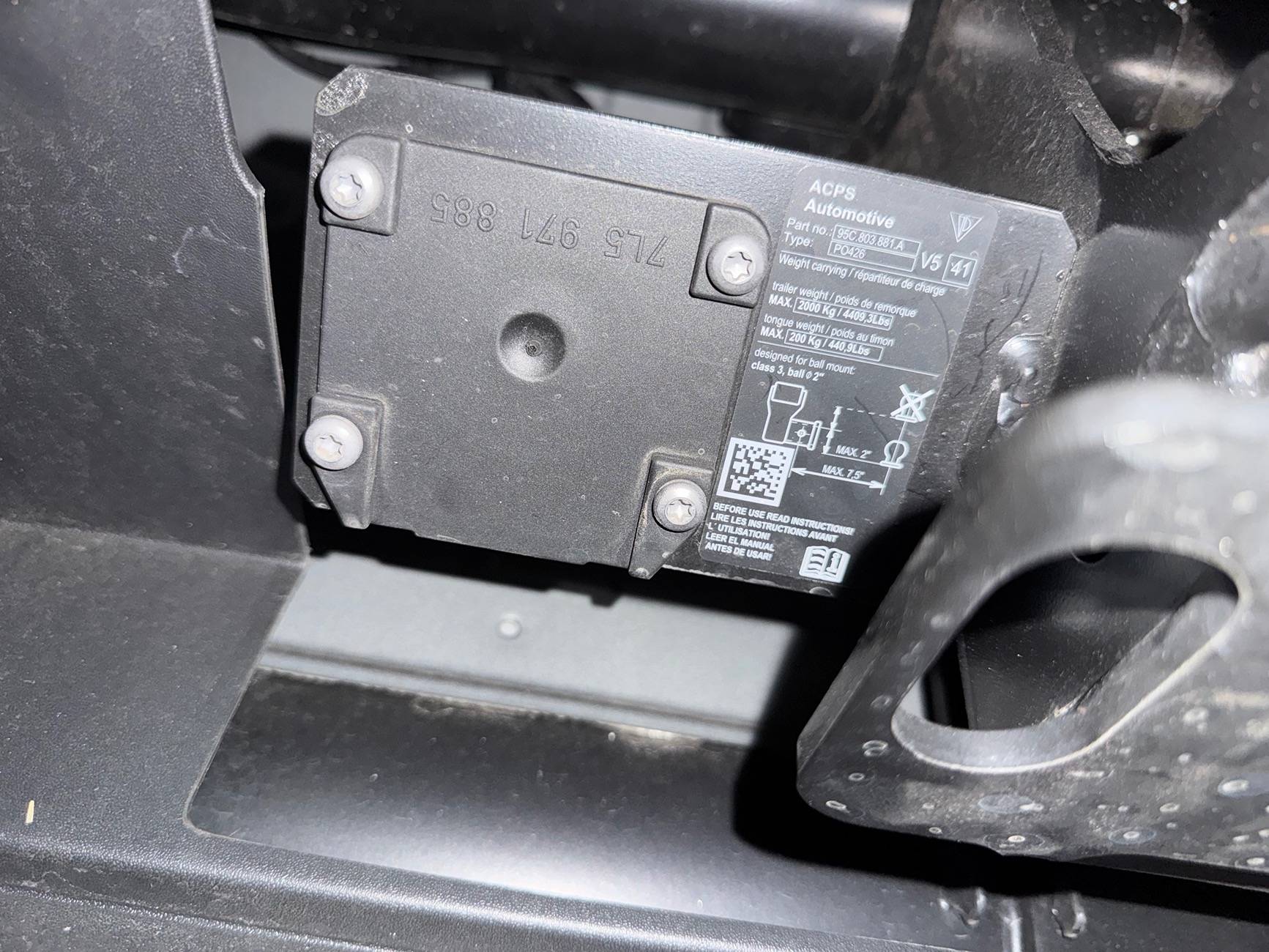

Does the U.S. tow hitch option include a standard 4-pin trailer light connector and wiring harness under the square plate with the 4 torque screws next to the 2” hitch (see attached photo)?
If so, any recommendations on an easily removable connector cover that would fit the Macan EV? I’m not sure if the one in the link below would be appropriate or if there is some type of flip cover available.

I was curious, also, so I removed the cover and found it loosely connected and covering to what appeared to be the plug. If the plug can be separate from the cover, then the plug would be loose and not attached. I'd like to know the answer, also, though my use of the hitch if mainly for bikes, but may use a hitch extender for kayaks and a sailboat which get carried inside a similar sized Volvo XC40.

I just took a look under my car to get an idea of what's needed to install the Pollak I just ordered from Amazon. It seems my dealer has already done this before delivery!
That's $20 with tax saved, and also having to find the correct bit to unscrew the plate.

Yeah mine has an Pollak adapter installed too. I wonder if some dealers are forgetting to install the kit, or the factory missed a step.. Or its just some dealers doing us a favor.
