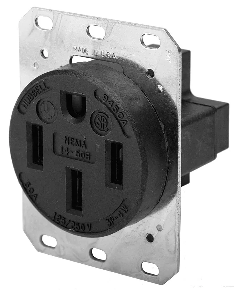

for reference the Hubble NEMA 14-50 outlet…demand the best - accept no alternatives from your electrician.
links below are provide as reference _ONLY_ and give you a place to start and see first hand what this product looks like - I'm not recommend where/how you purchase these units and most people just make sure your electrician installs this unit and it doesn't matter where your electrician gets it from - but again the link below is just for your personal reference and proof of existence.

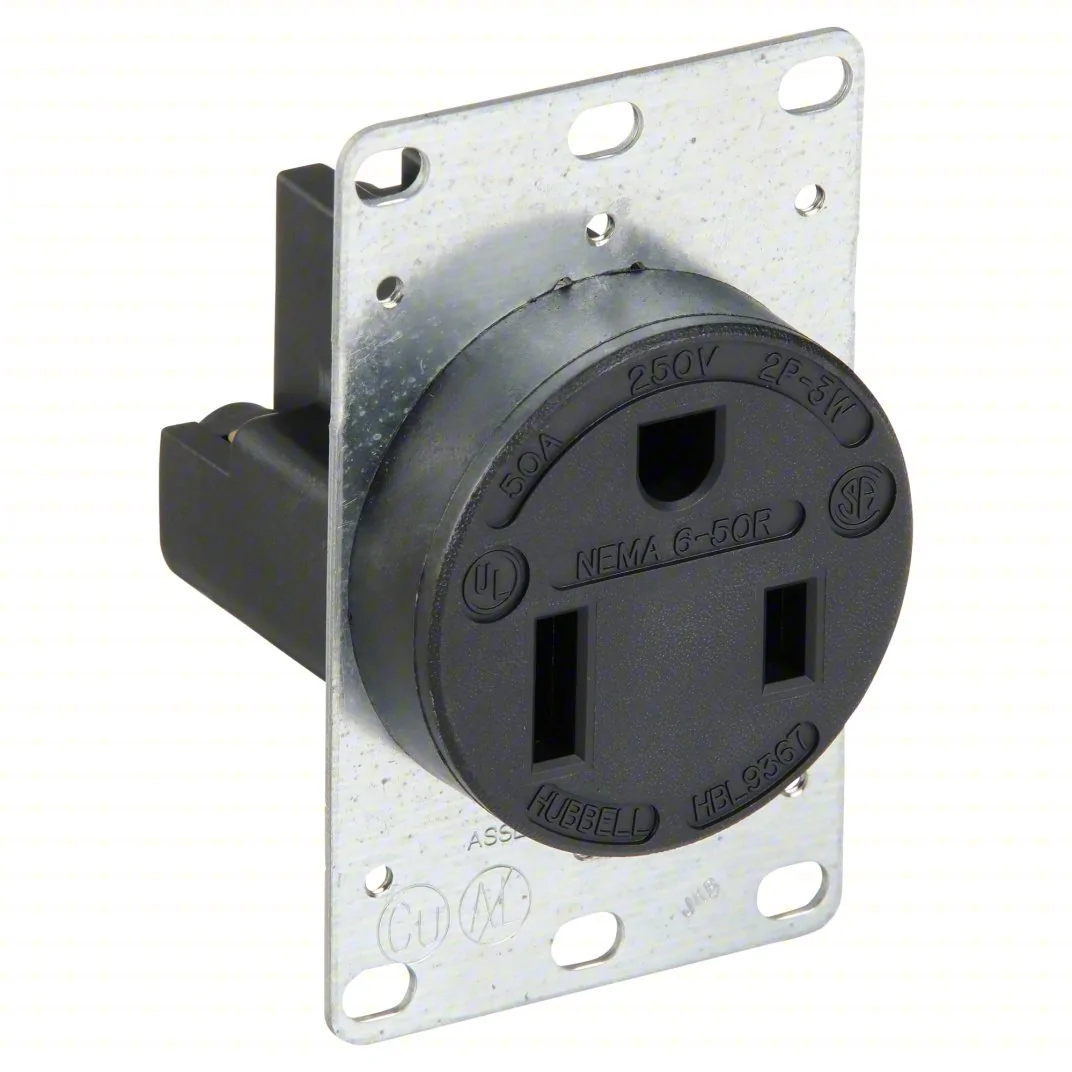

for reference the Hubble NEMA 6-50 outlet…demand the best - accept no alternatives from your electrician.

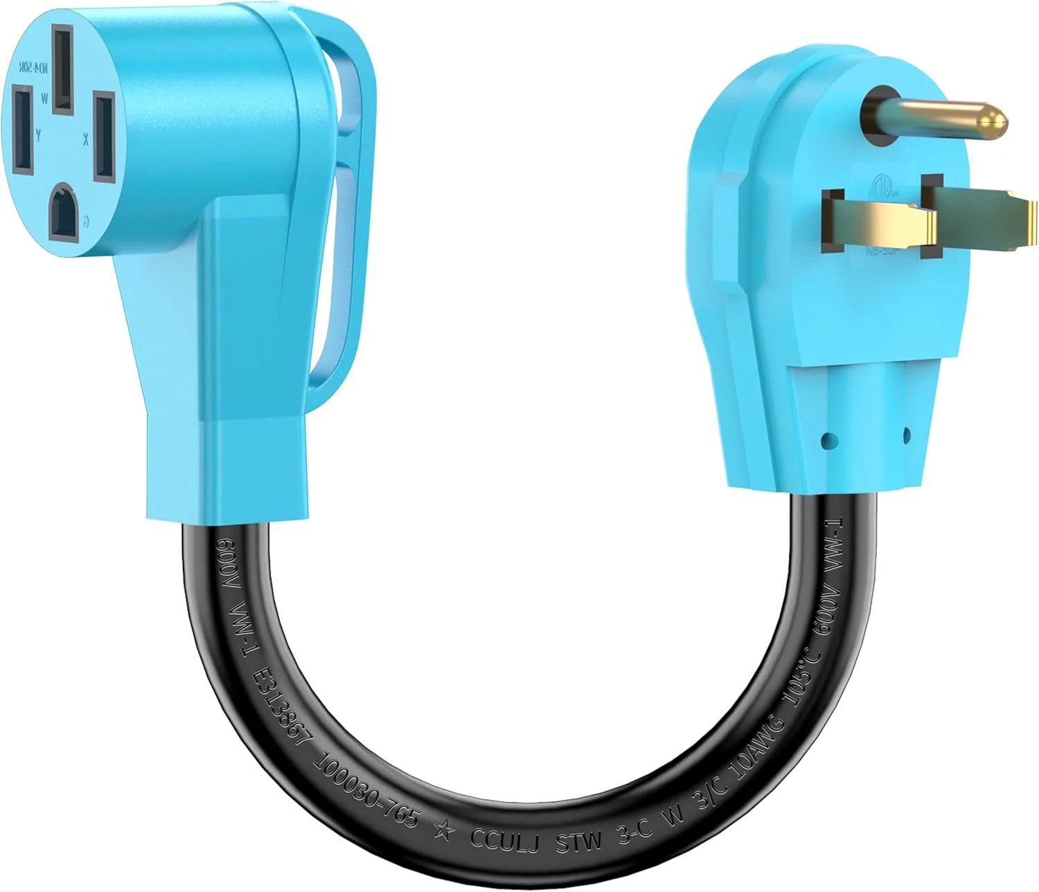

here is a cable that will easily and safely allow your NEMA 6-50 PMC+/PMCC to plug into a NEMA 14-50 outlet away from home…$25.99
note the $26 price vs. the $285 price for the Porsche cable that does the same thing.
this is just one example of such an adapter - there are many many choices once you go down this path
I'm posting this to demonstrate how choosing one NEMA socket or the other really does not lock one into any particular type of socket when traveling away from home with a mobile EVSE.

get the hubble - the NEMA sockets are not in fact all the same - and if you hold a hubble and others in your hand you can feel the difference - I had a small regurgitation when I read what your electrician told you about "all the sockets" - ummm no.
for one the hubble face plates are ceramic - that means they won't/can't melt like _ALL_ the plastic ones - passing the same standards does not mean they are manufactured the same…

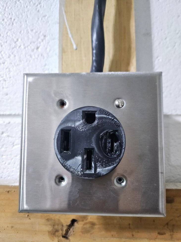

below is a picture of "lesser" NEMA socket from a taycan user after a year or so of charging…not a hubble socket - this is just one example of many…Tesla, Porsche, Audi, Rivian, Lucid, Polestar and other EV guys all call out hubble sockets by name for their EVSE installs in North America…

Porsche lists the Hubble parts numbers they recommend/require in their technical document - trust them not me :p
https://static.nhtsa.gov/odi/tsbs/2022/MC-10222530-0001.pdf
Porsche recommends home owners only install industrial quality electrical NEMA receptacles and have the installation performed by qualified electricians in accordance with the National Electrical Code or applicable local equivalents.
For example, the following receptacles are recommended for their industrial quality and ability to handle high current with minimal electrical resistance for long periods of time:
Hubbell HBL9450A = NEMA 14-50 Receptacle (4-wire)
• Hubbell HBL9367 = NEMA 6-50 Receptacle (3-wire)
A 50-amp branch circuit should use minimum 6 AWG, 90°C-rated copper wire for conductors supplying level 2 Porsche charging hardware plugged with a NEMA 14-50 or 6-50 supply cable. Receptacle terminal screws must be tightened to manufacturer specifications. The use of ferrules on the supply conductor wiring is recommended to further safeguard the circuit connection at the receptacle.

Indeed. I would not have noticed the discoloration on the Levition because I rarely disconnect it until we got into the discussion and it was pointed out. It is a bit concerning so I am changing both of them.
