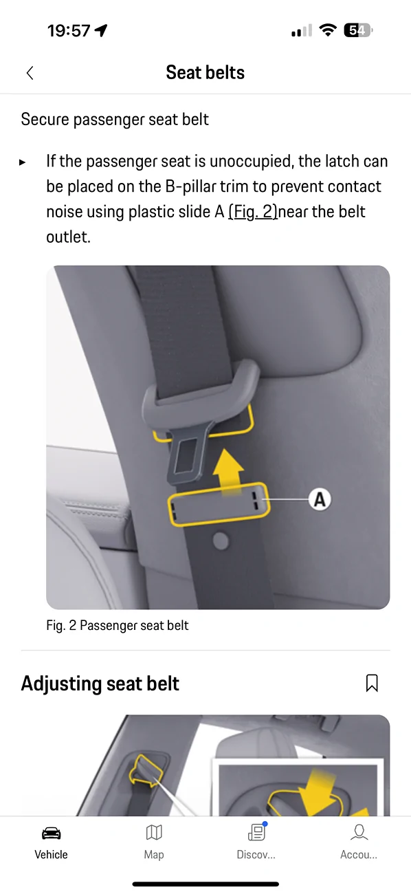

Hi all!
I am hoping to receive my 4s (and first Porsche) in about 3 months. I read about the seatbelt rattle. Is this fixed in recently delivered Porsches or do i need to buy a part from Porsche or Ali? If so, the old link is not working anymore. what is the name of the article?
Regards,
JD
Orange
Apr 18, 2025
Malaysia
Macan 4, Mini Clubman
Congrats on getting your first Porsche!
I guess it depends on what you find convenient. After I drop my wife off at work, I will find that the tongue may rattle. I simply push the slide up and it’s solved. It helps that I am tall: I just raise my arm and don’t need to lean over.
The user manual mentions it. (This slide comes with the car and does not need to be purchased)
