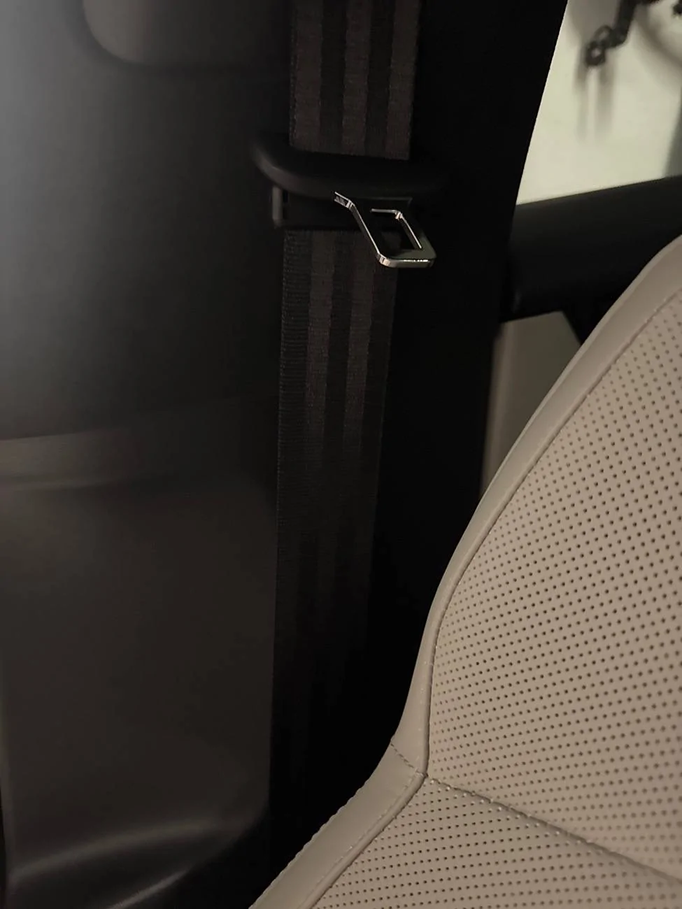

No I was saying that the seatbelt noise is the only noise I found in the car since I picked up ;)
I ordered exactly the one in the link you posted.
Mine sits at Alcatara so no noise…
About road noise it is a bit louder than my Taycan that had insulated glasses but no complaints, if fact it is a verybquiet ride unless when on concrete highways

I suppose I could move the buckle up to where the alcantara is…will try that. It came with the little holder-bar set about 10cm below the transition to plastic.

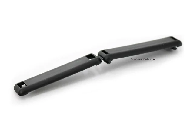

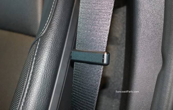

I am very familiar with this very useful clip, I have one on most of my cars. All of my BMW's have or have had this in some form or design, usually for both the driver and the passenger. Some implementations are adjustable, some are at a fixed point. All are designed to keep the seatbelt at a minimum height for each access when reaching back. They also help to keep the seatbelt in a position that can prevent rattling against the B pilar while diving and not in use.
I searched Porsche parts and accessories to file the clip. You can buy another and use it on the driver's side if you want. I am surprised - is it possibly missing? I have not yet taken delivery of my Macan to confirm - it is scheduled for the coming week.
If anyone else that has already taken delivery of their Macan can confirm - is this only included for the passenger side? If so, I may order one myself for the driver.
Porsche part on Suncoast: SKU: SKU99BELTCLIP
Website: https://www.suncoastparts.com/product/SKU99BELTCLIP.html
Cost: $9.00
Electric Macan EV 1st drive home in Macan EV - Comments and Issues (by former Taycan owner -- trade-in) Porsche seat belt clip1
Electric Macan EV 1st drive home in Macan EV - Comments and Issues (by former Taycan owner -- trade-in) Porsche seat belt clip2

I confirm you that (after checking 8 Macan EV) the clip is only on passenger seatbelt. Thanks for the precious information. Now I have to find where to buy it on this side of the pound…

Yes, mine only has on passenger side.

I moved the passenger belt buckle up to where the alcantara starts and that took care of the noise. Easy, but we'll see how it works when people start sitting there and move the buckle.

Thanks for sharing the part number @KAMichael
I'll have to get one for the driver side! The B pillar is indented to give you space to reach the buckle, mine is well below the indentation of the B pillar. Kind of annoyed with this quality control.
