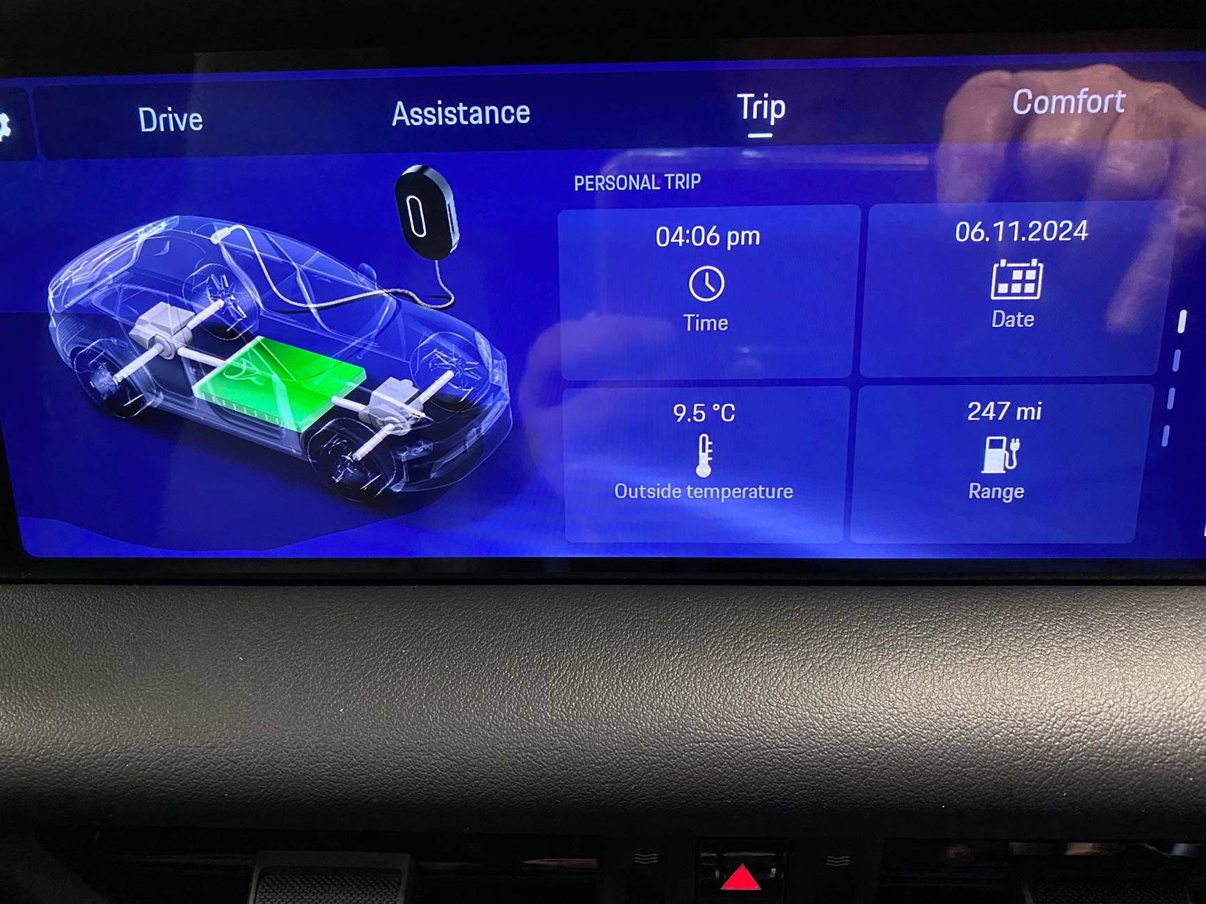

Do you have a trip computer photo from a trip of more than 30 miles/50km of continuous driving?

I would recommend 100 km… if you start with a cold battery (ie with no preconditioning)
The guess o meter is about as good at estimating range as I am at the stock market.
I don’t but I‘ll take one and post it up.
hmmm that's not great
No it’s not and I can’t understand why, when it has a quoted range of 415 miles does it never charge to anything close to that. It’s going back to Porsche for analysis this week to see if there’s a problem.

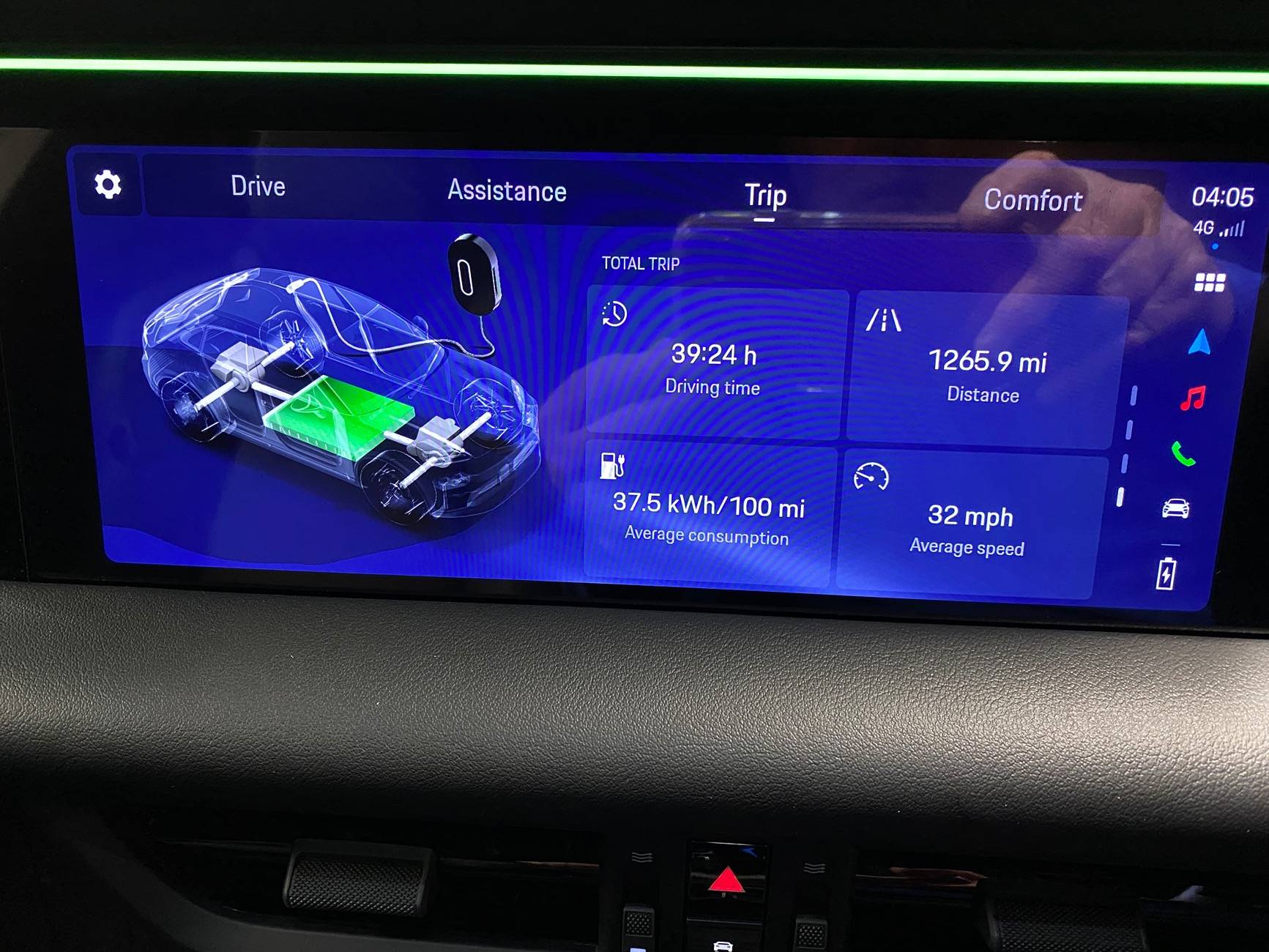

You're certainly never going to get 410 miles of range. But post your overall trip computer, specifically with consumption/efficiency numbers, and we'll take a look.
491
702
@soundman those numbers look fine to me. The overall efficiency will show somewhat high, especially in cold weather, due to starting/stopping/heating the car.
37.5 for October/November really isn't too bad overall.
I'm sorry if you anticipated more mileage but 300-320 highway in the summer with ideal conditions is the realistic range.
I didn’t anticipate anything it’s what Porsche stated when we were buying the car. They supplied figures of 415 miles range and told us that should give an average of 350 miles depending on driving speeds and temperatures
As you appear to know what you’re talking about can you explain why the car never charges to more than 280 miles?
576
740
It’s not the way the car charges.
it’s just related to efficiency (miles per kWh, or kWh per mile) and usable kWh in the battery.
With 95 kWh, 415 miles range equals 4,36 miles / kWh
only small / light / not so powerful / with one motor cars can achieve that (in normal conditions), and the Macan is not that at all.
It can’t achieve that efficiency in normal driving conditions.
They told you what you wanted to hear…
