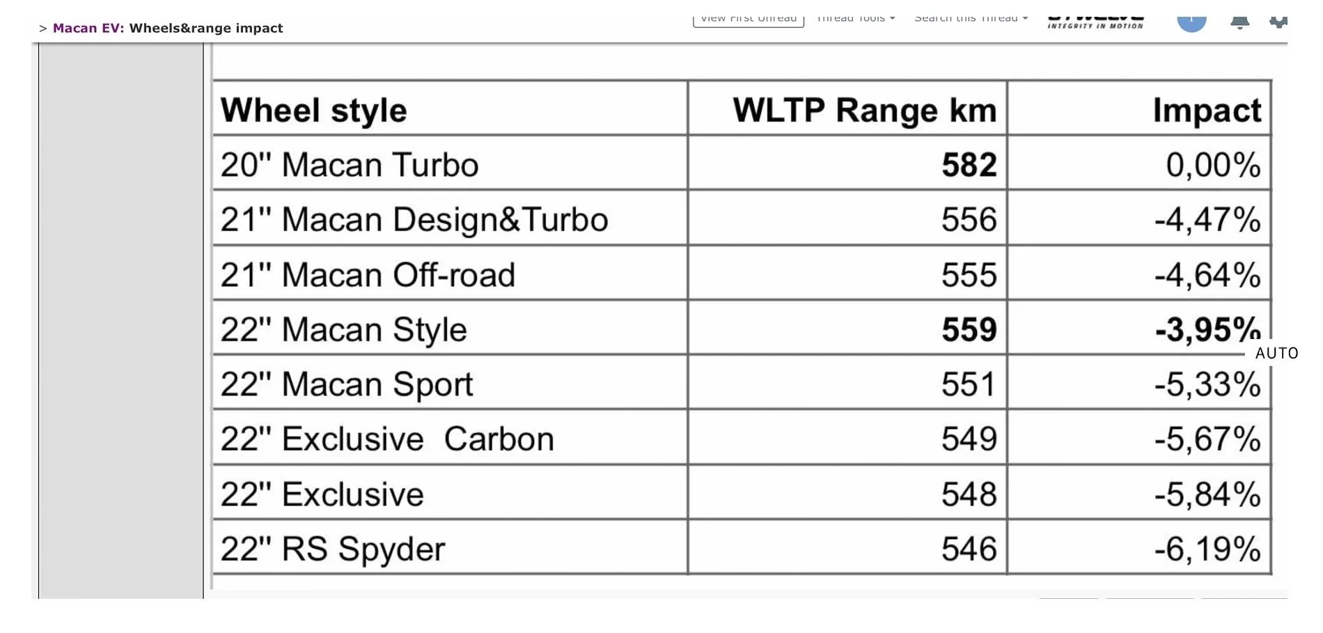

Not seeing 10-15% range reduction with 22’s, and of course the reduction is the same percentage for either WLTP or EPA.
Not necessarily. The tests regimes are different, and that will impact the results.
Heavier wheels have more inertia and are more impacted by city driving (stop and go), while the rolling resistance for the same tire circumference tends to be less for a tire with a shorter sidewall, making the larger wheel more efficient. But the larger wheels also tend to be wider, so you get more aerodynamic drag, which of course gets disproportionately larger at speed.
89
961
1,110
6.2% max reduction tested; even if different testing gives somewhat different results, ddoes not result in 10-15% reductions for 22”’s.

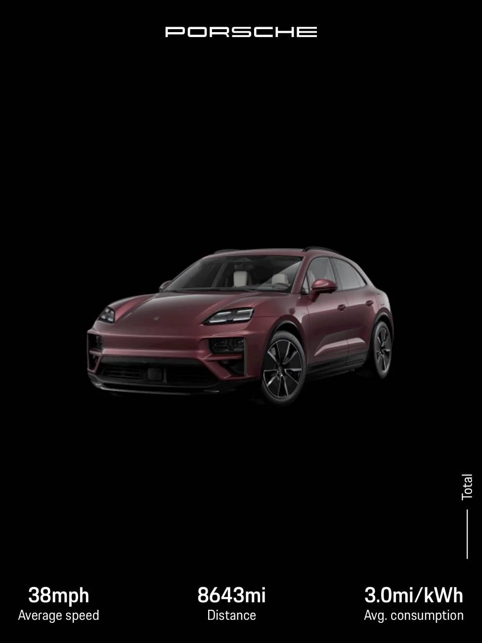

stats so far…includes the really really crappy range I got on the 2700 miles trip when I picked it up in PECATL and drove it home to Santa Cruz…
Electric Macan EV Range - again IMG_5660
535
369

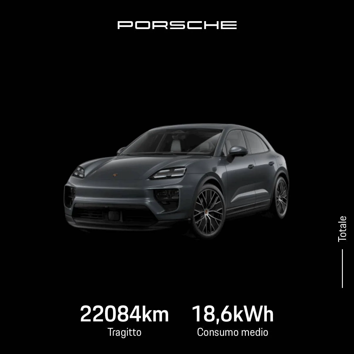

Now 3000+ miles and now over 3mi/kw average with a 40mph average speed. This is a 4S with 20 inch Pirelli MS all season tires. Default settings. Our mini averages 4+ mi/kwh over 20k+ miles.
Most of the time was on 30-40 mph twisties. Most of the miles on 70+ mph highways. A few scattered 80 mph sprint miles that ate up kws. So far the best I've seen on hour+ drives is 4 mi/kw, the worst was 2.5. I don't baby it. I typically use adaptive cruise on the highways.
