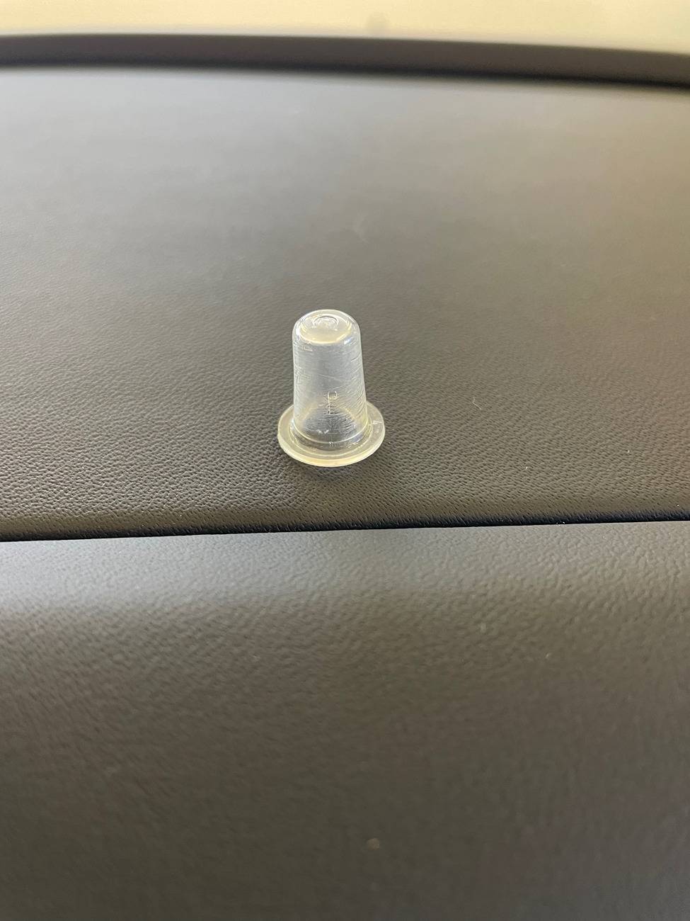

Just a quick update. I did a ride-along test with an advisor and he showed me that sound can travel weirdly (i.e., where you think the rattle is coming from may not be where the rattle is actually coming from).
Based on his observations during the drive, he guessed that the rattle was coming from the overhead console (prior to the ride-along, i was 100% certain it was coming from the dashboard).
Once he mentioned the overhead console, I realized that maybe I had knocked something loose as I was installing the FitCamX (which requires removing part of the overhead console to install).
I asked if I could drive the car home and take a look at the console myself instead of leaving it at the service center and they said ok.
Sure enough, once I opened it up, I found the loose part rolling around. Ironically, I think Porsche includes this part to prevent rattles haha. I think it's supposed to cover a hard-plastic part and prevent it from rattling against a neighboring hard-plastic part (someone please fact-check me on this if I'm totally wrong on the purpose of this thing lol).
All in all, this was an illuminating service trip where I got to learn about the illusion of sound. And, pretty cool to see Porsche's attention to detail in even something as mundane as the overhead console.
