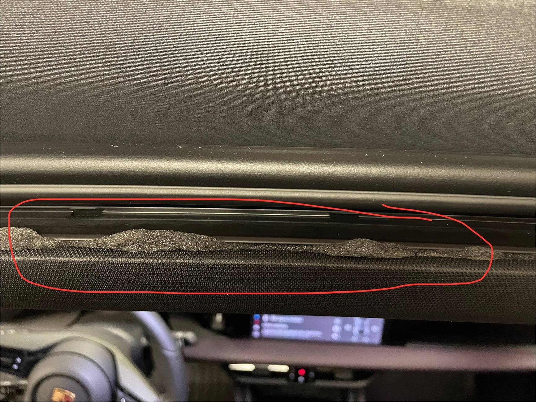

quick update on gummi pflege, I don’t think it did anything…i applied it on sunroof and did a quick drive afterwards and still observed rattle.
I then took a look and noticed there was a gap where the headliner meets the sunroof but only on one edge (front edge parallel to windshield. Plugged it with acoustic foam , using the process described here and didn’t observe any rattling on 1hr+ of driving yesterday.
Not sure if this pic is helpful so let me know if you have any questions. I didn’t “pretttify” the work because the foam isn’t visible in day to day driving, only when you peek your head out of the sunroof.
Electric Macan EV New 4S Roof Rattle 1741884220140-96
I didnt post a new thread for this cause the rattling is pretty subtle and unless you have sensitive ears and borderline ocd like me, it probably won’t bother majority of people
so my conclusion is that my rattling situation is most likely coming from the headliner gap and that the gummy pflege didn’t do anything (it could be possible gummy pflege actually did help and just needed time to cure overnight or something — I don’t know the inner workings of gummy pflege ?) but I’m happy the rattling is gone
so far acoustic foam has been a lifesaver for me… Ive used it everywhere on the car with pretty good results. I guess my mantra should be “when in doubt, stuff with acoustic foam!”
So after 5 months of rattle free driving, I started hearing a very subtle rattle in the cabin. I couldn't quite place where it was coming from but after poking around a bit, I happened to press lightly against the roof liner (in the area of your photo) and the rattle subsided. I ran my finger along the gap between the sunroof frame and liner and noticed that the gap was not even -- it was tight near the driver's side but the gap grew towards the passenger side. I pushed the liner a little more firmly near the passenger side and felt it snap into place. It now sits perfectly even and the rattle is completely gone! I guess the liner wasn't fully engaged in the clips holding it to the roof. Something to check if you're hearing a rattle near the sunroof.

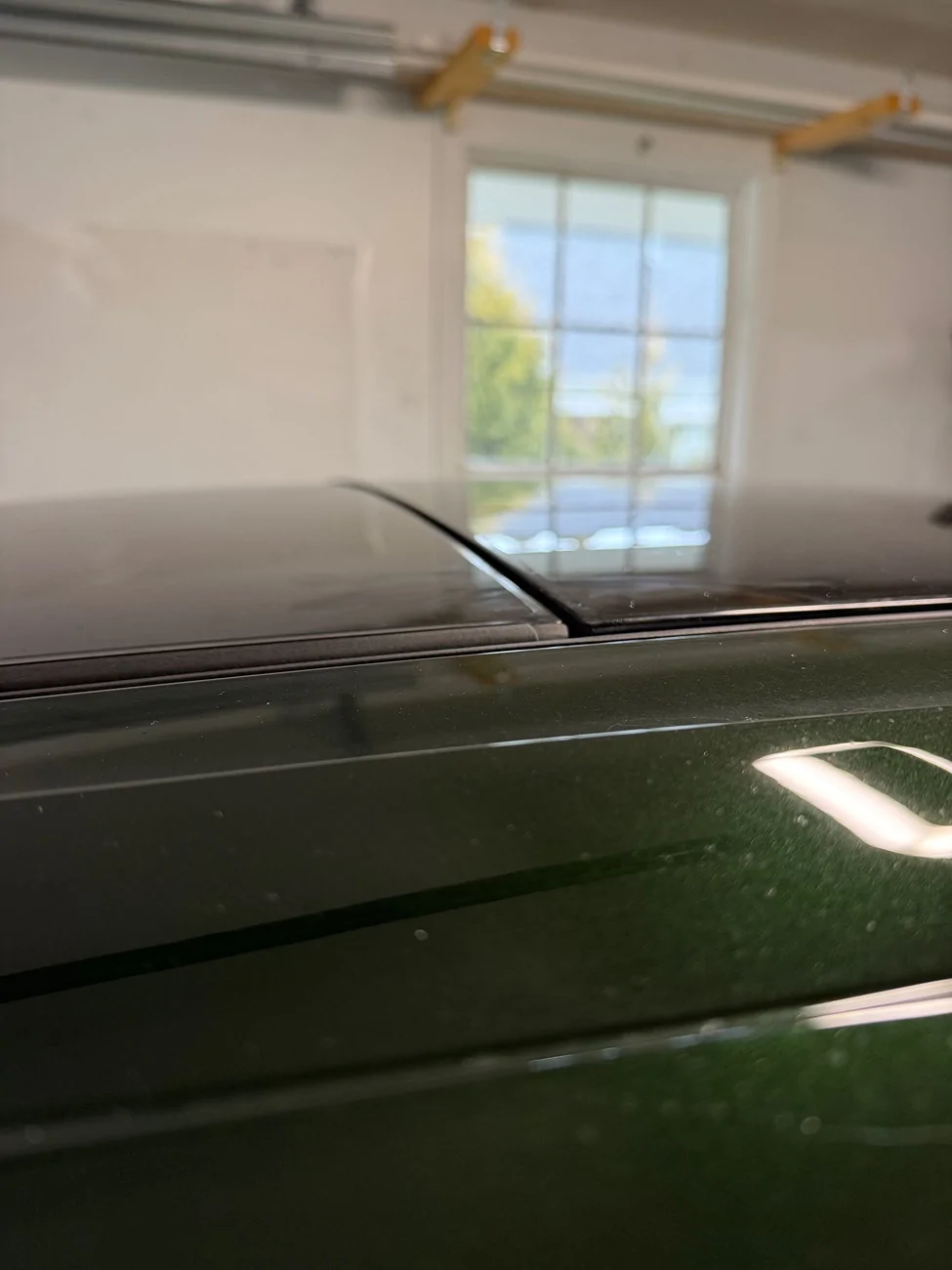

So it’s now been over a year and i still hear some movement / rattle noise on bumpy roads. Dealership has played around with it and it has helped somewhat, but not completely fixed it. I also noticed that the front panel of glass on my roof doesn’t perfectly align with the back. Seems like it should? Do others with a moon roof see the same thing? In the attached pic, the front panel (on the right) sit’s higher than the rear (on the left). i dont have another macan to compare to but on my wifes’s x5 the two panels are totally flush to each other.

No, not even close. That is not even acceptable for a non-premium car. What the heck is that?! You need to have a serious conversation with your dealer and involve Porsche HQ.
