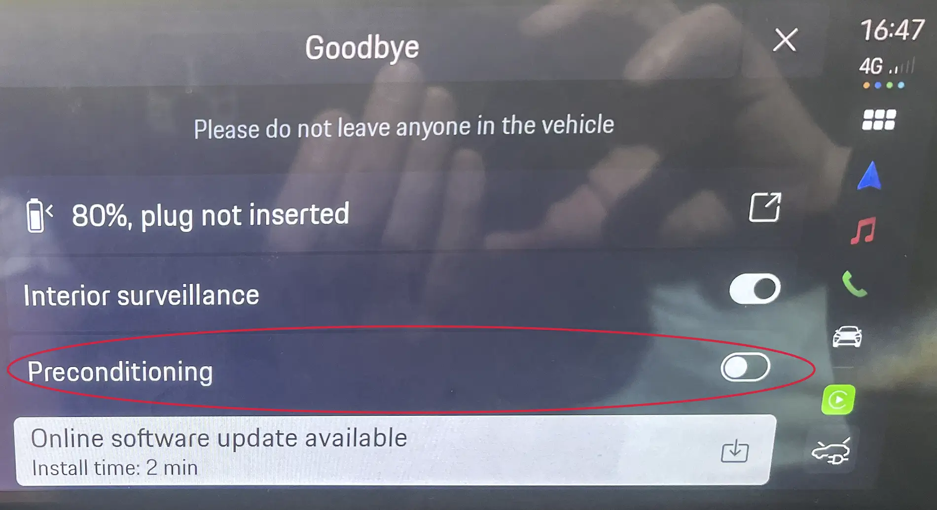

even where to tell th car as long as we are in sunny keep the aire conditioning when I leave the car.
When you park the car, do you get a 'Goodbye' screen? On my car, it shows a pre-condition:
Electric Macan EV Air conditioning launch remotely 1784401089230-cz
When I send pre-condition from the app, the time for the car to activate is short, maybe ~5 secs.

Thanks Aks.
Your solution works fine.
More responsiveness
