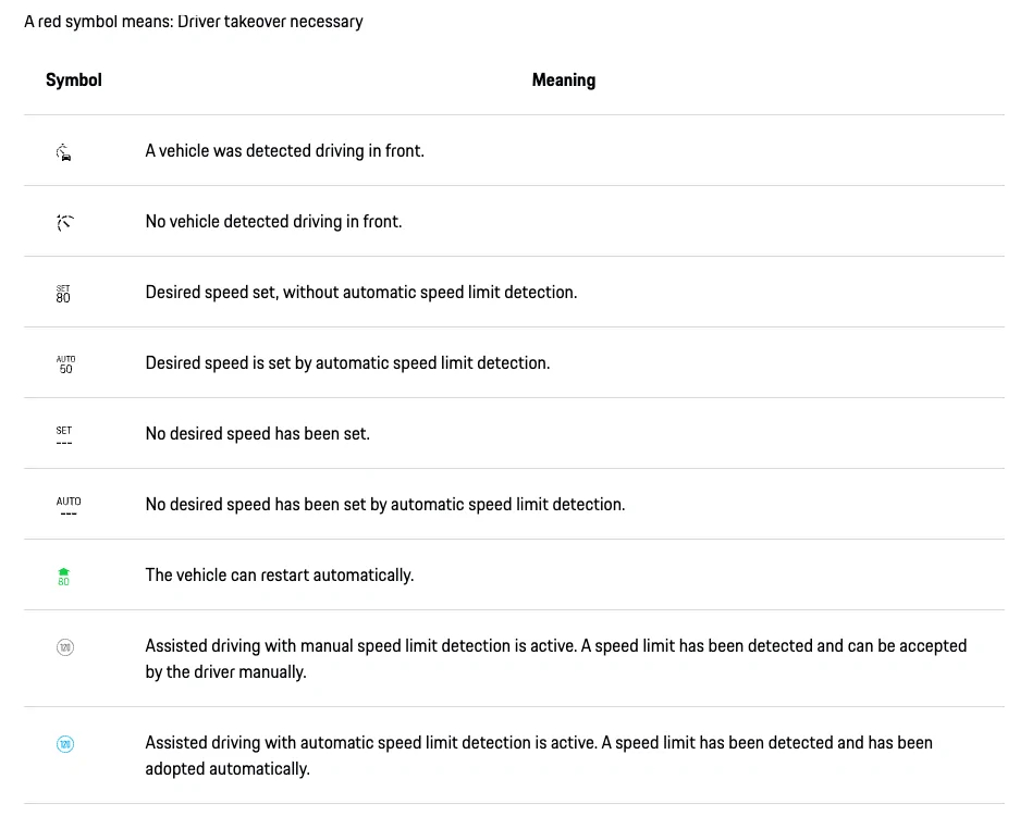

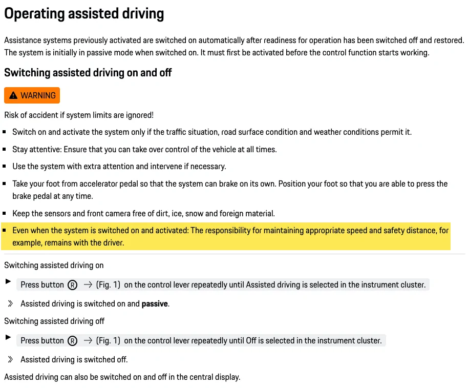

Active Speed Limit Assist is not an extra and is standard on all Macan EVs (can't confirm if from 2024 or only from MY 2026 (late 2025 onwards)).
When activated and the car powered off then on again the system default is a passive mode (greyed out) and available should you wish to invoke. This will be due to an EU ruling no doubt like much / all of modern car ADAS systems.
Dealership blarney is generally to be ignored as they are generally the least likely to be informed about this level of detail. Gold Techncian might be a better source at your dealership.
I've already mentioned that it's been an "issue" or "feature" for many years and if solvable would have been addressed long before now.
What is interesting however is that some folk prefer to ignore the conditions under which technology such as this is designed to work and what the inherent dependencies are. Needless to say even fewer actually read the supporting documentation to better understand the operation and limitations.
Electric Macan EV Auto speed limiter fault 1777804052126-pm
If not familiar with the iconography see below for what they are (grey means passive (ready for use but not active), red if the driver must take over, green for go etc.
