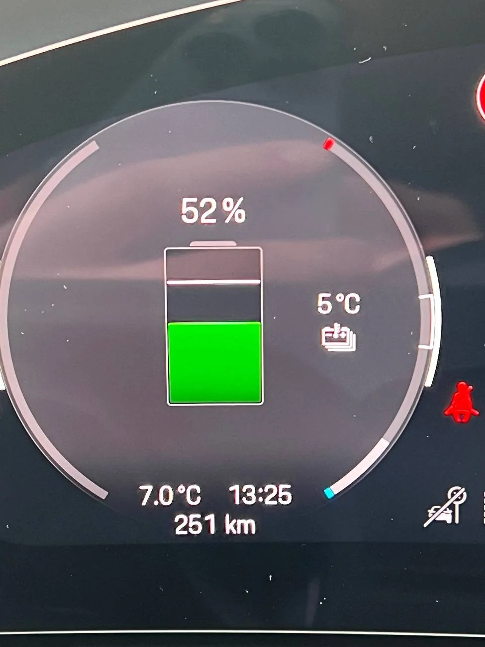

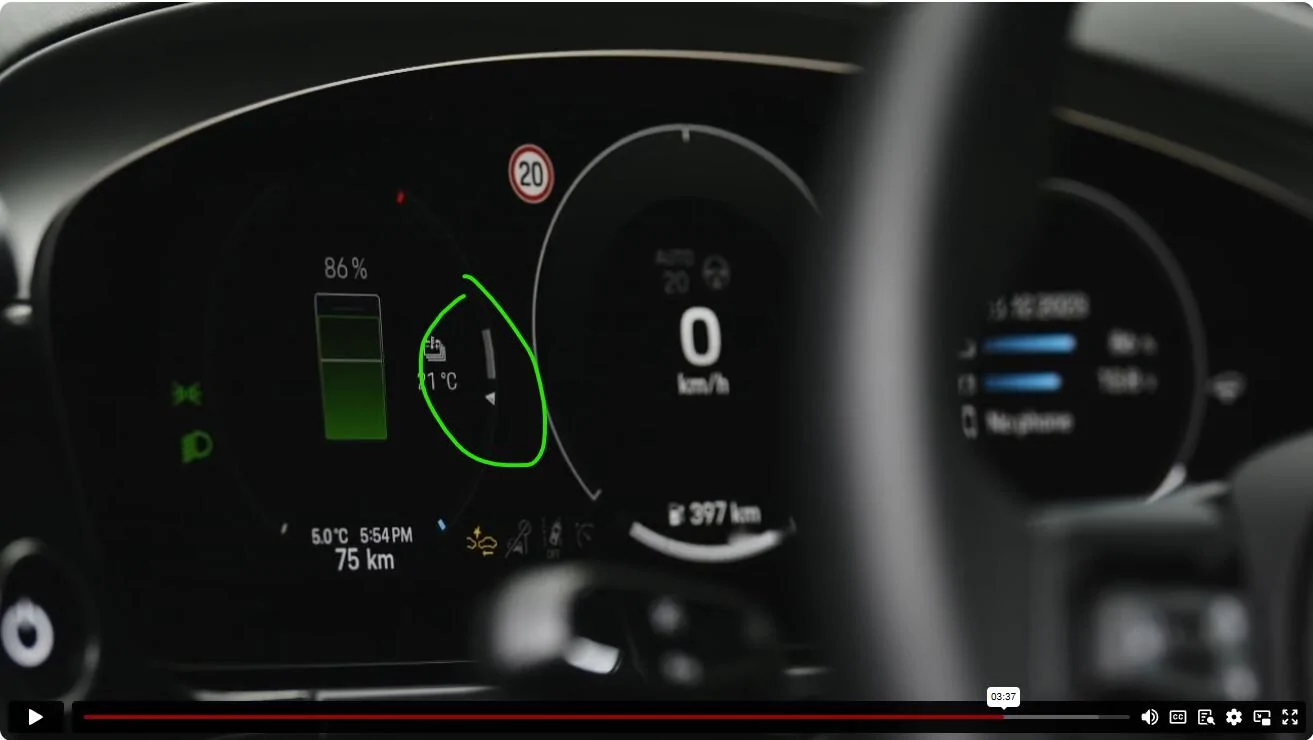

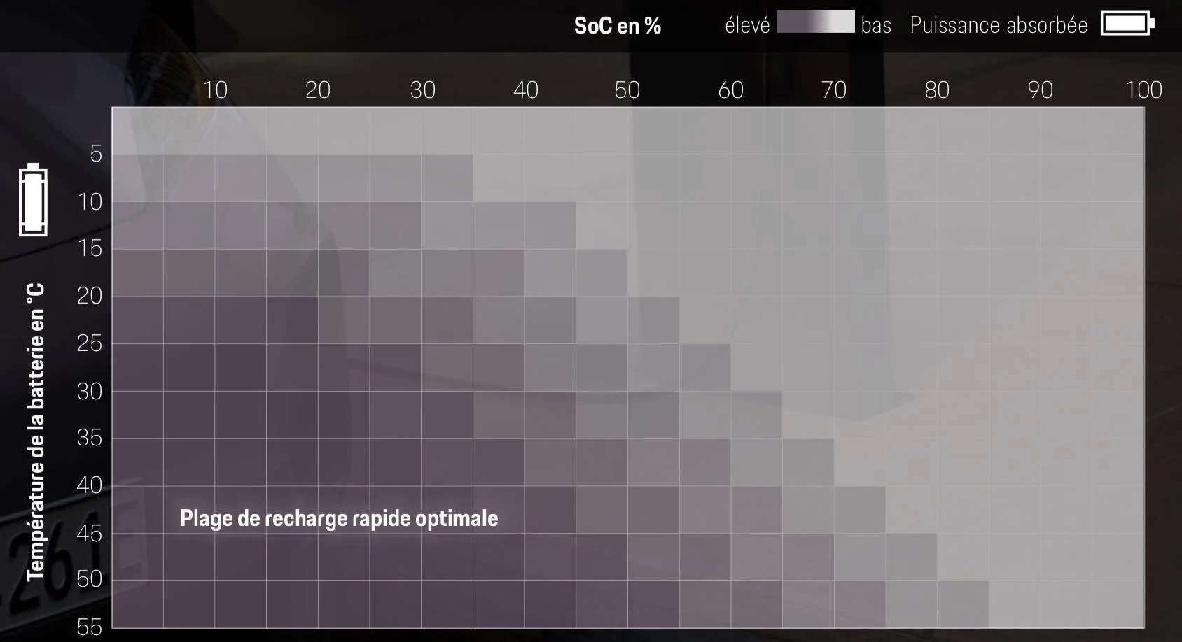

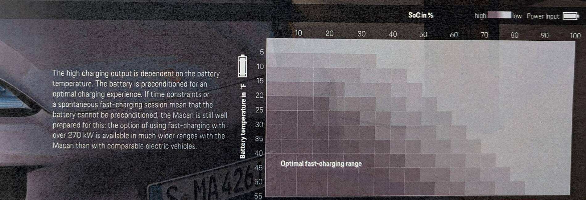

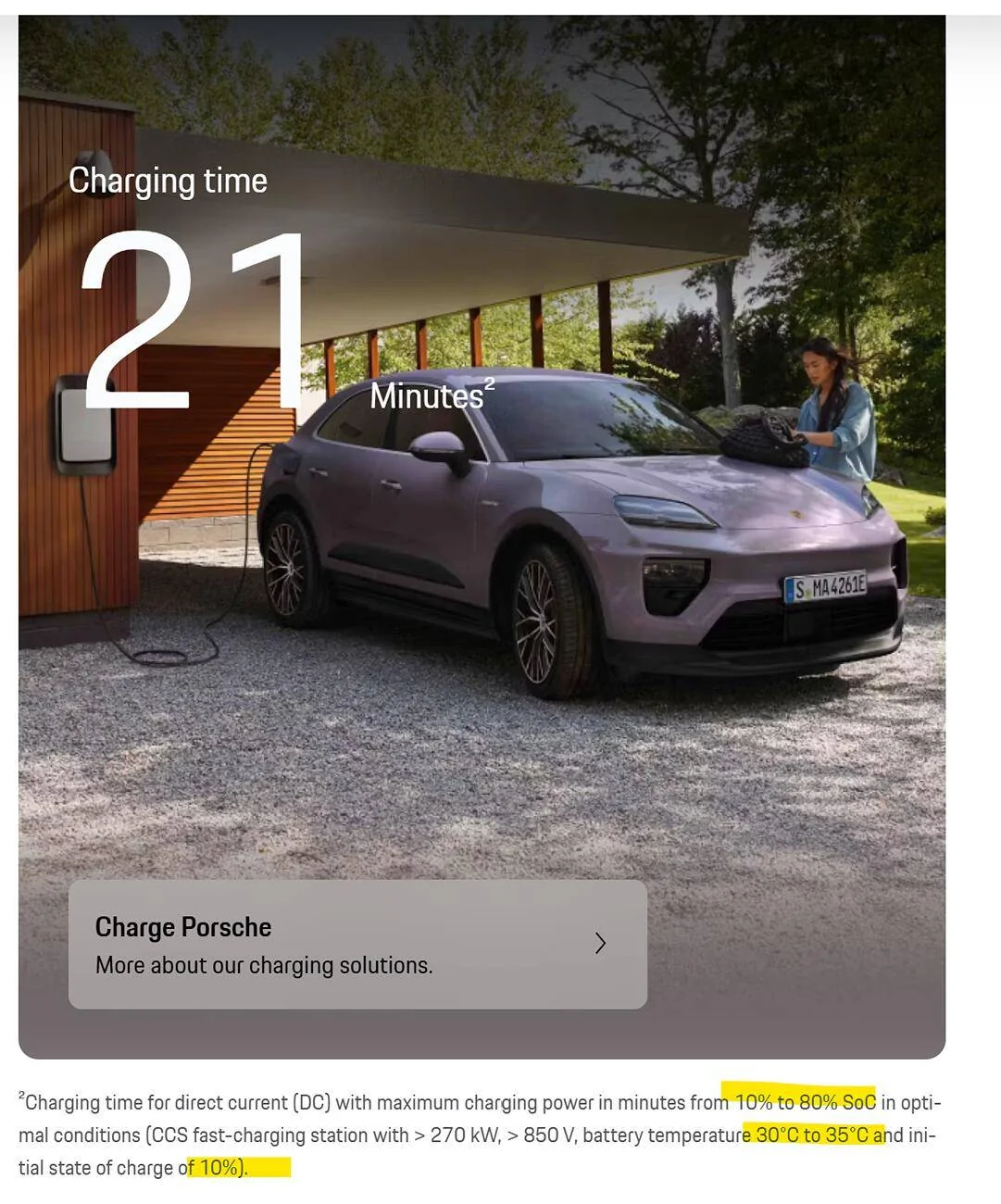

My understanding of NMC811 battery chemistry is that the optimal charging temperature is around the low-30degCs. That is also what is indicated on the gauge. This has to do with longevity of the battery.

In a recent Out of Spec podcast, apparently the arrow icon representing the car on the built-in nav system changes color when the Macan is preconditioning. There is no manual option to precondition and it seems to only precondition when you use the in-built nav system with the in-built charge planner.
