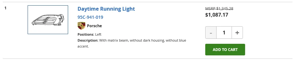

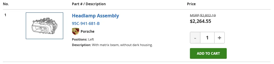

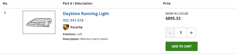

Not kidding. Historically, VAG parts with cosmetic difference are usually just the last letter different. If the hardware is different then the last 3 digits would be different. This goes back as far as I can remember e.g mk1 TT sharing Golf mk4 parts. AI summary of this here but lets work through a practical example below.
E.g. Take the front headlights and the difference between matrix & non-matrix - a definite hardware difference and gives different last 3 digits in the part numbers. Note the 'B' denotes a 2nd revision updated part:
Electric Macan EV Coding Options 1770657116348-hh
Electric Macan EV Coding Options 1770657060332-iq
Similarly lets look again at the matrix side lights and non-matrix side lights, they are subtly different: wider vertical spacing on the matrix lights - hard to spot but its there. A hardware difference, not just colour:

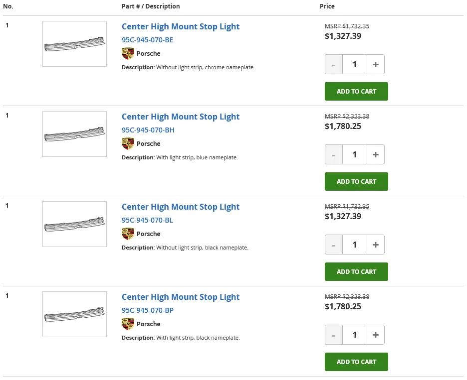

Then consider the rear light bar, all the same numbers except the last letter. Same hardware but just a cosmetic difference - I would bet my 2nd pension fund that light bar animation can be programmed!
That's not true, a different last letter can mean different revisions, different markets, different features all equaling different hardware.
Have a look here:
https://www.eurospares.co.uk/Porsch...ight_reflector_Additional_brake_light?ref=003
Example from above link:
95C945070BD
REAR LIGHT CENTER LIGHT STRIP INCLUDED ADDITIONAL BRAKE LIGHT
P8VG (LED rear combination lamp)
PAV0 (Driving on the left)
from £1,094.83
95C945070BG
P8VQ (LED rear combination lamp, variable lighting functions, special styling)
from £1,468.35
Animated light strips are 400 quid dearer as they contain different electronics (guessing more led segments, led driver has more channels, controller more complex, different command set, different ICs, who knows without opening them up, or having the diagrams for them)
Even if light bars were the same (which they are not) you would still run into other issues:
1) BCM hardware could be different
2) BCM software could be different
3) Feature tied to order may be encrypted
4) etc.
