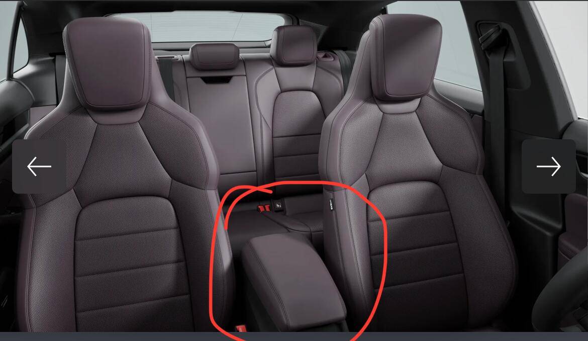

Am I missing something here, don't you lose the use of the cup holder for your coffee with this tray?
hi Carl,
sorry for the confusion, I should have taken better pictures. This does not affect the cup holders. This tray is meant to go in the center armrest storage bin

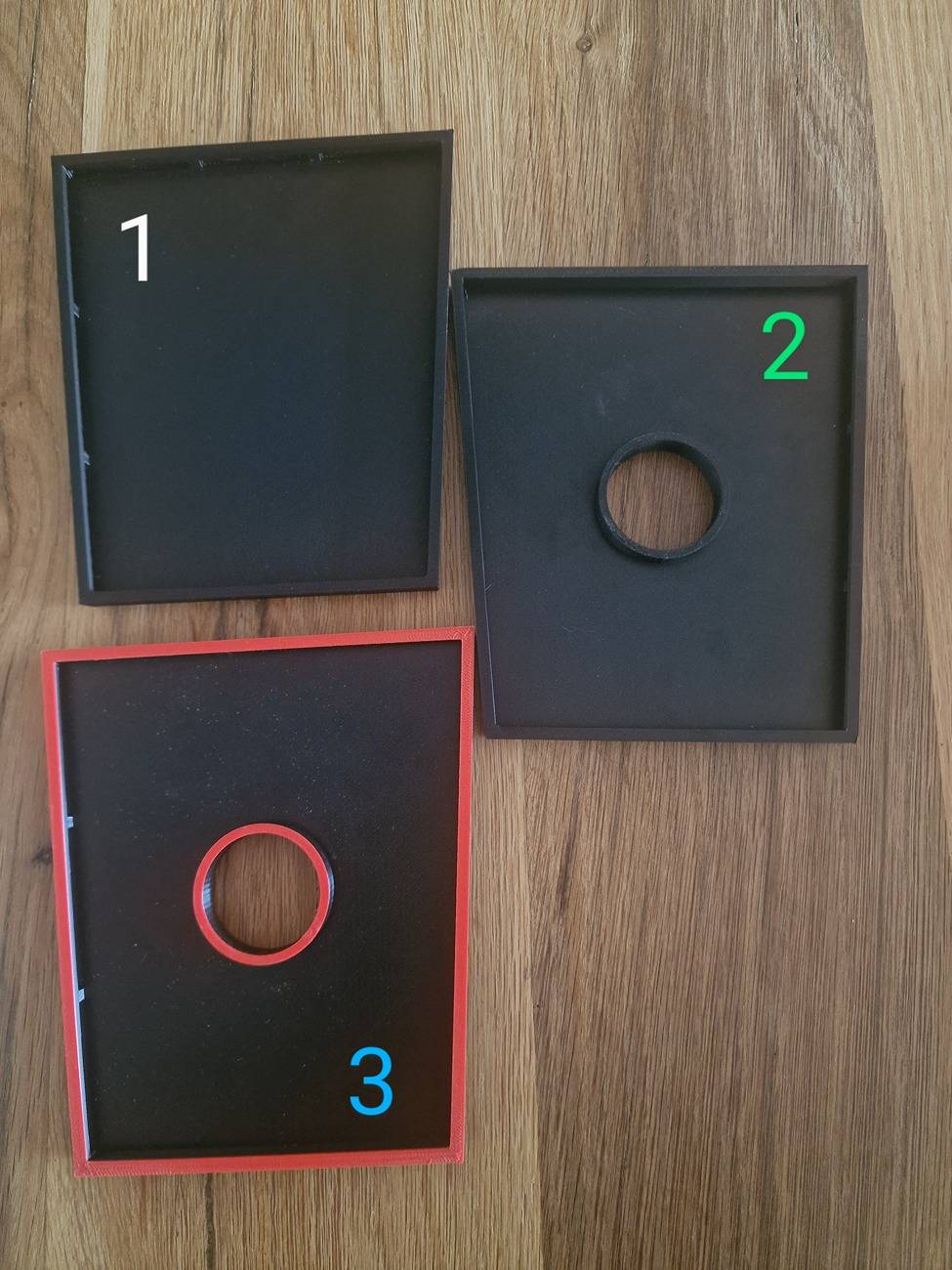

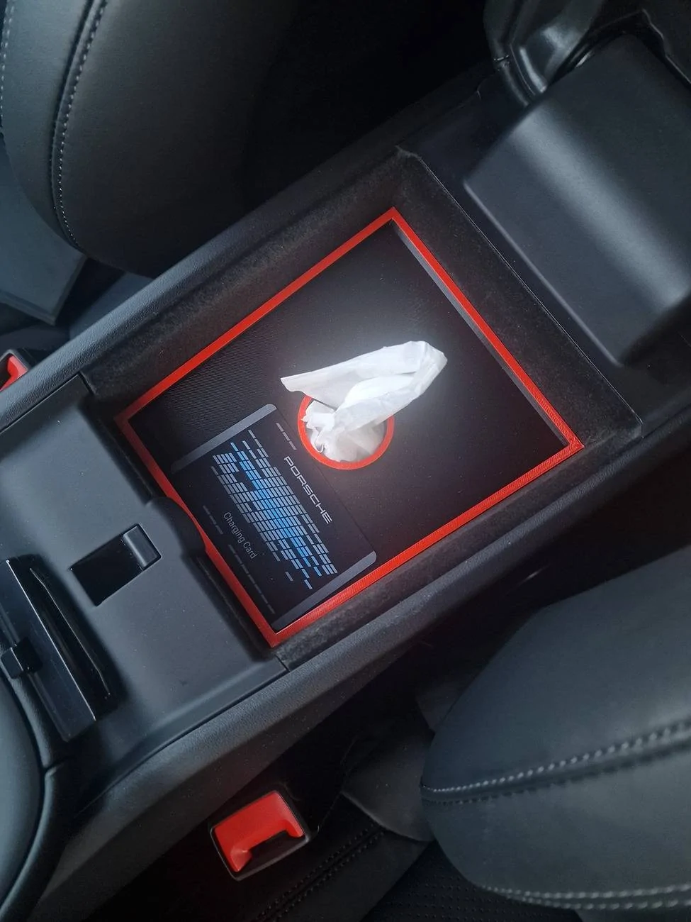

Had mine printed by a friend. First one was a little too tight, number 2 and 3 were printed on 99% and fit very well. Thanks @cottony for sharing all the info.

Love the red contrast stitching ? You have a very patient friend to help you print so many copies haha!
Glad it worked out for you!

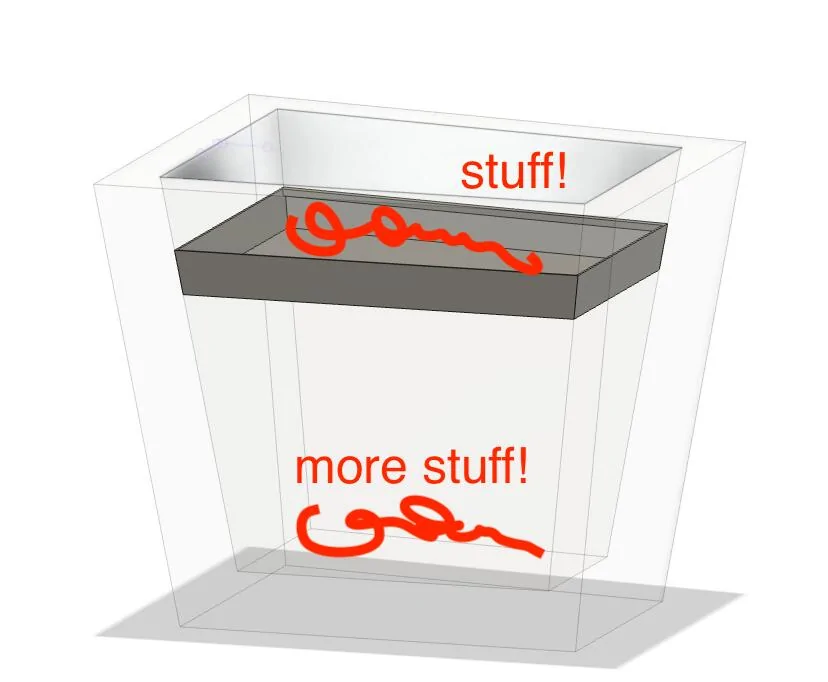

Hi everyone,
I got a lot of positive feedback on the Custom Cubby Organizer post I shared, wanted to build on that and share a slight modification I made to the center armrest storage area.
I only put little knick-knacks in there like my work badge or car wash coupons, but since the storage is really deep (7 inches to be precise), it feels unnatural to reach so far down for my items. Additionally, I felt like a lot of the volume in the storage space goes to waste because unless I'm putting something that is 7 inches inside, the top portion is just empty air.
I'm currently iterating on a simple tray design. I noticed the storage area is narrower at the bottom, so the idea is for the tray to take advantage of that narrowing and create a shape to be held in place by friction. Adding this tray will allow for a second level of storage as well as putting my knick-knacks within easier reach.
I got this idea from Tesla, which has a 2-level storage system for the center armrest (although the implementation is a bit different).
I'll be more than happy to share files for this design if there's any interest, although I think it's a couple more iterations away from being ready. Right now, the handle to take the tray out of the storage area is a bit flimsy, I'd like to strengthen it before sharing the files.
Please let me know if you have any questions or ideas/suggestions to improve, thanks!
EDIT: I’ve published all the designs to Thingiverse — you can find all of the files free to download here!

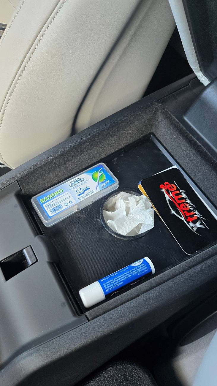

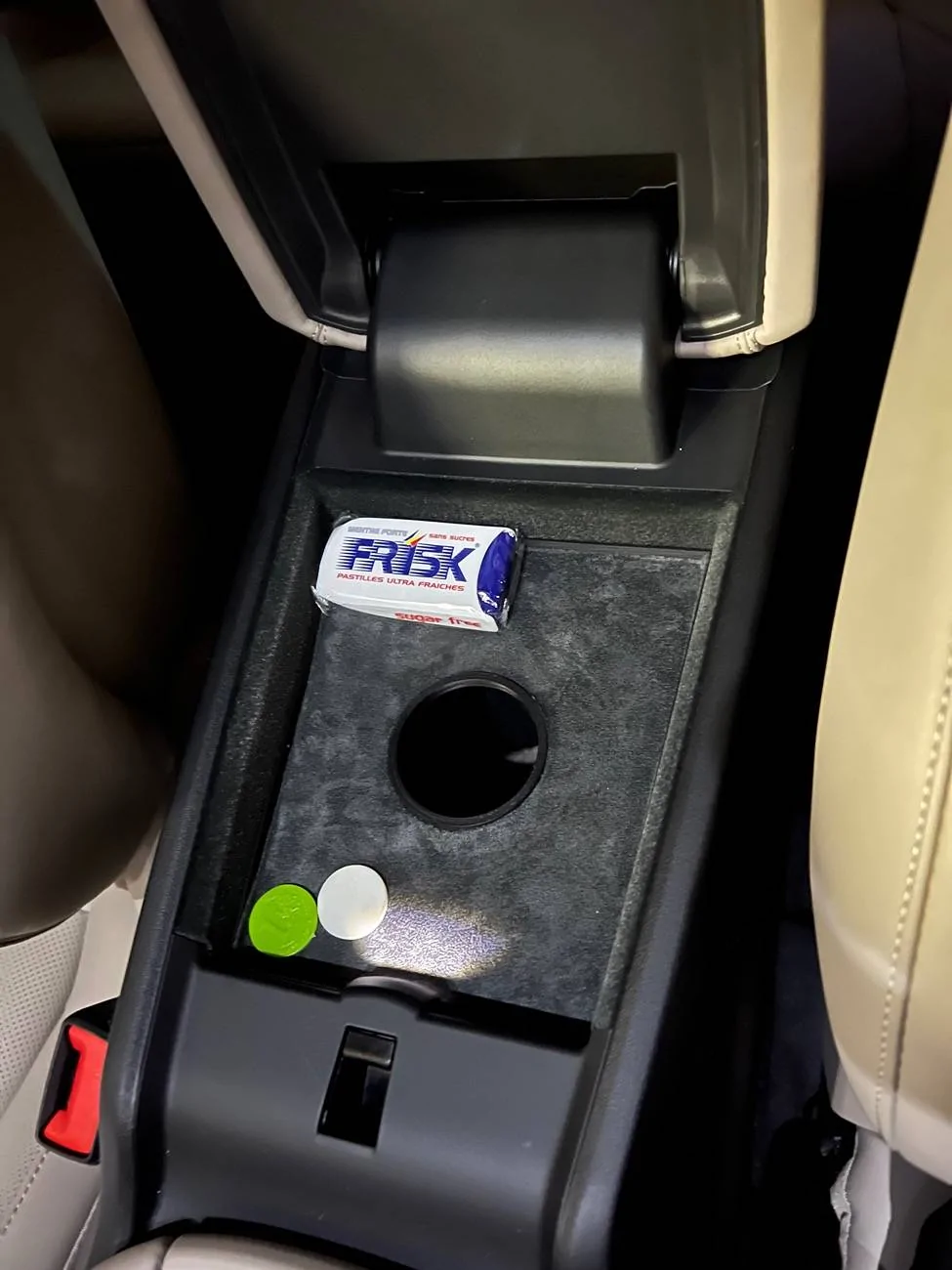

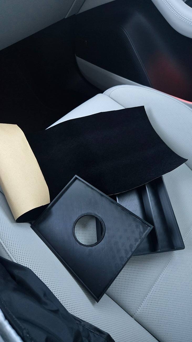

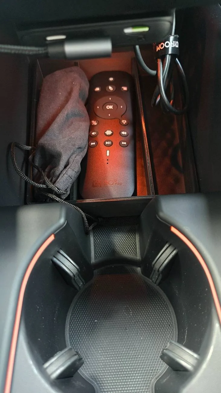

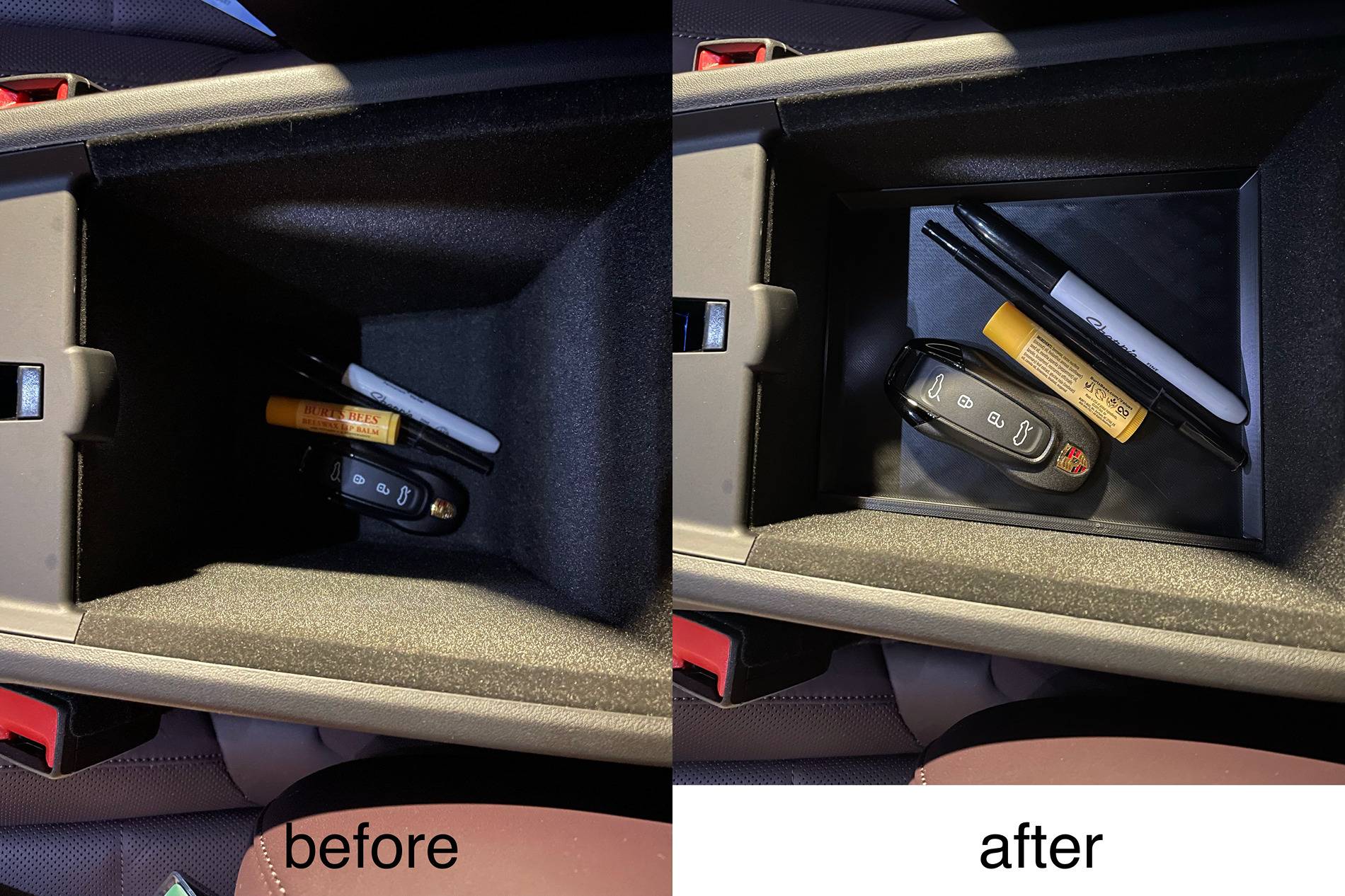

received my goodies today from @cottony !! he's awesome!! i had a two-tier in my old lexus that I like putting a few essentials on top and this definitely satisfied it.

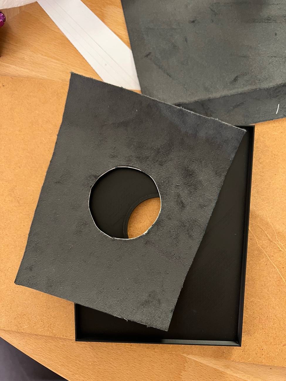

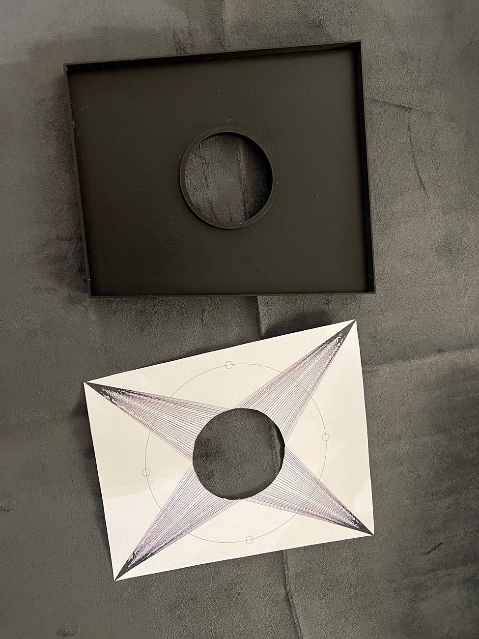

Hi everyone,
I got some feedback that it's a bit difficult to trace out the felt for the kleenex passthrough, so I uploaded a stencil for each of the surfaces to help anyone who's looking to put felt on their design.
The stencils are available on Thingiverse under "kleenex_slot_stencil.step". Thanks!
