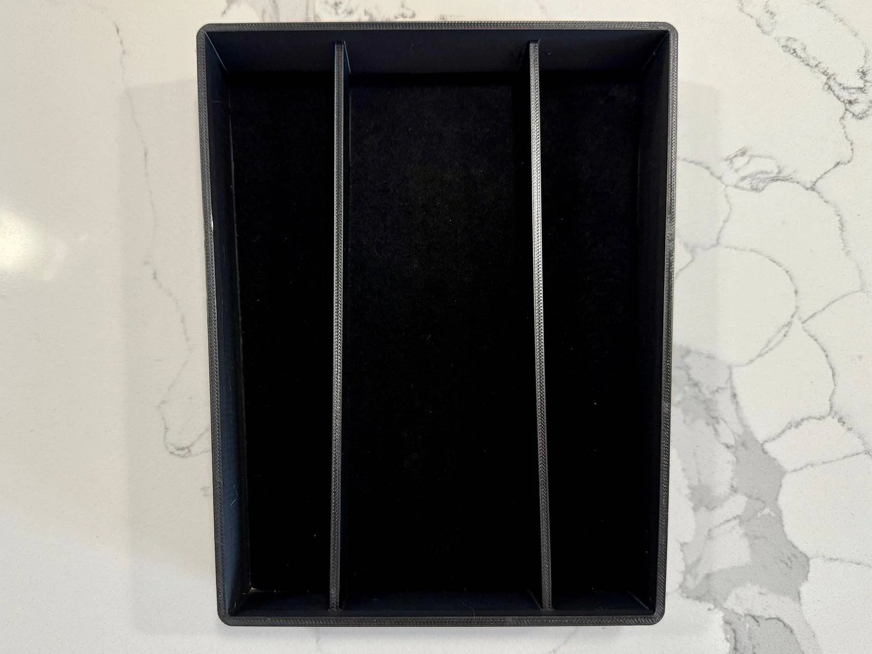

Looks and dimensions
This little box is 6” wide at the top and 5” 1/4 at the bottom. It’s 7” 1/2 high and just 1” 1/4 deep.
There are 3 storage areas:
- the left/right ones are 1” 5/8 wide at the top and 1” 1/8 at the bottom
- the middle one is 2” 3/8 wide

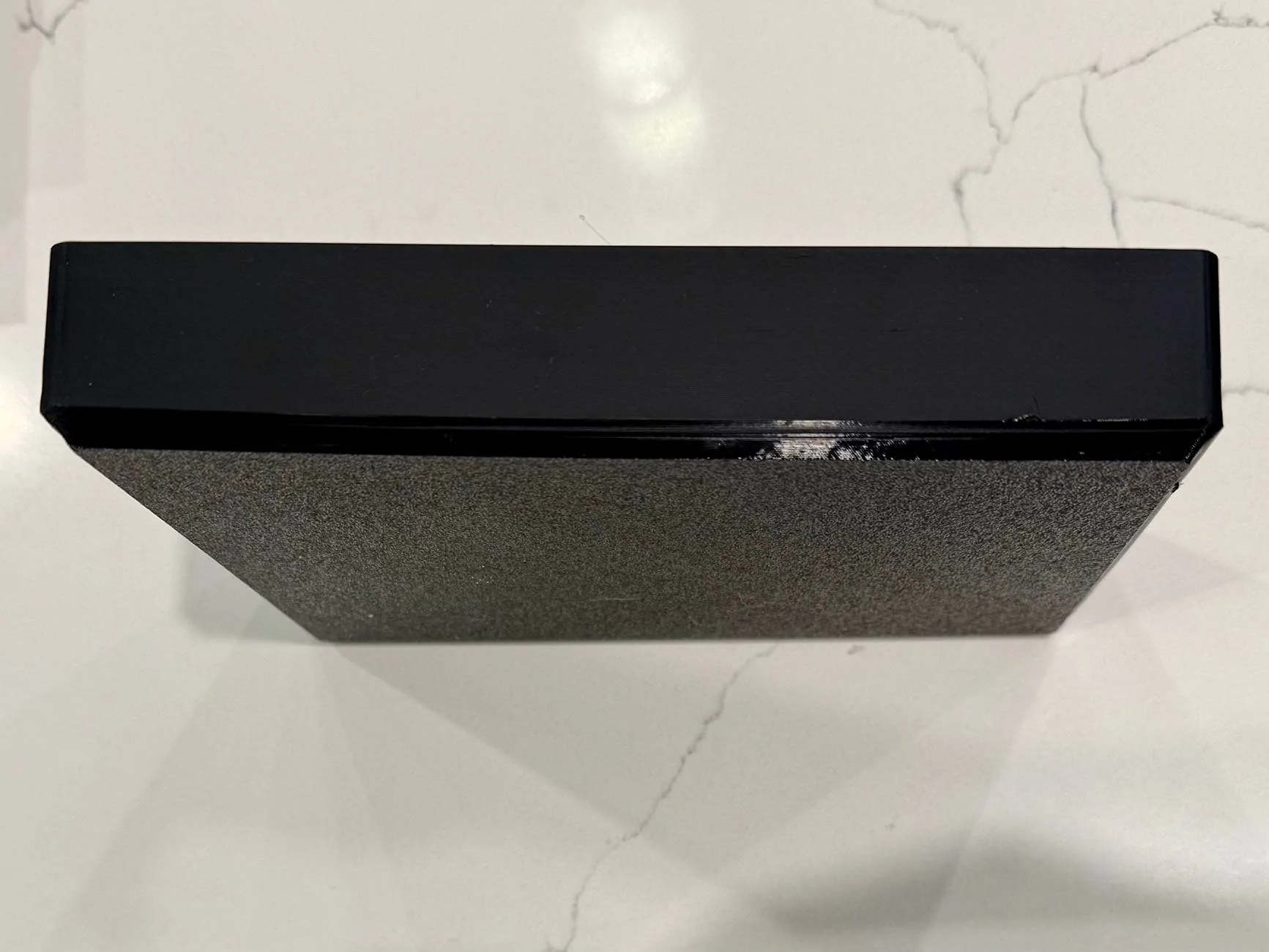

This version is black, the finish quality is quite good and smooth to the touch while the bottom part is slightly textured. Overall very good!

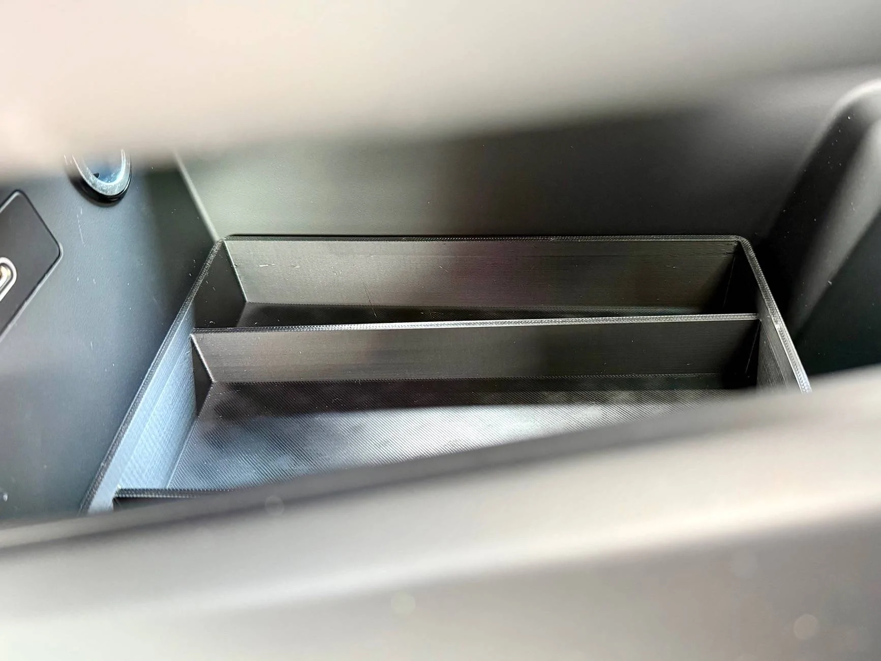

Installation and use
Installing the organizer requires finding the right angle to slide it from the side opening of the center console. Took me a couple of tries but once you figure it out, easy to install and remove.
There is tiny gap around it once in place and I was concerned it would move or vibrate as I drove. None of that thankfully.
Without that little space, installing/removing this organizer would be a nightmare so it’s actually just right.

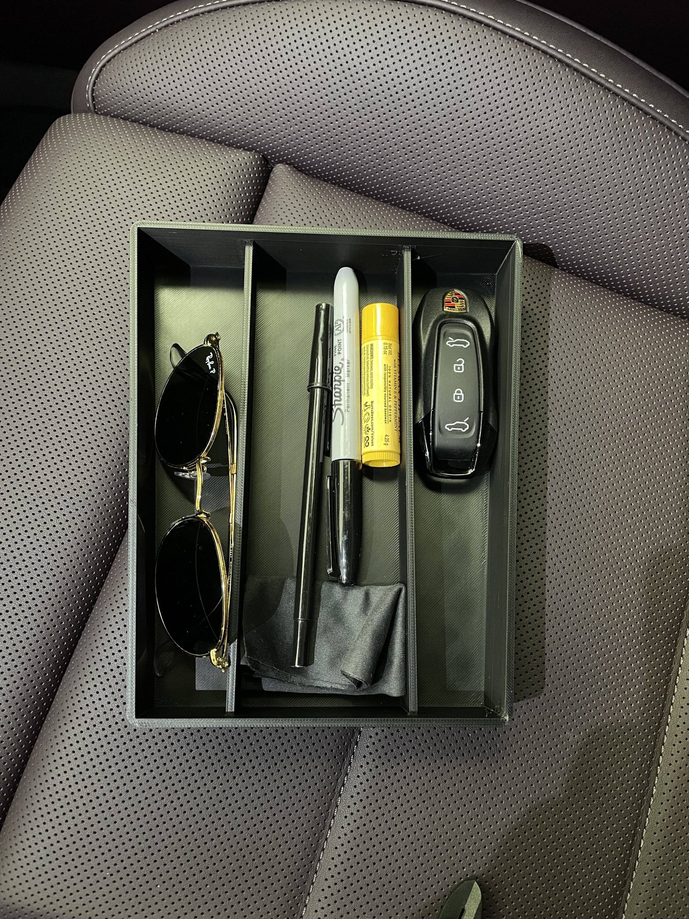

It fits my sunglasses perfectly on the left side, has plenty of room for cards or other accessories in the middle and I’ve added the rectangular EZ-Pass tag on the right for size.

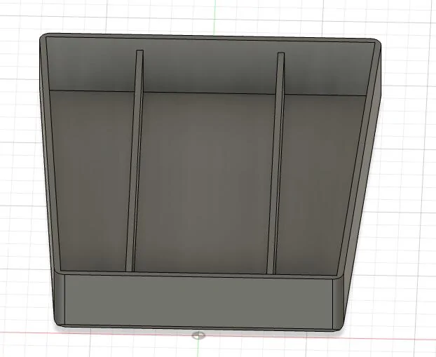

This is a bit of an intersection of a couple of my hobbies, but wanted to share a cubby organizer I modeled out and 3D-printed for the area beneath the climate controls.
I kept the initial design pretty simple; I uploaded the files to thingiverse if you'd like to play around with the design. If you have suggestions/improvements I'd also be happy to make those modifications for you.
The cubby area doesn't have any large openings, so the best way I found to install the organizer was sliding it in from the side.
The rule of thumb is to print using PETG for car accessories (to reduce heat warping), but in mild climates, I've been able to use PLA without much warping. Total cost of print was $3.27 (but I'm sure if Porsche was selling this, they would add their logo to it and mark it up to $50 :giggle:)

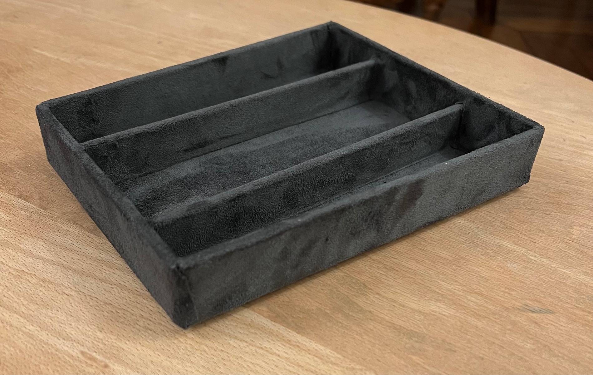

Finally: full alcantara covering!
far from perfect (for example, I should have started with the inside upper/lower side, then done the other sides... and several other tips) but as it's not very visible, it's not a major problem.
side note: I have a better understanding of the “why” is full leather is so expensive, just a pain in the ass to do it!
