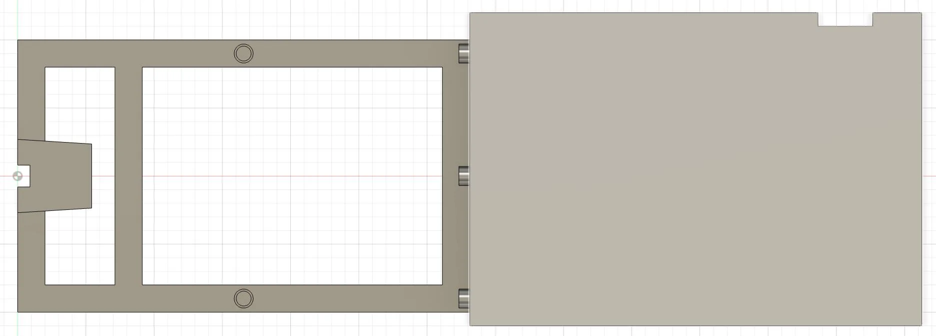

I've always felt that incorporating magnets into a design makes it sexier so why not go full send?
In this updated design, the visor extension is fully detachable, and there are 2 sets of magnets -- one to hold the extension to the frame when it's not in use,
and another set to hold the visor at full extension.
Here's a close-up of the connection at full extension
With 3 magnetic touch points, I feel pretty confident that the extension shouldn't detach during use, even under extreme turbulence. But this will be something to test out in the coming weeks.

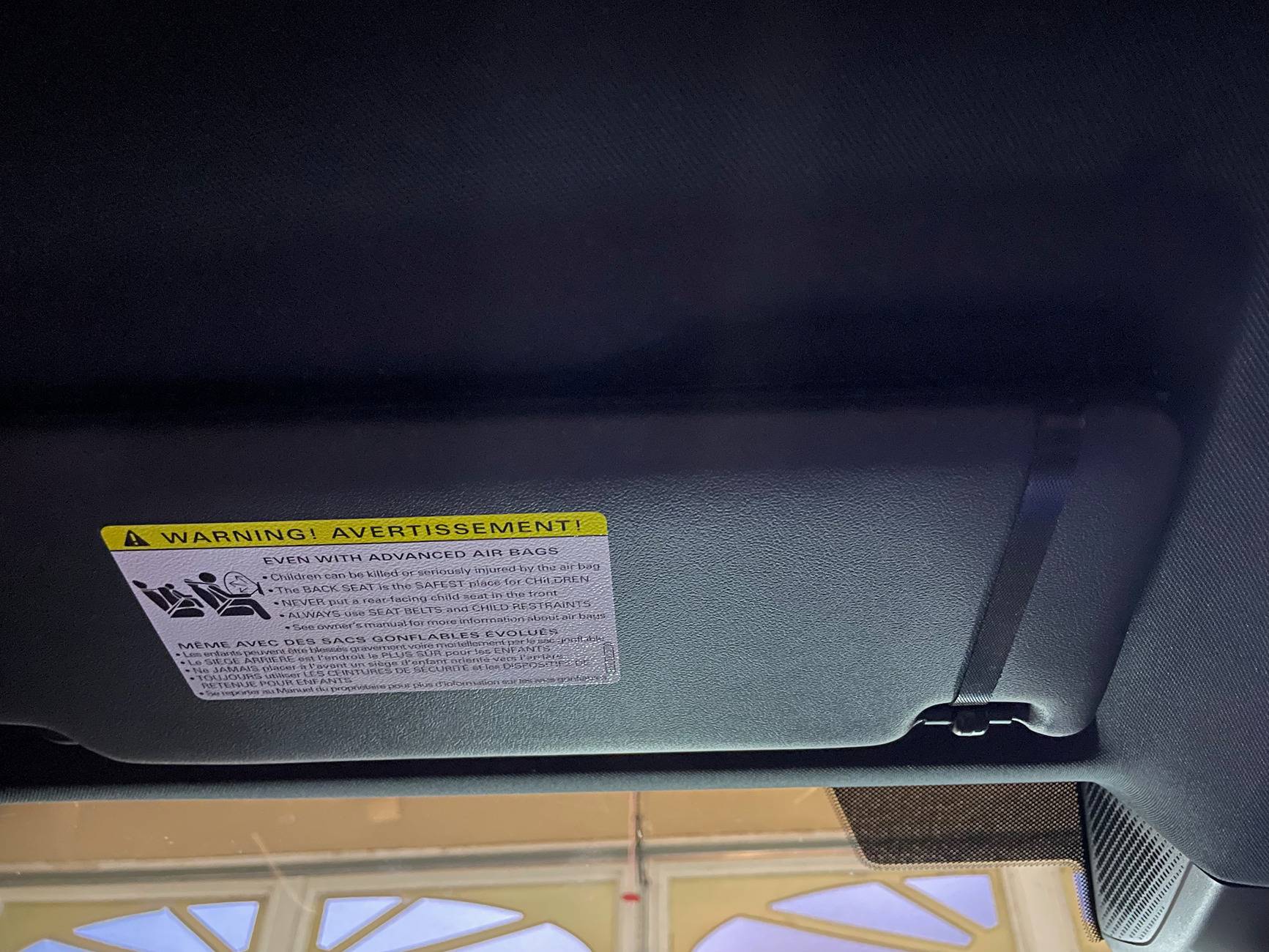

How low does the visor add-on hang below the visor when fully stowed? Maybe a picture to see if it obstructs view in any way.
cottony
Jul 19, 2024
201
252
United-States
tesla
sorry, i should have taken better pictures! the visor is fully concealed when not in use (with the exception of the velcro strap)! this is why i appreciated your velcro suggestion so much as it is the only thing that is always within eyesight!
the second of my starting requirements was to make sure i didnt introduce something that clutters the visual landscape
2) not visible when not in use to preserve the existing cockpit aesthetics
here's a pic showing the visibility when stowed away.

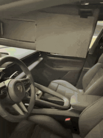

The only negative I've observed compared to the hinge design is that it's a bit harder to operate in the sense that it will take a bit of practice to build the proper muscle memory on where to align the magnets.
I attached a short clip below showing how the visor extension is deployed and subsequently undeployed (fun fact/director's cut -- the last few frames of the gif you can see the video turning orange cause my hand triggered the interior monitoring and caused my car alarm to go off lol).
Electric Macan EV Is this a sun visor for ants? 3D print sun visor extension solution trim.759C9C9E-50C1-4257-A134-E386800E9E9A
In my practice/test runs I've been able to attach and unattach the extension with one hand while driving and keeping my eyes on the road, but it's definitely not as easy of an operation as with hinges.

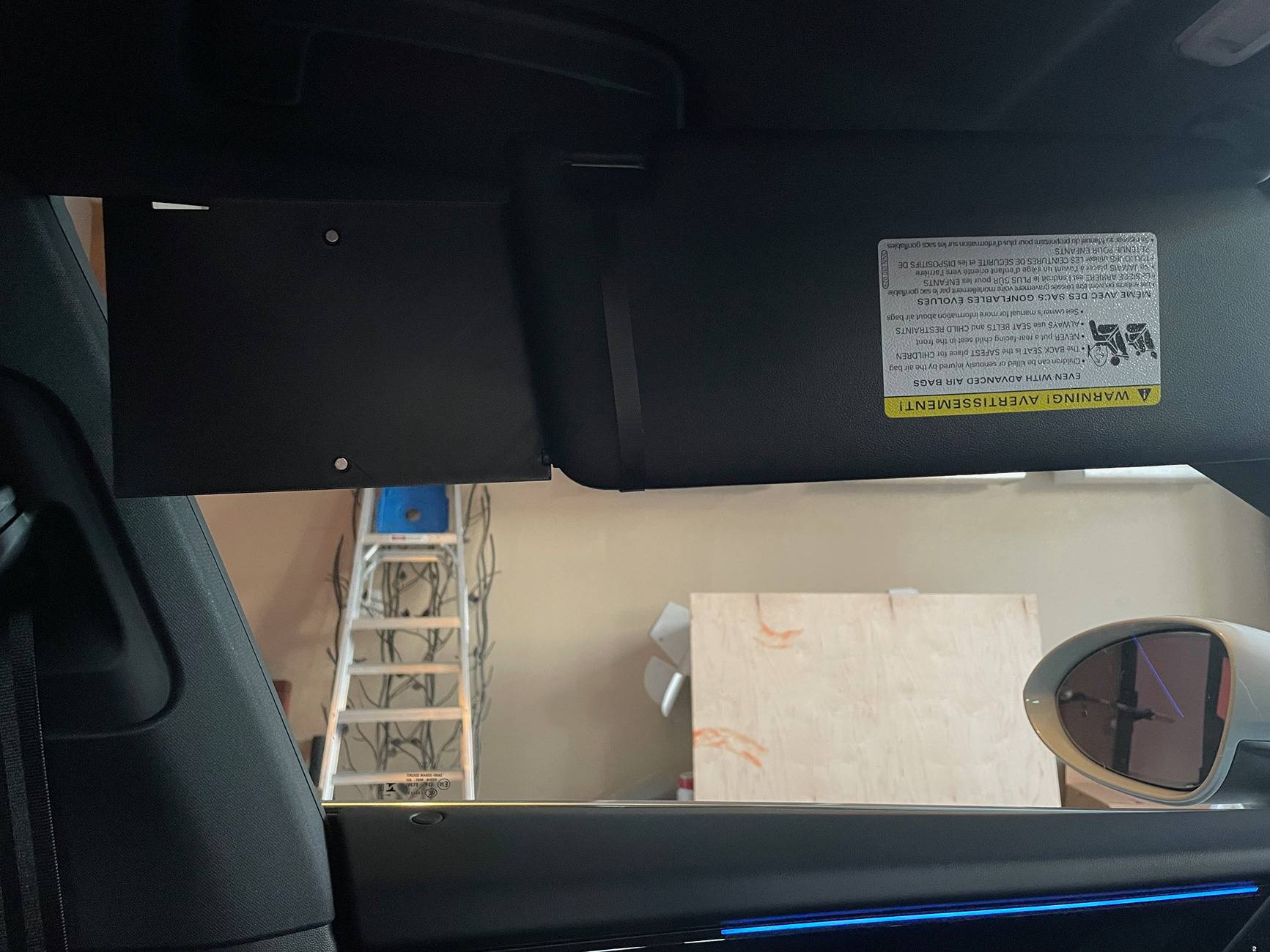

2) I was able to eke out a few more millimeters of coverage and can now provide sufficient edge-to-edge coverage!
Electric Macan EV Is this a sun visor for ants? 3D print sun visor extension solution IMG_3342
I had to cut out an indent because the extra surface area was hitting into the OEM hinge and causing the OEM visor to hang lower than I liked.
