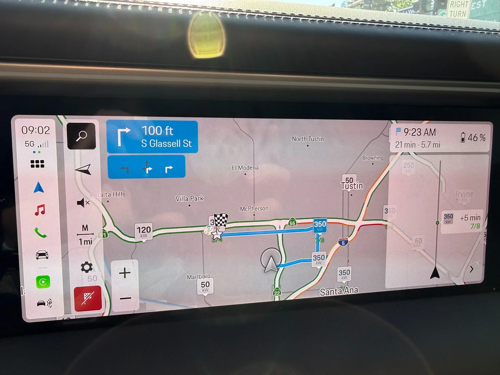

It worked well the first 8 months but the Porsche navigation system has become unusable for me. Recently, it wanted me to do two charging stops, the first 4 miles farther than the closest station. It also tried to direct me to every charging station (EA, Charge Point, etc.) along my 25 mile route with 100 miles of range indicated. It no longer shows the number of available chargers at my destination and the battery estimate upon arrival is always around 25% regardless of the SOC. It might be correlation and not causation, but I swear it went bad after getting the big software update.
Edit: I've uploaded the latest example. At this point, I was approximately 2.5 miles from my desired charger with a direct route through residential neighborhoods. I might not be interpreting it right, but it seems it wanted to take me out of the way on a longer route, 5.7 miles, with two extra stops. My SOC was 23% at the time. Notice the upper right corner. It says it will be 46% when I get to my destination.

You’ll be at 46% because it added a charge stop for 5 minutes
it’s likely you have a minimum charge at destination that’s set to 45% so it tries to do that here, but it makes itself look foolish in the process.
Settings Icon > Charge Settings(?) should show you this
Edit to add: Oh, it also didn’t take into account that the Destination IS a charger, so it ignored that in planning your charging stops.
Porsche thinks Charge Stops and Stopover/Destination points are entirely different for planning purposes
My route setting was at 30% "minimum charge at destination." It makes no sense to send me to an extra charger as a stopover that was about the same distance but out of my way. And it's not like I'd run out of battery when I had probably 75 miles of range. It's a mystery.
437
458
Indeed. I can see how it did what it did based on their stated parameters. But it does make no sense to a human!
The trickiest part is that Charge Stops and Stopovers are not the same, and once you’ve added a charger as the stopover (destination in this case) it fails to be used by the charge planner.
It’s very quirky, but I’m starting to get a feel for it as I was working out the incorrect destination SOC for my car. That has now resolved after a long trip using the planner.
In your case, because you were below minimum destination SOC already, it MUST charge along the way, even if that makes no sense in this case.
German software can be very literal
