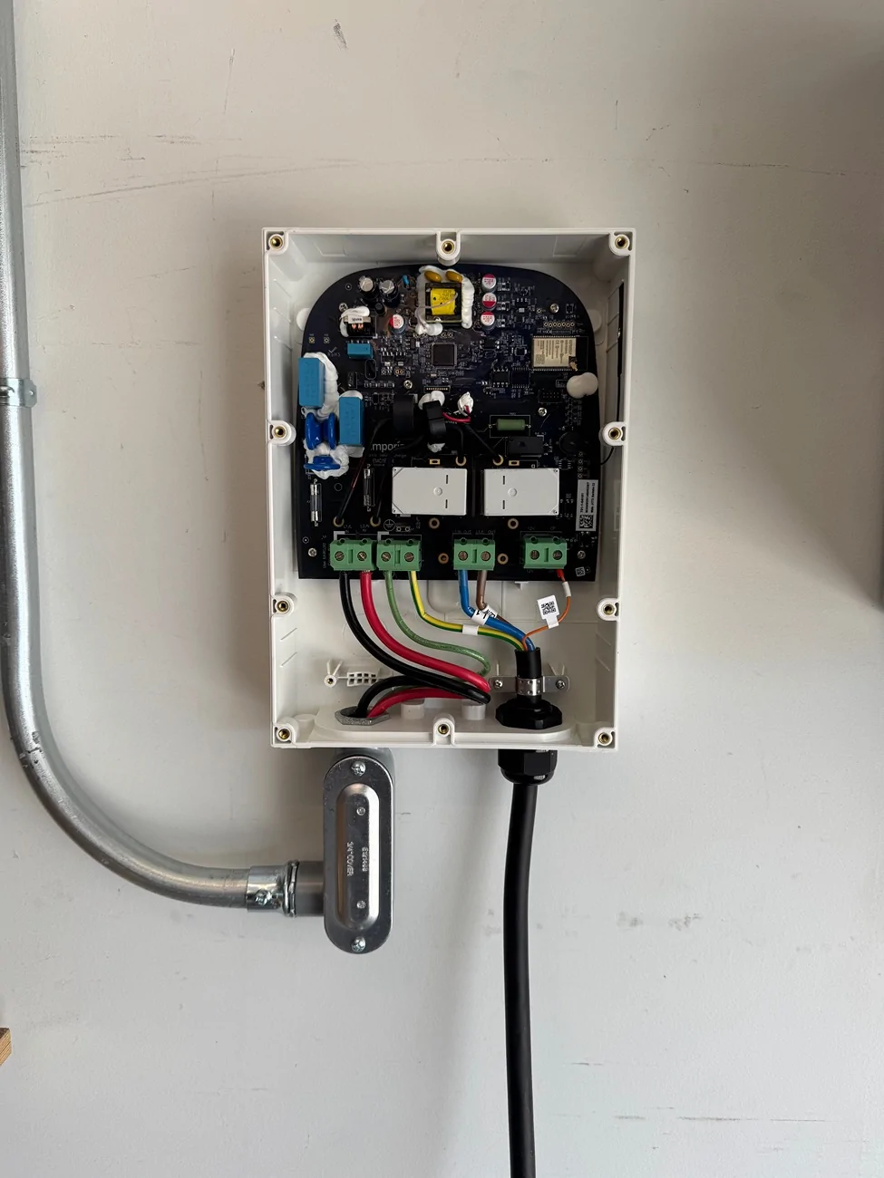

They used hard wall conduit for running my wiring, per code here. I needed an EMS module as part of my system (my incoming service is basically maxed out.) Emporia Pro was my choice because of the EMS module they have, and it also monitors my solar feed and sends any excess power to the car when/if required.

lovely install - super clean…

They knew what they were doing... and I watched them the entire time... haha. Actually it was a really good, professional installer that did the work. Very pleased, and so was the city inspector.
