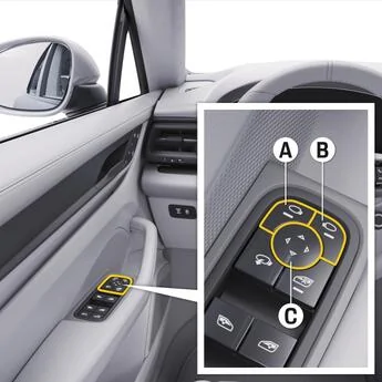

Are the side mirrors supposed to swivel down when reversing? is it only the passenger side mirror that swivels?
the directions in the owner's manual don't really make sense to me and i can't get it to work.
if this is anything like the Taycan it is only the passenger side mirror that tilts down when reversing. You have to enable it in the PCM and you have to then set the mirror angle when in reverse as a setting.
awesome just tested it out. It was exactly as you described, thanks! sucks it’s only on the passenger side though ?

Thanks for this, looks like no need to go to PCM, although it reads you can adjust both it seems to be passsenger only:
Swivelling down mirror glass as a parking aid
The mirror glass on passenger’s side swivels slightly downwards when gear R is engaged to show the kerb area.
Electric Macan EV Handy tips when driving the Macan img17b598ee6160f8588d24c0b320db4fef_1_PNG150
Fig. 1 Swivelling down mirror glass as a parking aid
  • Readiness for operation established
  1. Engage gear R.
    The indicator light on button B (Fig. 1) for adjusting the exterior mirror on the driver's side lights up.
Individually adjusting the position of the lowered mirror glass
  • Gear R is engaged
  1. Move the exterior mirror glass to the corresponding position by pressing adjustment button C (Fig. 1).
