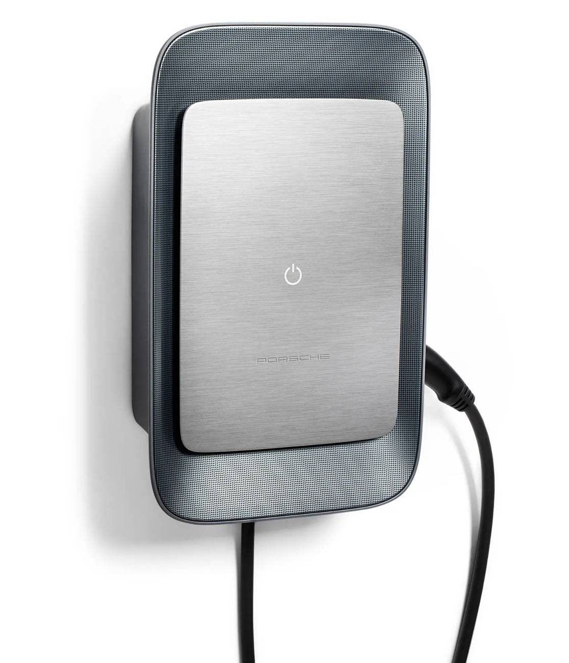

new Wall charger from Porsche - I have zero experience and haven't heard anything from anyone about this
https://shop.porsche.com/ie/en-IE/p/porsche-wallbox-9J1068210-B/9J1068210
Electric Macan EV Home charger recommendations? UK IMG_2384
  • The Porsche Wallbox combines timeless elegance with state-of-the-art technology to efficiently charge your Porsche electric vehicle at up to 22 kW. The Porsche Wallbox can be seamlessly integrated into the My Porsche app via the installed connectivity for full monitoring of your charging processes. In addition, among other things, the authentication media of the charging processes can be managed in order to avoid external interventions. 
    Technical data:
    • Charging capacity: up to 22 kW (AC)On the vehicle side: 7 m type 2 cable Connectivity: LTE, WiFi, EthernetInstallation: securely installed to a wall or pillarMonitoring: via My Porsche appAccess control options: RFID card, Plug & Charge, My Porsche appHas an energy meter Dimensions: length 59.2 cm (23.3 in), width 37.0 cm (14.6 in), height 14.8 cm (5.8 in) Weight: 9.82 kg (21.65 lbs)
  • Installation Services:
    Our recommended partners for home installation services can take care of your home charging installation, from checking your electrical supply to installing and configuring the Porsche charging hardware. This means you can charge your electric Porsche easily and conveniently from the comfort of your home.
    1Note: the Porsche charging equipment is only suitable for use with vehicles that meet the general standards and guidelines valid for electric vehicles. Compatibility is only guaranteed for electric vehicles with a type 2 connector. The charging time depends on the vehicle model, the vehicle's equipment and the country in which it is being charged.
Item no.: 9J1068210
attached install guide and owners manual from the website.

I assume LTE requires subscription. I wonder how much of the EVSE functionality requires a Porsche subscription.

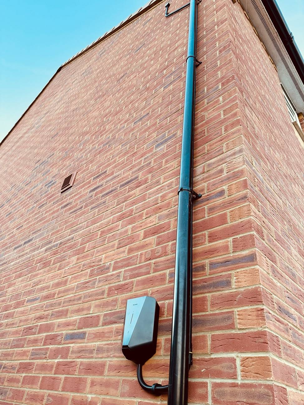

We ended up getting an Easee One fitted at home.
A last minute decision a week before we got our Macan. As I was expecting range anxiety after too much listening to social media comments and the Daily Mail.
Was a little more involved as our consumer unit is bang in the centre of the house not near any external wall. But the electricians did a pretty neat job hiding behind drain pipe, up into loft and then back down internally hidden in cavity wall.
Range anxiety never actually been an issue. So we have only actually used it a handful of times as primarily charge at work - but works fine, simple app and I like the tether-less setup.
