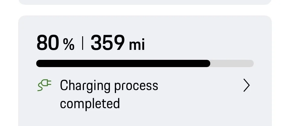

My SOC -> Displayed Range calculation is broken the other way.
Electric Macan EV Issues with Macan battery and range IMG_7986
360 miles range at 80% is outrageous! This implies a 100% range of 450 Miles (not km!). My consumption is under 3 m/kwh at this time of ye. (It does drop by 40 when I put it in gear to drive, but thats still too much)
My dealer is not concerned, but I think this is an indication of something not right.

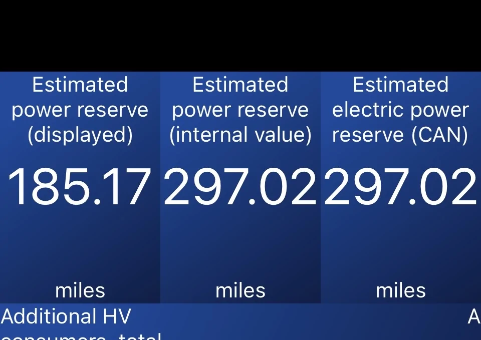

From CarScanner, I did see these 2 numbers. It looks like the display is using the middle number, when the one on the left is more realistic
Electric Macan EV Issues with Macan battery and range IMG_7921
For now, the only thing I can use reliably is the consumption of each trip to manually calculate possible range. The range display is essentially broken
