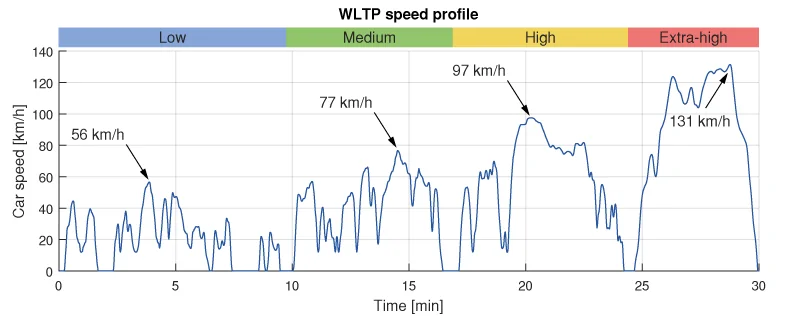

this is not how wltp works. google helps
Electric Macan EV Macan 2024 vs 2025 massive consumption difference? image-263
Speed wise it's a 30min test, average speed is 46km/h, as you can see from the graph speeds over 120km/h are not even 10% of the "trip" (<3min). It's not hard to see why the WLTP "range estimate" does not translate well to highway driving where most of the consumption for EVs is.
