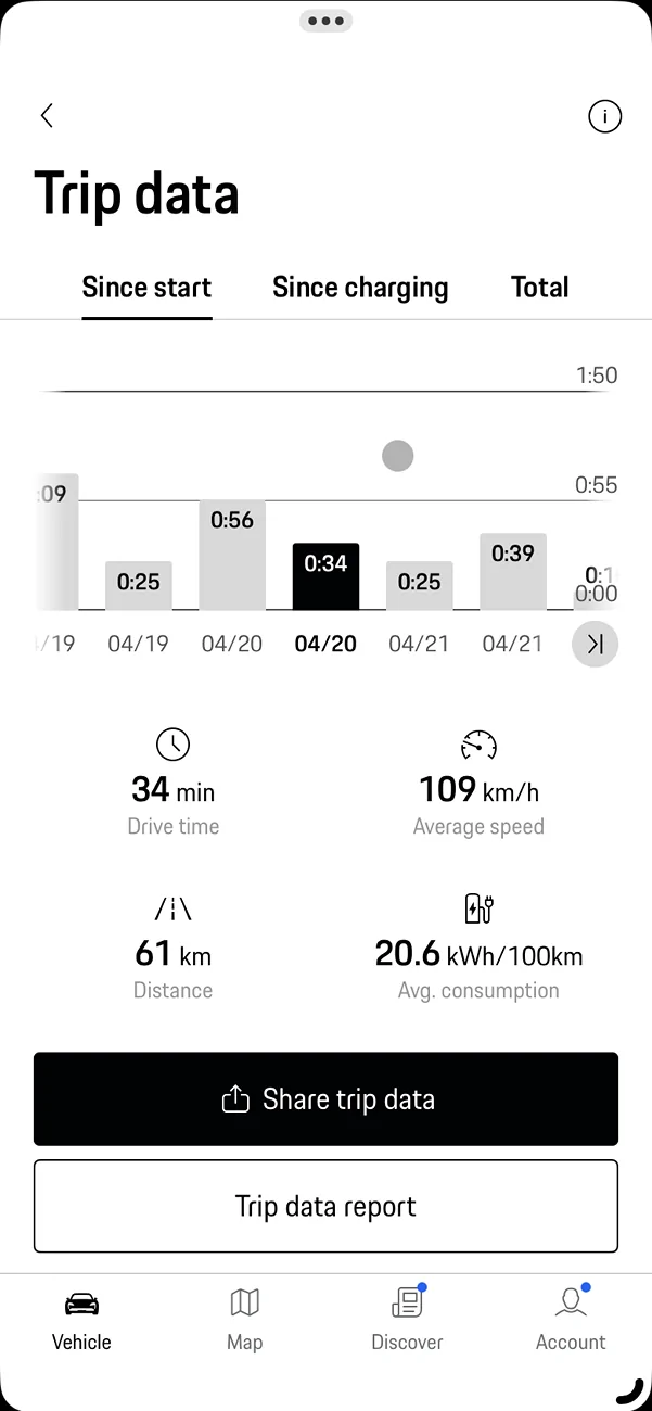

I can easily beat the 27 at 120km/h and sometimes go as low as 20kwh/100km In fact in my daily drive where I have some slow 10km part that brings down average quite a bit but with stretches of well over 120 for the rest I have 22 with head wind and below 20 going back …
Like the test of the iX, well over 320 in winter but I never get that figure … so hard to compare …
Here 10km off highway with traffic lights but blasting well over 120 on 24km of highway under good conditions, turbo on 20 inch wheels

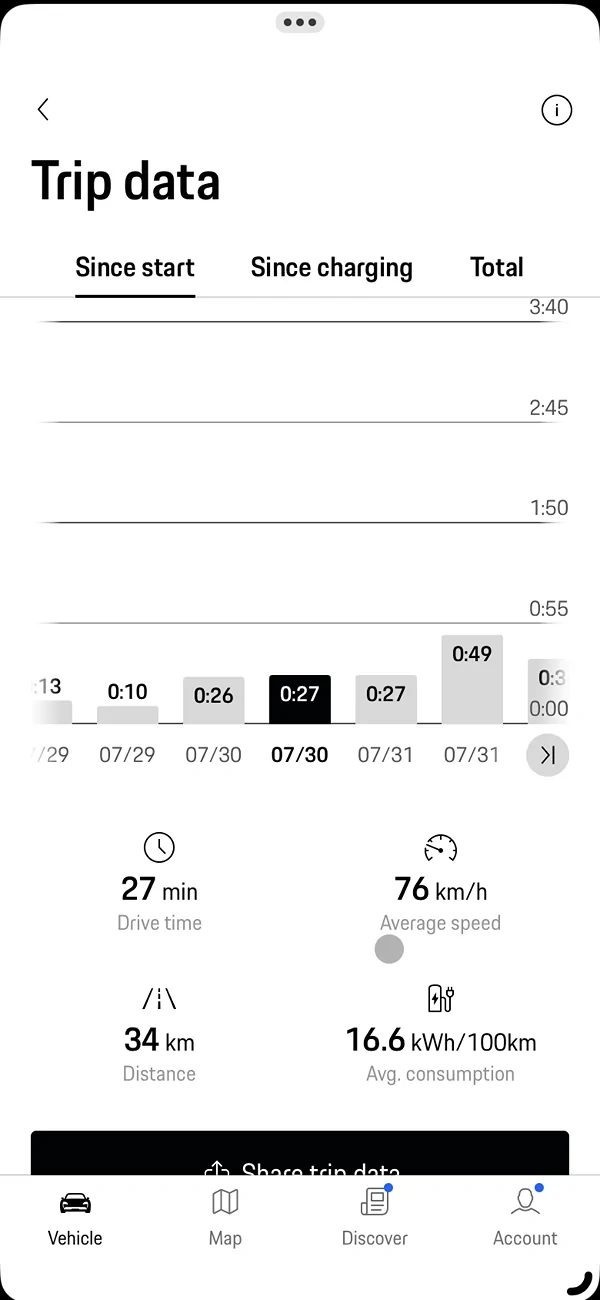

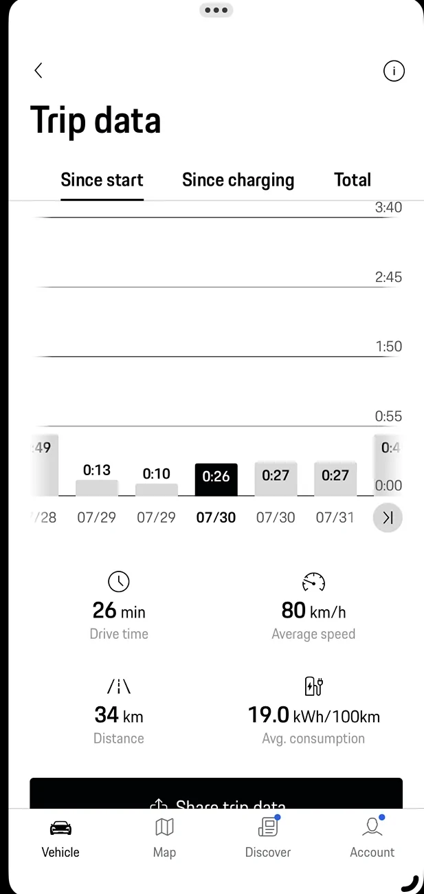

And the reverse in the morning a bit colder and head wind
Electric Macan EV Macan 2024 vs 2025 massive consumption difference? 1754063388208-ay
Electric Macan EV Macan 2024 vs 2025 massive consumption difference? 1754063263668-7i
Not possible in real conditions unless going downhill, wind behind you, drafting, etc.
The trips you posted have an average speed of 76 & 80 km/h that is why your consumption is so low.
If I drive at a constant 120 km/h in highway traffic my average speed drops to 100 km/h by the time I reach my destination. That is not 120km/h, that is 100km/h.
Bjorn test are close to real 120 km/h average speed, he also increases speed to match GPS speed, 120 km/h in my 4S is only 115 km/h on my phone, my other Porsche does 118-119 km/h GPS when set to 120 km/h (it jumps between 120-122 km/h as it is an older cruise control unit).
The numbers Born posts are accurate in my experience with different EVs.

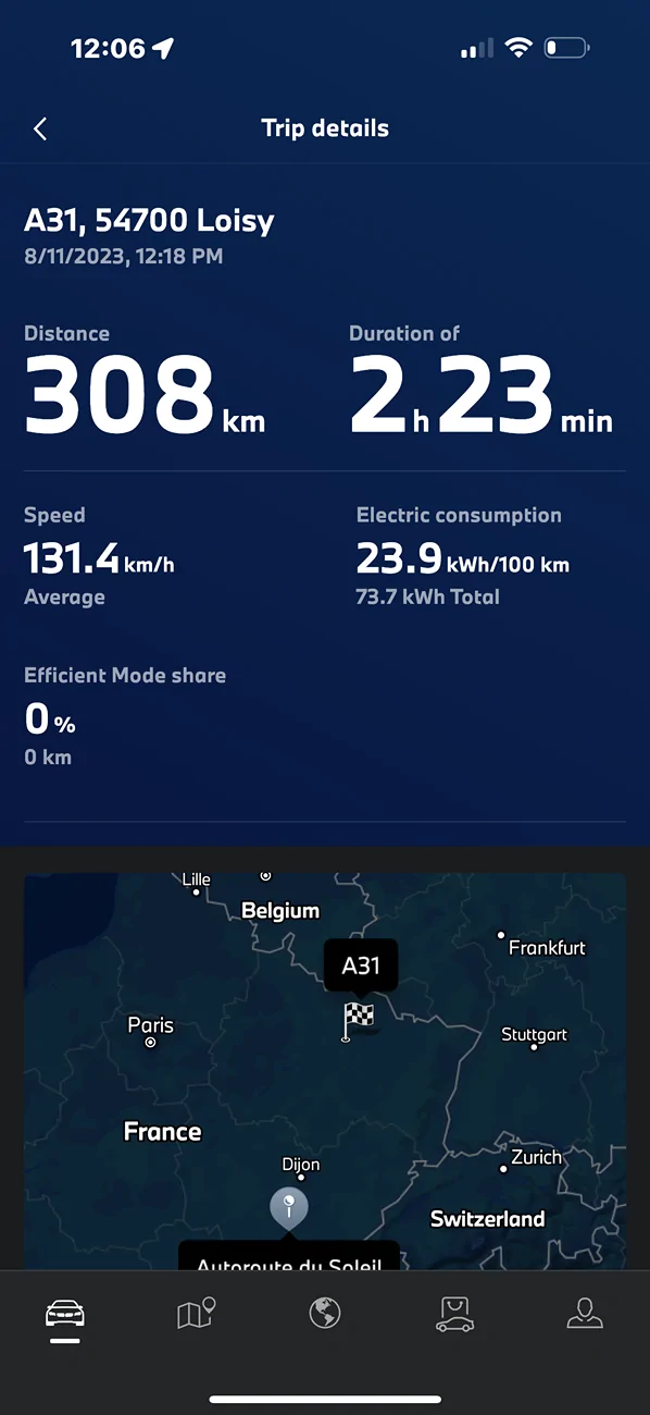

Or this … lots of overtaking so 150 to 160 to get to 131 average

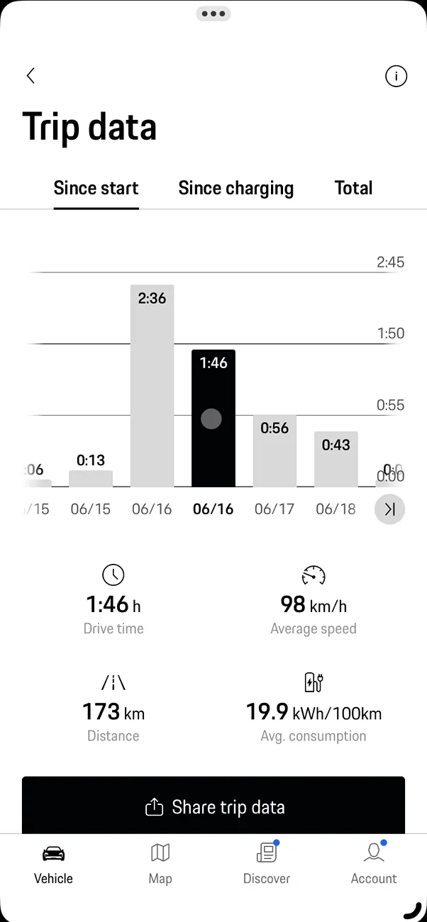

And one more … I find the iX and Macan quite efficient at high speed … way more then what Bjorn finds … as long as you have nice temps, as soon as it is 10C it gets worse rather quickly So him posting figures on German cars in bad conditions is a trend ;-)
