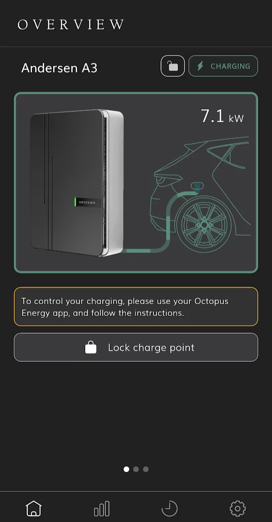

For those of us with Andersen chargers they have now added compatibility with IOG. All chargers Including A2 from 2023->on.
I used to have IOG control the car instead of the charger, and as as we all know, it is super unreliable and will charge the car outside of the arranged off-peak slots.
You will need to remove the car from IOG and then add it is a new vehicle again. Note that if you select your Andersen charger and car as a Macan it will default to controlling the car instead of the charger. Not what we want. I got around this by choosing a car I knew could not be controlled by IOG, my previous car the Fisker Ocean! Then IOG logs into your Andersen account instead.
Andersen app shows this for the first time below. The charger now only releases power when it gets a slot from IOG, not the instant that the car is plugged in. Finally!

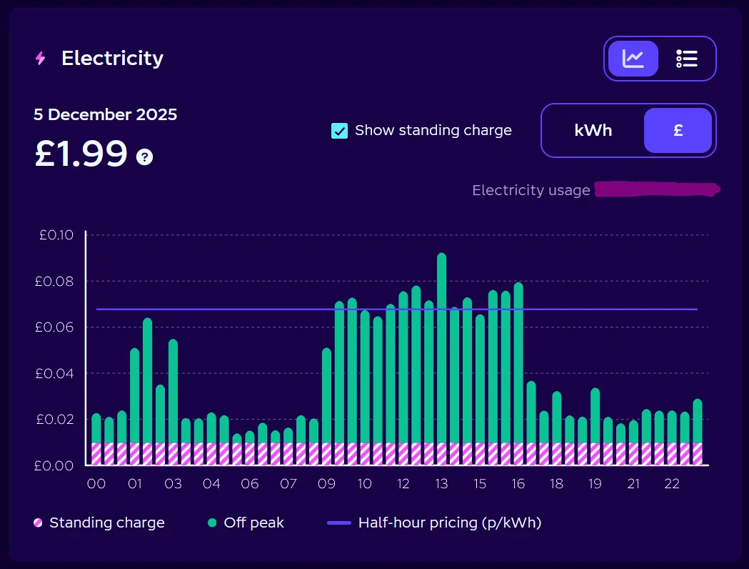

What is this peak rate you speak of? 😁
Electric Macan EV Macan 4 EV - Octopus intelligent sync issue 1765191683366-62
I know it will end in January and we will only be allowed 12 hours per day total, but until then...
100% agree! Now I have solar and batteries, it's no longer a concern as the off peak octopus charges my batteries and all the solar gets sold back to the grid. But people without solar/batteries can flex the cheap rate during the day by 'creative' use of plugging the car in and adjusting the level of charge... Until they change things next year... :-(
