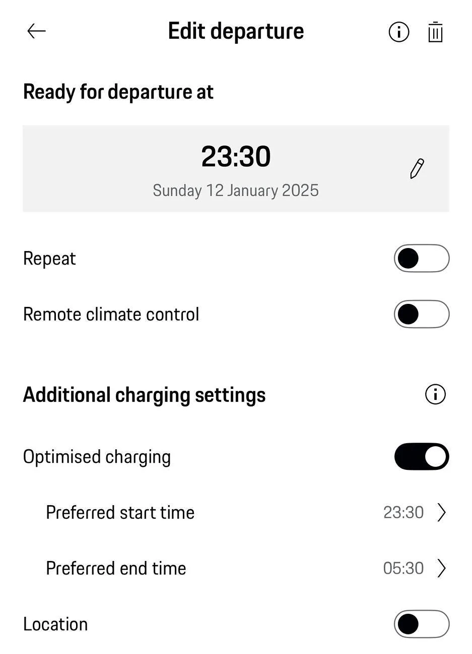

Yep - not sure where the issue lies either but I have reverted to letting the car schedule the charging at roughly the times when Octopus rates are lowest. I have disabled Octopus and Easee intelligence and just let the car draw the power between those times.
I have noticed that, if I say charge between 11:30pm and 5:30am and be preconditioned for 7am it is still charging between 5:30 and 7am (which seems wrong to me) but I have become very frustrated when trying to get Octopus and Porsche App to talk consistently.
