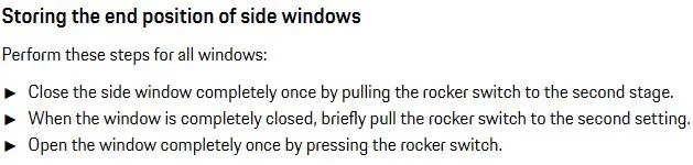

mmm pretty sure it's a framless window thing. My 2001 audi has it.
but the reprogramming is for if your window isn't moving at all when you open the door.
the distance the window drops when you open is set...can't be readjusted.
but yes, if your window isn't dropping when you open the door, then yes, this procedure should restart it

I had this issue, reprogrammed the windows as others have said and it now makes for a much nicer experience getting into the car!

This could be a PDI error - not properly set prior to customer handover.
