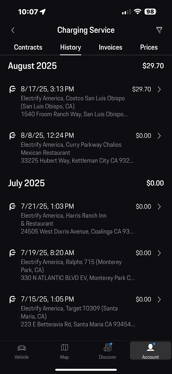

When I purchased the car, I was informed that Porsche would pay for the first year of our charging at Electrify America. Thus I was surprised when at the end of a charging session yesterday at EA Costco in San Luis Obispo, we were charged for the charging session. I had charged at this same station a few weeks back and was not charged at all.
Checking on the internet, I see notations that EA no longer owns the EA stations at Costco (?) Yet, the locations still shows as Electrify America station on my Porsche app. So why should this transaction affect us as drivers as to our free charge usage at these particular EA stations? The agreement of first year free charge at EA stations was between Porsche and us as the customers. Not an agreement between us and EA.
As a matter of principal, Porsche needs to honor their word to the customers.

Yes, some EA stations are EA branded but not EA owned. The free charging deal from Porsche is presumably limited to the EA owned stations. (Although some other owners still choose to participate, but apparently not Costco.)
If you check the EA app/map, it shows the ones that aren't owned by EA in a different color, with the caveat that "Some pricing plans are not accepted at this site", with more detail in the Pricing tab.
Just need to check beforehand. Also note that the Costco ones don't accept Pass+ discount either.

Costco hosts some Electrify America sites that are owned by Electrify America (like Santa Barbara) and some that are owned by Costco and managed by Electrify America (like San Luis Obispo). If you’re physically at the site, you can easily see these as they’ll have a Costco brand on the charger itself. If you look on the app, you can easily find these as they show as a teal colored pin as opposed to the standard blue pin in the map. This is true for all Electrify America commercial sites that don’t generally offer the 25% pass plus discount rate nor do they have free charging for Porsche or any other auto maker as the site is owned by the vendor and not Electrify America. RMP (Rocky Mountain Power) own many EA managed sites, a notable one is just outside Arches National Park. Of course I appreciated having the free charging when I had my Taycan but now with my 2026 Macan EV combo and offer no free charging it’s a moot point.

I was confused by this a few months ago when suddenly the number of EA stations in our metro area tripled (good!) and then found out they (light blue) are “partner” stations that are operated by EA but owned by others. The owners set the rates.
