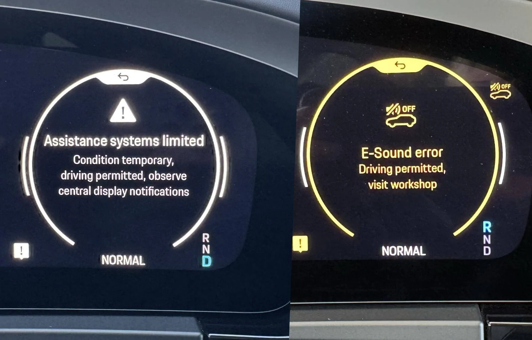

For the first two months with my Macan 4, I received no error messages. In the last two weeks, I have seen two. They dismiss and do no return after a power down period. Has anyone else had this? Also, I have no idea what 'visit workshop' is referring to. Dealer?
Error 1: Assistance systems limited is common if sensors are dirty or obstructed. I would wash and dry the car and if it persists then it means you have a sensor issue not communicating with the Assistance module, which is not good, if it has to do with Warn and Brake feature which is automated braking.
Error 2: There is something wrong with the E-Sound (different from Sports Sound) which is standard sound required by law to notify anyone around that there is a car coming, since EVs are not loud enough to be heard. Visit workshop is Porsche's way to saying, visit the Dealer.

For #1: completely agree, snow, dirt, sometimes water/rain... this occured on the ICE macan's 2021-2023 as well. I had this during a snow storm.
#2: haven't had this issue yet.

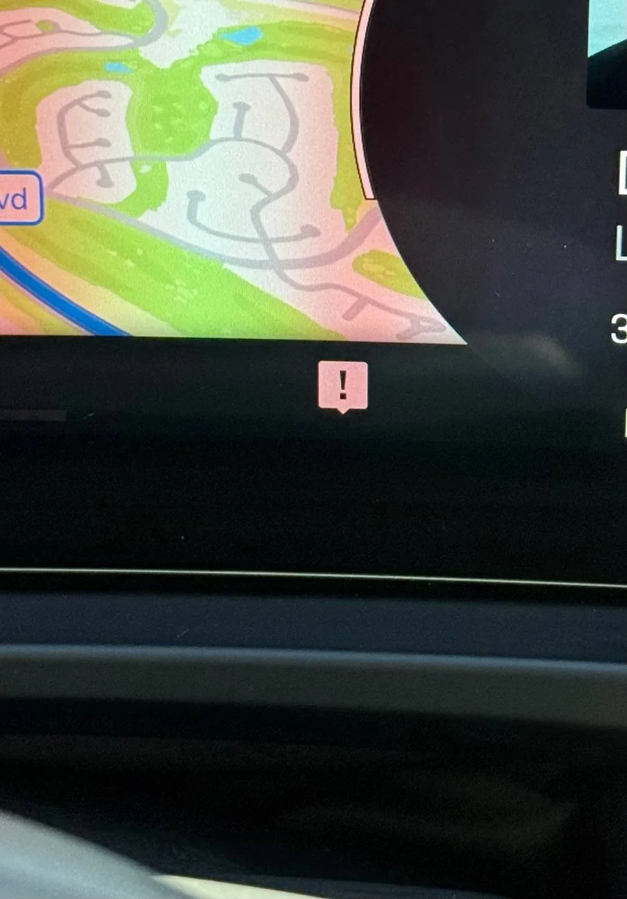

Same happens to my 4. Randomly popped this message.

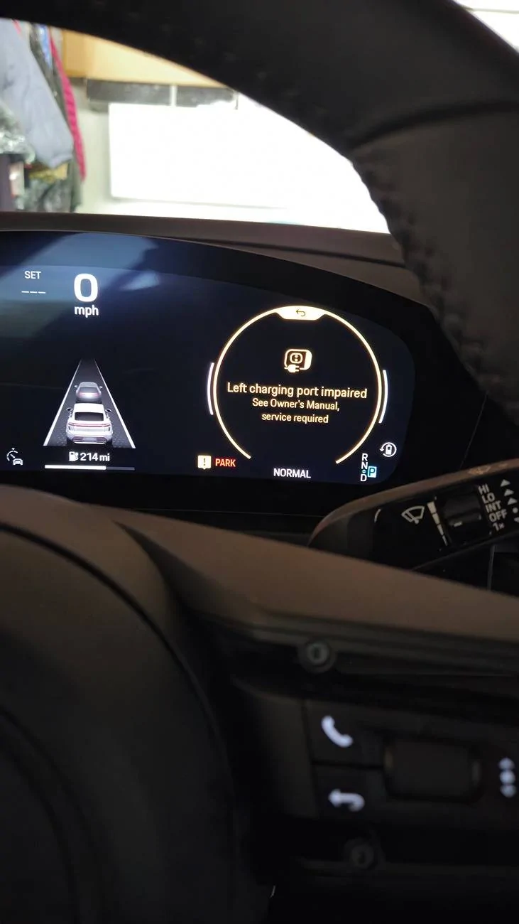

The same alert popped up for me after picking up my software updated Macan from the dealership, no message starting what the issue is. Haven’t stepped back in after power cycle to see if it’s gone.
