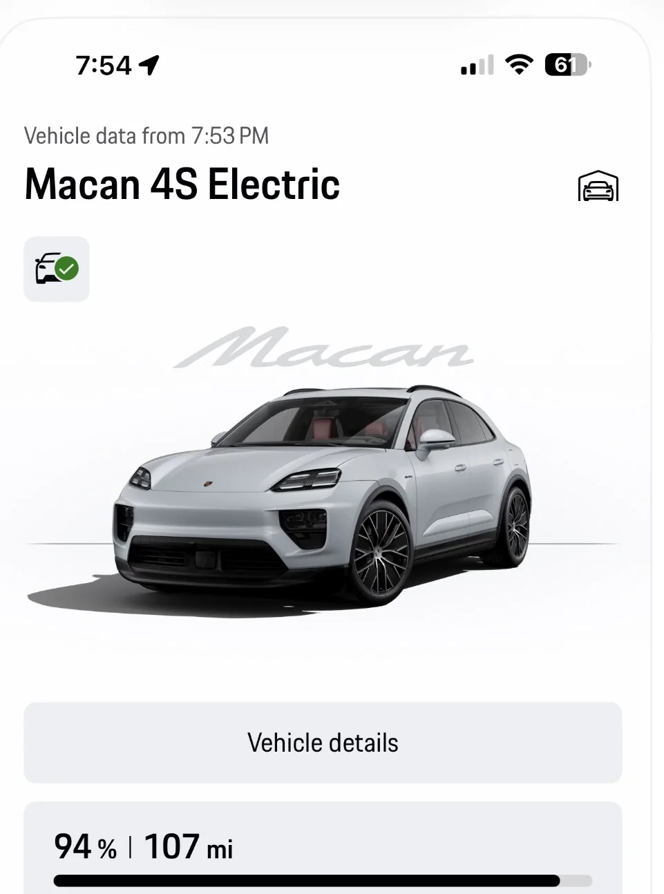

Hi,
i’m having an odd issue on my 2025 Macan 4S.
I came back from a little over a week vacation. The car parked outside the whole time with temps in the teens and a couple 0F days.
Anyways, I came back and that’s when I noticed this issue… I charge the car up to 80% like usual and I only was seeing about 82 or 83 miles of range. Very abnormal because in similar temperatures I have seen about 180-200 miles of range.
I drove the car a little bit and the range went down as normal and so did the state of charge.
What could be going on here? The range number is way off from what it should be.
i’m gonna try charging the car up to 100% to see what happens but so far it’s still abnormal… see screenshot below.

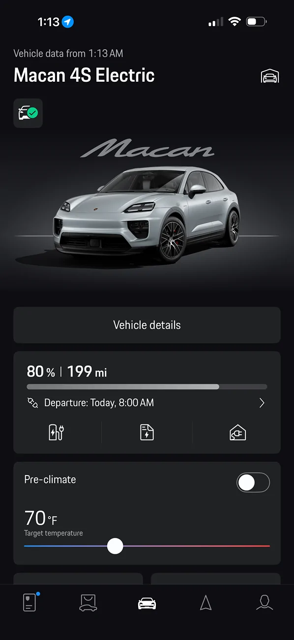

Interesting. I also just noticed this on my 2025 Macan 4S. Not as severe as what you’re seeing, but I’d typically see around 240 miles of range at 80%. Now I’m only seeing 199 miles at 80%. I’m in California and while it’s been cold, it’s definitely not freezing. Not sure what’s going on.

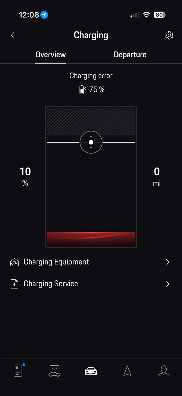

After a 22 mile drive today, mine is reporting ZERO miles left with the battery still at 10%
Its 5C with the battery pack at 7C.
