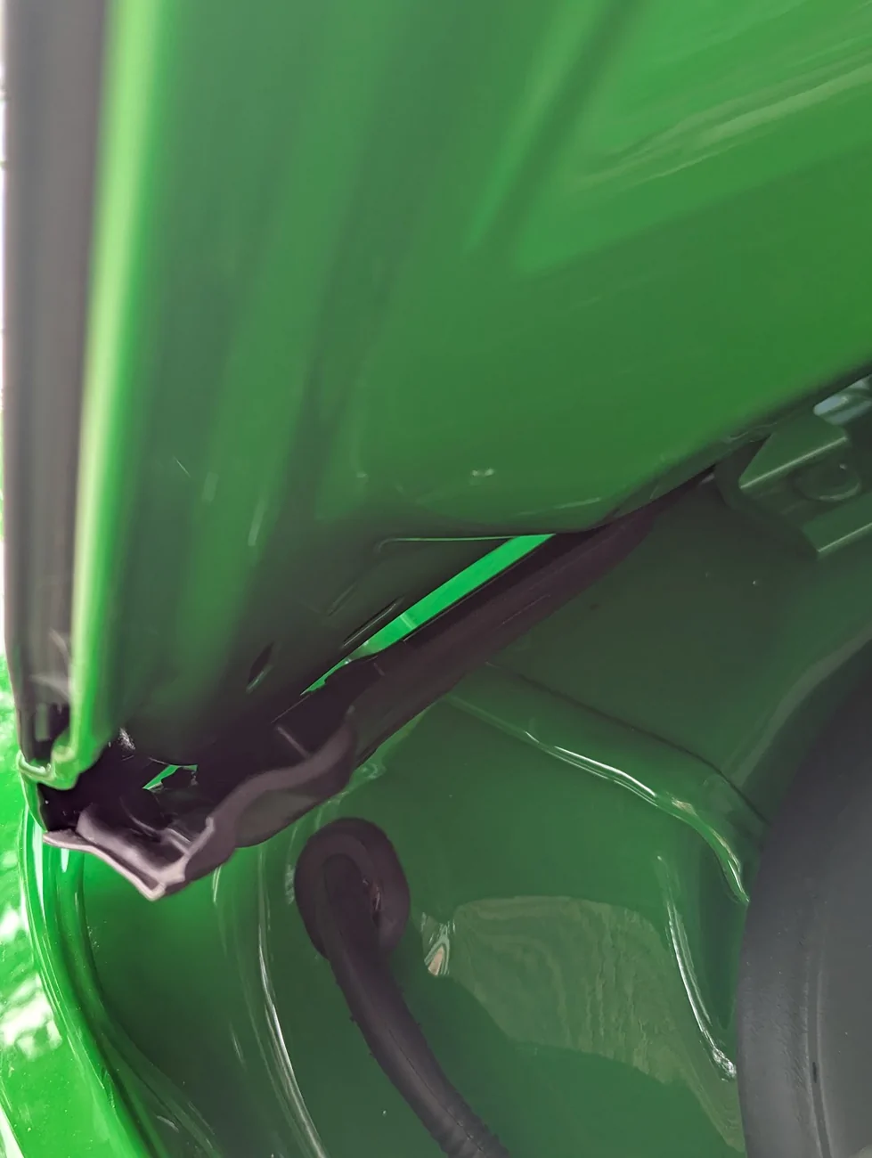

I had a problem where the upper left trim piece that was supposed to shield from water, had a manufacturing defect, and got pinched when closing. I imagine this could have caused water ingress. Eventually it fell off entirely. Service ordered a new piece, and it's worked well ever since.
Electric Macan EV rear cargo hatch door dumps rain water in boot (trunk) cargo area when raining 1758306126355-nc
Electric Macan EV rear cargo hatch door dumps rain water in boot (trunk) cargo area when raining 1758306143789-c8
open the back hatch, top-left trim in the actual hatch. Check if this happens to you? It could be more than just a one-off.

So water does not get into your trunk on rainy days?
The dealer fixed it. These images were from before then, but, this being July in Northern California, "rainy days" wasn't a thing :)
