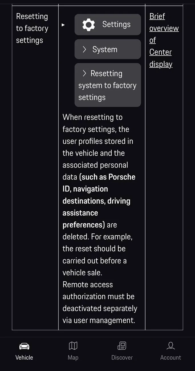

Resetting/restarting the PCM by holding down the volume button did not fix my Departure problem. I had to do a factory settings reset. Just make sure you take pictures of your PCM settings before as you will need to reorganize your tiles again (it was kind of irritating as I didn’t remember exactly how I had set it before, lol). You will also need to reprogram your HomeLink.
Ok thats the process I thought you were referring to.
I'm going to try plugging the car in tonight and see if it's still screwed up.
But yeah that will be annoying to reset everything Ugh.
