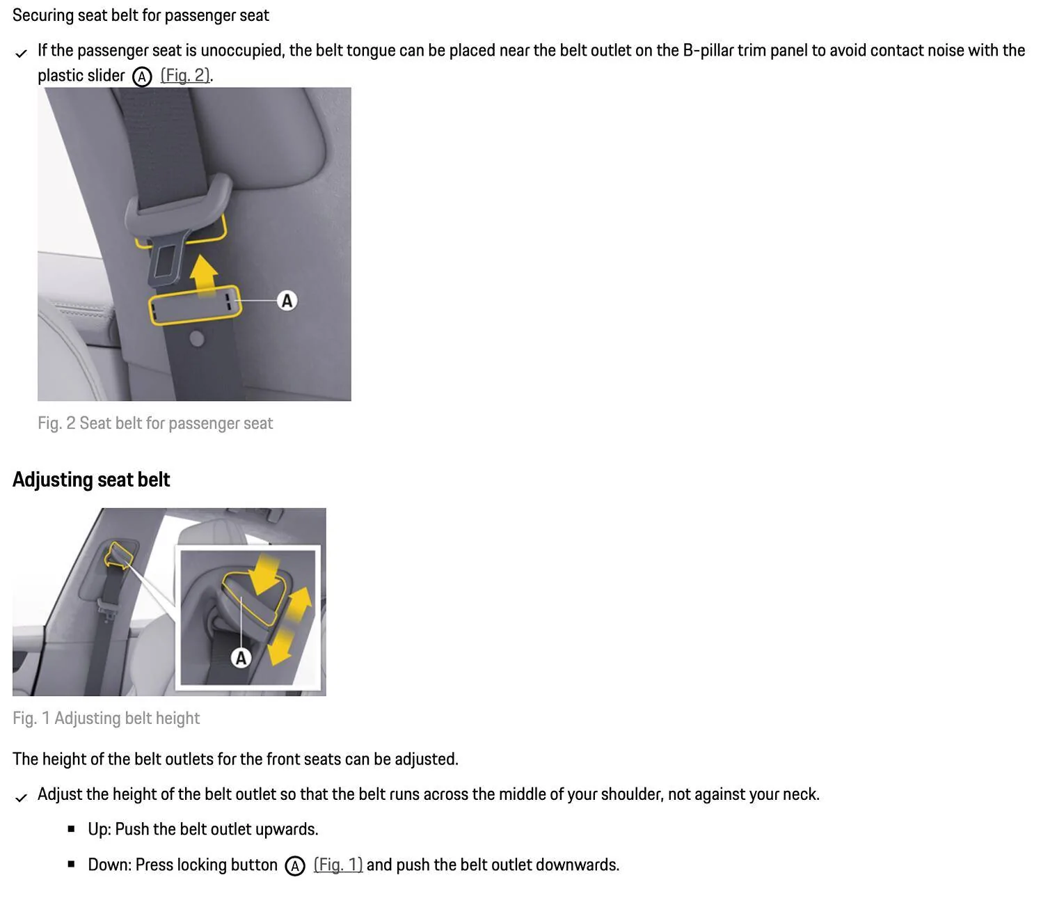

This is mentioned in the owners manual. Move the buckle up around where the seatbelt height adjustment mechanism is. It will stay put there and will not rattle.

I know the picture in the manual. This clamp that is standard on the Macan on the belt of the passenger seat does not clamp well and does not stay in place well, which often causes it to sag down so that the belt still starts to rattle.
