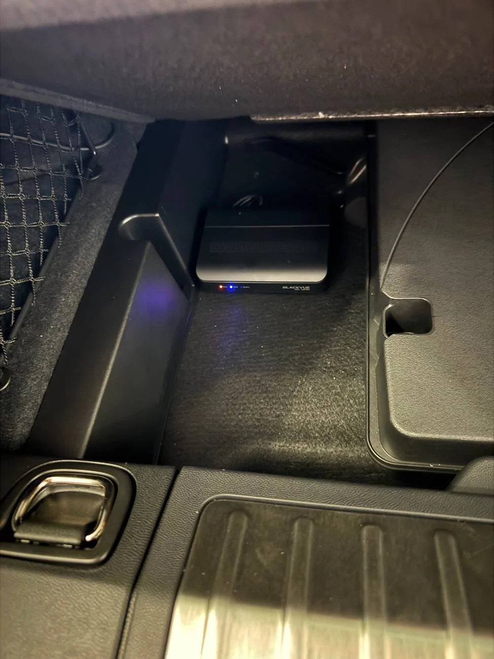

I wanted an option that wouldn’t rely on integration with the battery (direct) so chose a Cellink Neo8+ Dash Cam Battery that uses 12V to top up as required. According to specs I can expect up to 22hrs run time on the battery itself (but haven’t fully performance tested yet).

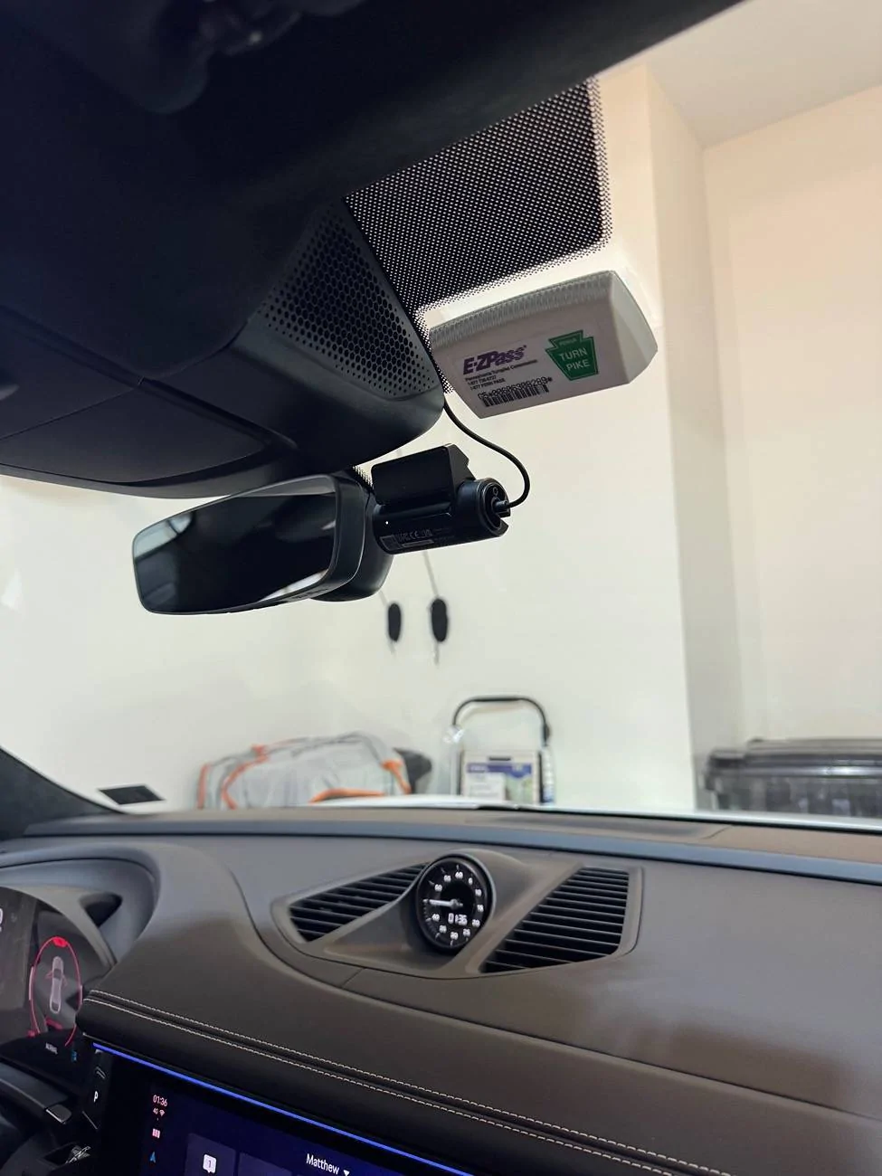

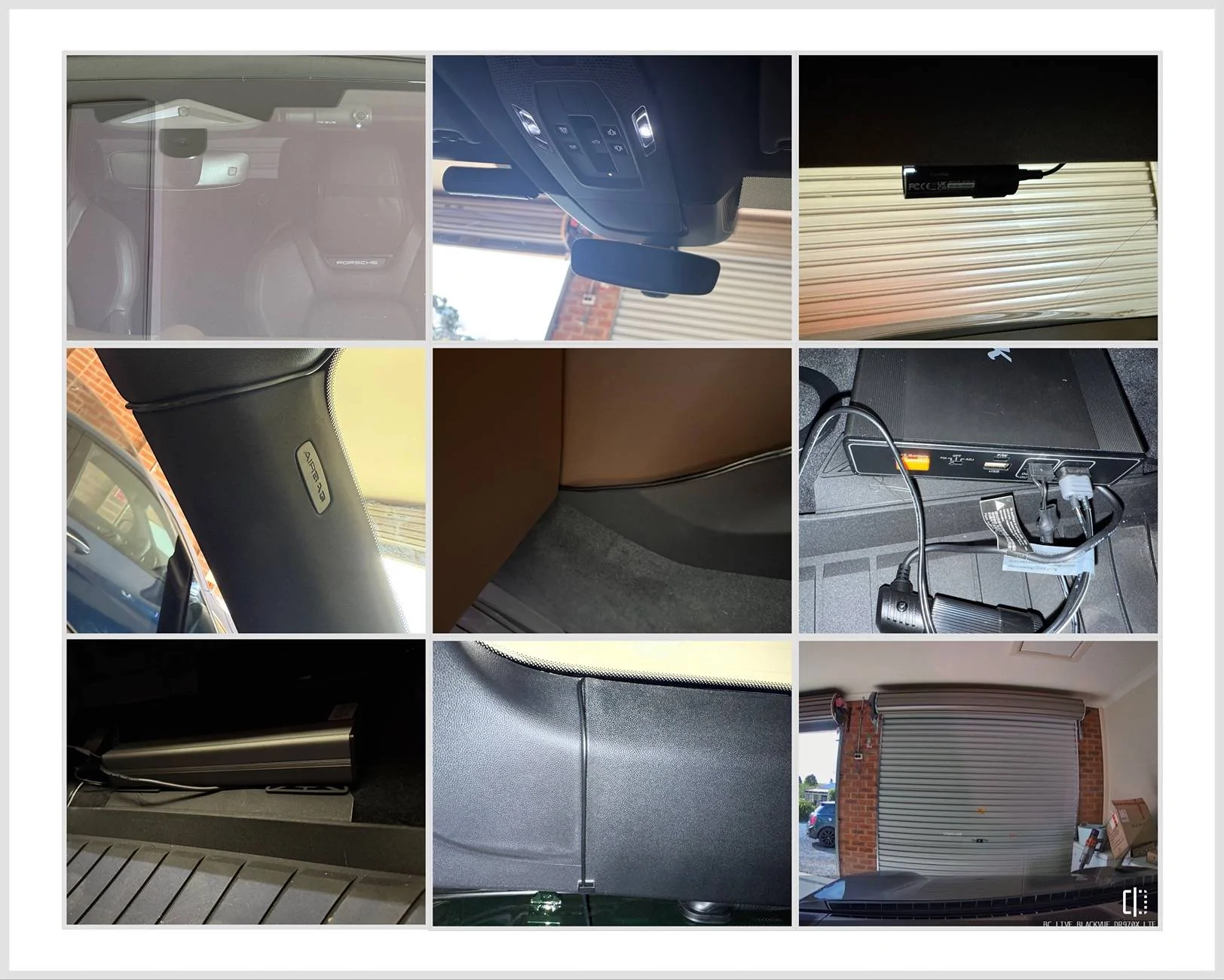

Re front camera, I installed to the left rather than under the mirror to not affect general visibility and when you look from the front it doesn’t stick out. Cabling wise was fine, I have posted a few photos of where I haven’t yet pushed right in, but wanted to show location. Battery sits under front passenger easily and I led the wire up to the 12v. Very happy overall. A auto-electrician was a bit of overkill in my opinion as it was ultimately just a 12V but a few suppliers quoted $400-600 AUD.

One word of caution- be careful wrapping cords around the pillar like that. If the airbag would deploy, you don't want to interfere with it or cause your dashcam to become a projectile

Ah perfect, thanks for the tip re pillar. I have the flexibility to move thankfully so will do so!

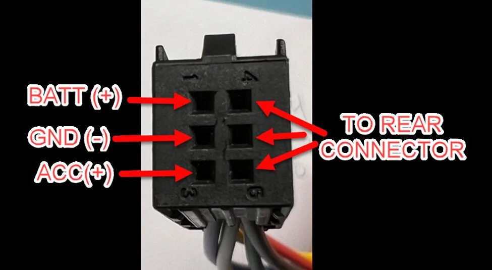

HI, I also installed the Blackvue dash cam (front and rear) but using the Porsche pre-wire option for power. This provides the parking mode power.
You just need to buy a dongle adapter on eBay for about $8 to be able to tap the dongle from the pre-wire option located in the overhead console. That took about an hour.
For the back camera, I ran the Blackvue provided wire along the roof/doors, and detaching one of the rear hatch top panel so the wire comes out between the panel and the glass. That too about 10mins.
NOTE: The pre-wire option requires installing 2 new fuses: 1 x 10A in the from fuse box (Funk) and 1 x 5A in the passenger A-pillar fuse box. Without those fuses, there is no power to the pre-wired dongle.
Dongle link: https://www.ebay.com/itm/176803643168
Wiring details for dongle: Only pins 1,2 and 3 are needed to be wired to Blackvue.
Electric Macan EV Sharing Exp- installed BLACKVUE DASHCAM – DR970X-2CH LTE 1744045830612-lr
  • Pin 1 - BATT is a permanent 12V positive (actually typically 13.8-14.4V)
  • Pin 2 - GND is ground or negative terminal for 12V
  • Pin 3 - ACC is switched 12V positive
Porsche instructions for OEM camera mentioning the 2 fuses needed: https://static.nhtsa.gov/odi/tsbs/2024/MC-11011672-0001.pdf
