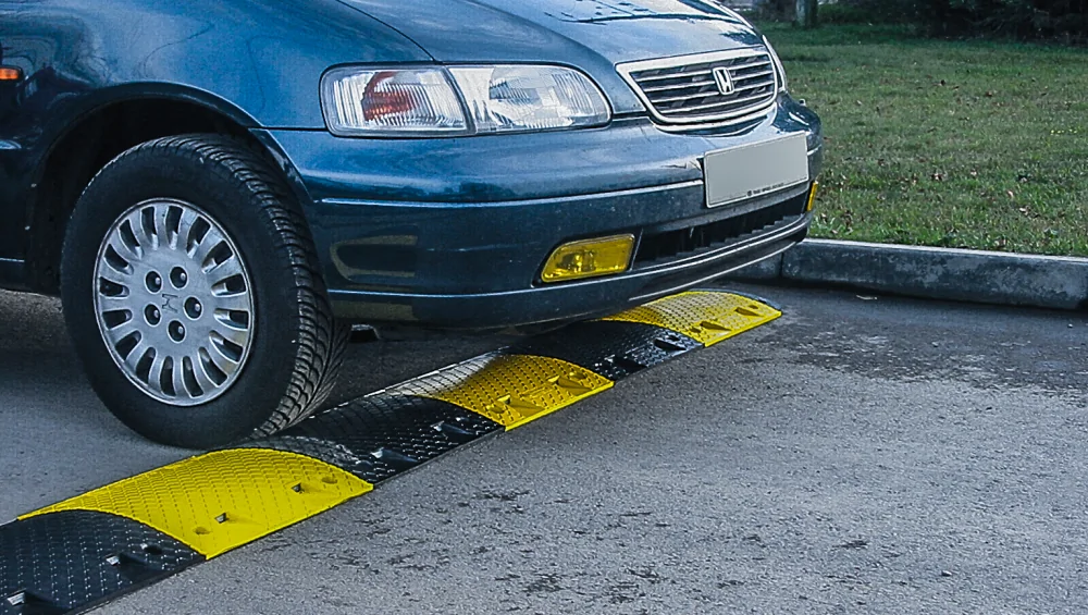

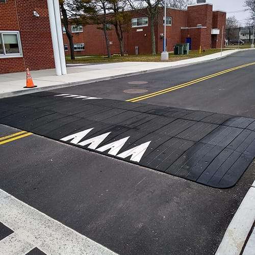

@TomekGnomek Tomek, must be a specific type of speedbump for the sound to be heard or just passing over any type of speedbump,road bump or road physical anomaly will make the sound audible?
Any speedbump or road imperfection (like a pothole) will do.
Some make it worse than others but key is it happens after breaking.

I’ve driven over all manner of speed bumps and have not yet experienced the thud
