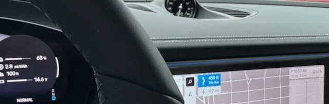

I did the calibration reset and my car no longer claims that I can drive 460 miles on a 100% charge.
However, the navigation is still confused. Here I am navigating the 5 miles to the dealer. 63% SOC at start, estimated to 52% at arrival 15 minutes later. Not a problem around town, but road tripping becomes a bit more exciting with this mis-match
