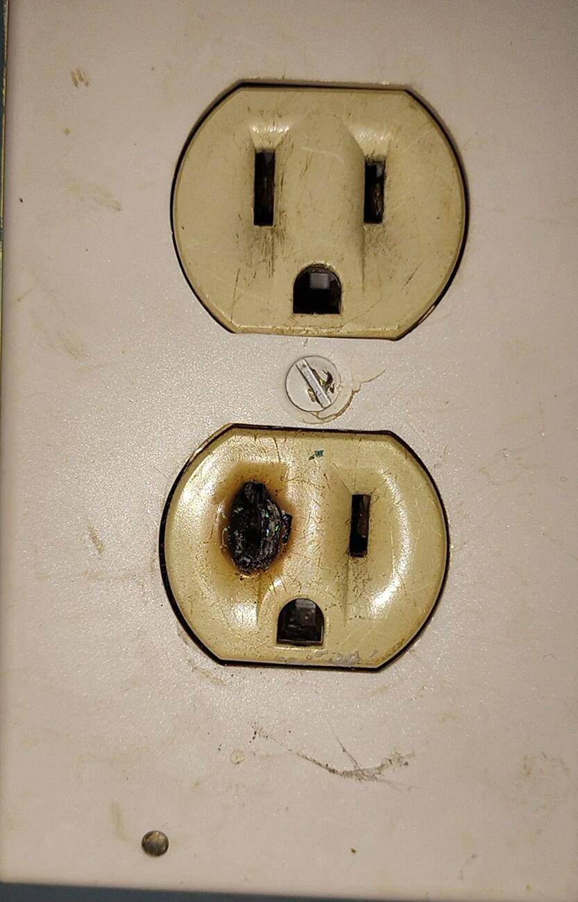

* - also I believe the PMC/PMC+/PUC default to 50% charge rate on 120V outlet (this is for safety given the wide range of residential circuits in North America) - that means if you plug in a PMC/PMC+/PUC with a NEMA 5-15 power supply cable (household outlet) you will not get the "full" 1.44 kW capacity (which is maximum power for an EVSE on a normal North American residential circuit) - you will get 50%. of 1.44 kW or 720 watts or 0.72 kW - this is a difference between different EVSE's - and again can skew the numbers - which as we've seen can already be hard to compare…
the Chevy Bolt will enforce 50% charge rate from _ANY_ 120V/L1 EVSE and therefore will charge even slower than possible when using any L1 (120V) EVSE - this is from painful experience for GM/Chevy with Volt and other EV's where they learned that not all residential 120V circuits/outlets/wires/breakers are equal - and sometimes expecting optimal/ideal behavior from your typical residential home outlet is a bad assumption…and can lead to bad outcomes…fires, breakers tripping
120V outlets in North America are typically shared (multiple outlets sharing a single breaker) and as we all know sometimes the microwave is on the same circuit as the dishwasher - and adding a max power EVSE to the same circuit will simply cause the circuit breaker to trip constantly because the EVSE is consuming 80% of the available breaker capacity (1.44 kW) and then if the microwave is also turned on while the EV is charing that's another 1000 watts (at least maybe 1,500 watts) which is a total of 1.44 + 1.2 kW or 2,600 watts total - which is over current for the max rating of the circuit breaker (1.88 kW) and the circuit breaker does what it's designed to do and trips - causing the EV to stop charging and the microwave to not finish the pop-corn.
residential circuits are fraught with problems for EV charging and most are 20+ years old and were never designed/installed to run for 12-72 hours at full capacity…if you plugged in a 0% Macan and charged to 100% on a NEMA 5-15 outlet it would take 70+ hours to fully charge…
I promise you most/nearly all of the existing 120V circuits installed in North America are not properly provisioned to run at a full unrelenting 80% capacity for 70+ hours straight…it just wasn't part of the thinking for that type of usage…
for that type of usage you need:
  • dedicated outlet - no shared multiple outlets on the same circuit breaker
  • commercial/industrial quality NEMA 5-15/5-20 outlet
  • commercial/industrial quality breaker
  • 12/10/8 gauge wire - most residential circuits are 16/14 gauge wire
  • all copper wire - not aluminum
  • dedicated ground
  • dedicated neutral
few if any existing residential NEMA 5-15 outlets meet the criteria listed above - and therefore are quite dicy to use for EV charging that can last for 12+ hours at nearly full capacity with no reduction in capacity demand during the charging session…
I recommend installing a properly designed dedicated circuit for charging an EV at home - it's the only way to know that everything is "up to snuff" in terms of being able to handle the load with out failure…and failure here means a likely outcome is an actual fire while you're sleeping because you mostly charge your EV overnight when power rates are lower…
really honestly this is not what you want to wake up to in the morning because you're using an existing 120V circuit that is shared with 6 other outlets to charge your EV overnight
