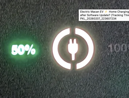

This may be irrelevant or I may have missed something here but, when you plug in the portable charger into an outlet, I think the white power light should eventually turn green to indicate when it is ready to charge. When you plug in the car, the indicator may first turn yellow and then flash green when its is charging. I've seen the portable not go into the ready state at one public outlet, but it is a small sample size..
50% is the default and it may only switch to 100% after the power light goes green when the charger is set to 100%.
You're right, that's how it should work.
At the dealership: It's 100% (not 50%). White line turns green when the connection is set up b/w the charger and the car.
At my home: I think it's yellow but may be the pic doesn't show it. It is essentially to explain that the charger isn't able to make the connection with the car. There is an error code associated with this, which Porsche NA team found useful. When you tap on to 50%, it can change to 100% (there is a sensor on the charger itself). I tried both, nothing worked.
