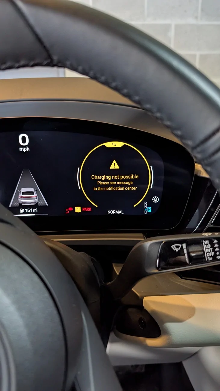

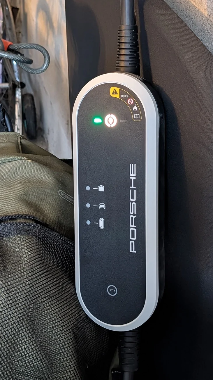

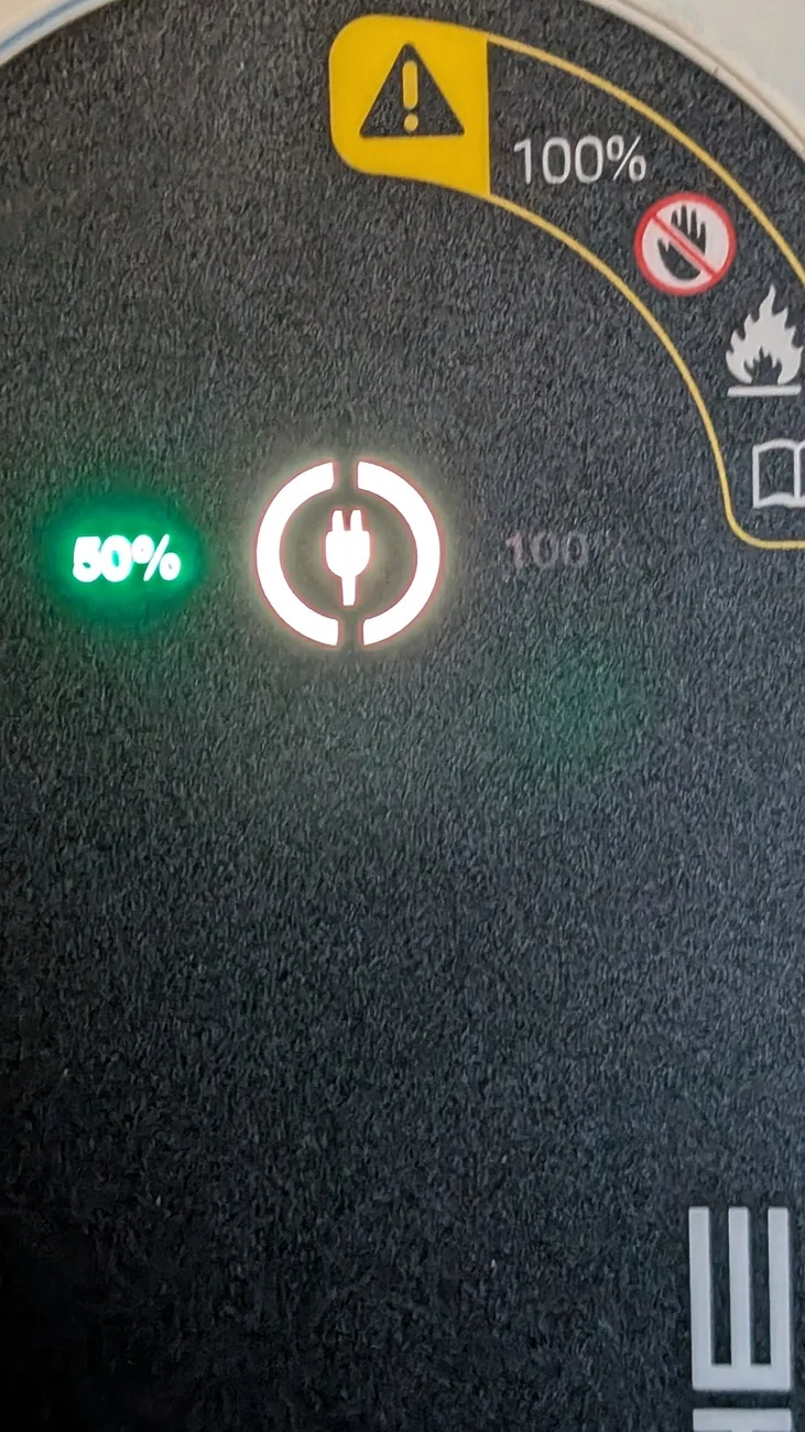

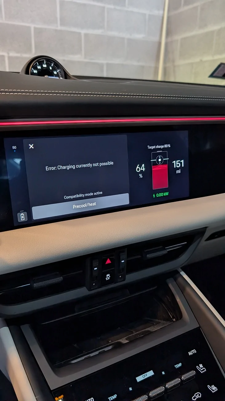

These options very helpful but couldn't resolve my issue. Tried everything.
My car charges at the dealership, my charger works at the dealership too but when I connect the charger at home, the charger lights 50% instead of 100% (picture attached). The dashboard says that it's not able to charge my car.
The car charges at the dealership with my charger and their infra and so they don't see any issue.
They recently replaced my charging port door which wasn't opening at all so now I can at least get my car charged outside.

It wasn't working previously either. They also just replaced the port's mechanical door.
Yep, I feel like these are more of Porsche issues than EV. Teslas and Kias of the world have figured it out.

I am now purchasing a brand new charger either from Tesla or ChargePoint. Hopefully it's just my charger.

If it’s like mine it won’t be your charger. I have three different chargers at home and same result. Whatever charge you purchase I would make sure it can be returned unless you need a spare. I have an Emporia/Porsche L2 chargers and a Levor L1 charger. Same results across all of them when my car is rejecting the charge. For now I set a departure in the future, let the car LED go blue, and then click direct charging on the app and 75 percent of time that is kicking off the charge at home.

Direct charging doesn't work for me. My charger worked at the dealership.
This (buying a new charger) is probably the only thing I can do at this stage. Out of options really.

Just to ask for clarity, you have tried the scheduled departure let's say 24 hours in advance and had the app/car reach the charging paused status on the app (or blue light on the car's interior LEDs?). When scheduling a departure you aren't clicking the direct charging at that time, but are waiting for the car to stabilize to it's "status paused" state.
My guess is you have tried everything, just trying to write down more information to help our dealer work things through. Unfortunately I appear to be the only one that our dealer has seen this problem.
