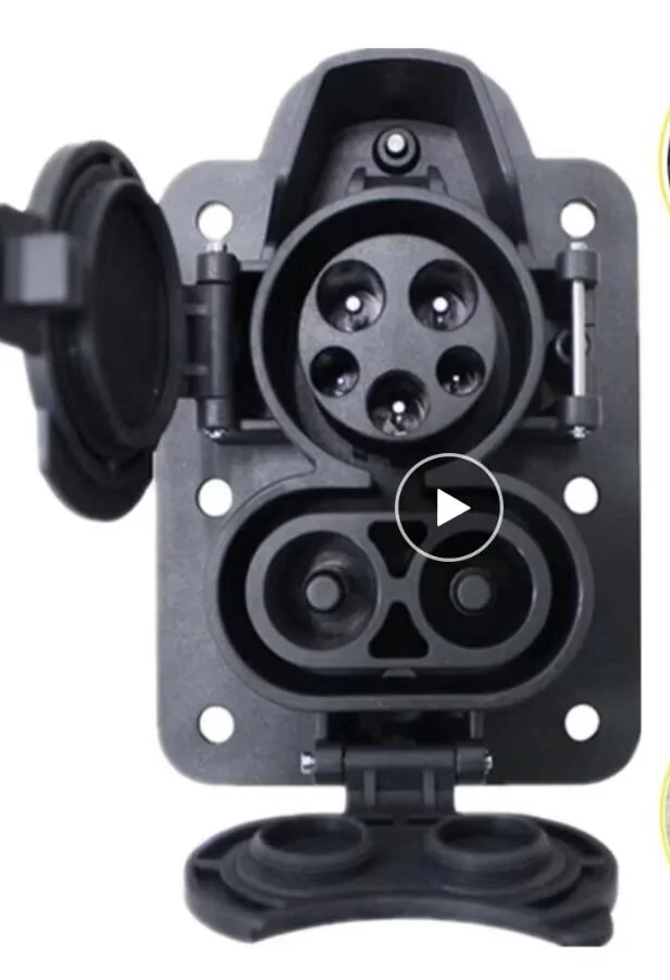

Here are the two Adapters you should consider if you own a J-1772/CCS1 EV…most all non-Tesla EV's in North America to date - but that's about to change…pic below represents the type of plug/port your EV has installed from the factory (All Taycan's and Macan's shipped to North American to date) - MY'2026 would be the first opportunity for Porsche to ship a NACS based vehicle - but so far nothing has been announced.
J-1772 (upper) + CCS1 (lower) vehicle charge port
Electric Macan EV [FAQ] - Don't overthink the NACS native port transition…because it doesn't matter Screenshot 2024-10-06 at 8.08.11 AM
Examples of the two adapters that a J-1772/CCS1 vehicle would require to use a NACS EV Charger (L1/L2/DCFast) - see below…

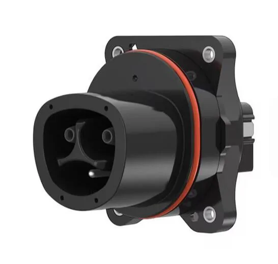

Here are the two Adapters you'll want to consider if you own a NACS EV - pic below represents the type of plug/port you EV has installed from the factory.
NACS Vehicle Chargeport - both L1/L2/DCFast
Electric Macan EV [FAQ] - Don't overthink the NACS native port transition…because it doesn't matter Screenshot 2024-10-06 at 8.10.32 AM
Examples of the two adapters that a NACS vehicle would require to use a J-1772 EV Charger (L1/L2) or CCS1 DCFast Charger - see below…
